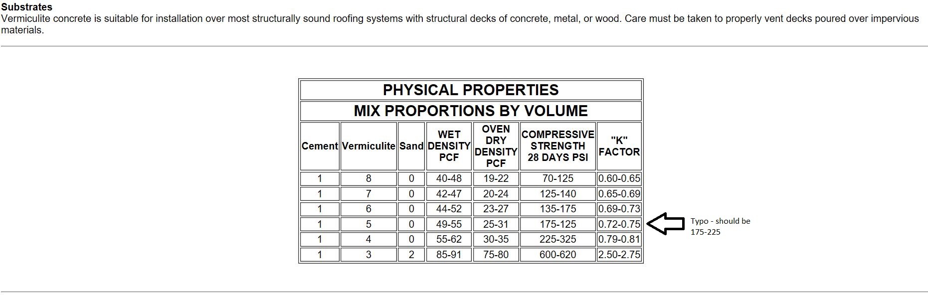

        For the dome insulation, I would go with a leaner mix for better insulation value, 8 to 10 to 1. You do not need the structural strength on the dome like you do under the floor. Back to you original question, IMHO, you would be better off with bricks under tiles rather than sand under tiles. This would provide a better platform for the tiles to sit and also give you better thermal mass. You need 5 to 1 vcrete under the floor bricks/tiles.Click image for larger version  Name:	Vcrete K values.JPG Views:	0 Size:	151.5 KB ID:	418824
