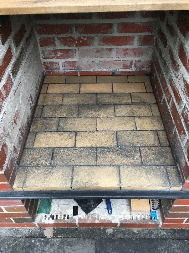

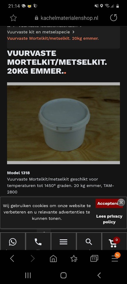

    I have finally started building a wood fired bbq/fireplace which will later include a pizza oven. I have managed to source fire bricks and they are good. The problem that I am having is the mortar. The standard dry mix fire mortar here is full of small pieces of chamot which are to large for the gaps between the bricks. I managed to get some refractory cement but was hoping more for a grey colour mortar between the bricks instead of pitch black.
    I removed the refractory cement and tried filling the void with premixed mortar with a consistency resembling toothpaste. I was super happy with the result but after a week it still wasn't hard. In fact if I rubbed over it with water it washed away. So I thought I would try heat treating it. Some of it became hard on top but not all. And a lot of it resembled dried out or burnt toothpaste.
    My question is. Can I do anything to make the refractory cement grey instead of black.
    ​black.
    Can I add anything to the pre mm ix to help it become hard (portland cement?)
    Could I have played with the premix to much which resulted in it not drying? I tried wet sanding it a few times, and their was quite a few days where it rained (although the base was always covered) could humidity have affected it?
    Would it help to place a small electric fan heater under the tarp to help drying?

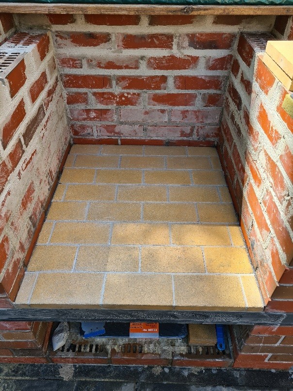

      Hi Dave,
      Thank you very much for your reply.
      Very detailed and to the point. Unfortunately it was the answer I expected. I have since removed the premix as you suggested and replaced it with the homebrew.
      I should have followed the advice on this forum first instead of the salesman's. The homebrew is great!!!
      Easy to mix and apply. Sets well and dries perfect.
      I have since finished the smoke box as well.
      I have attached an updated photo.
      Greetings James
