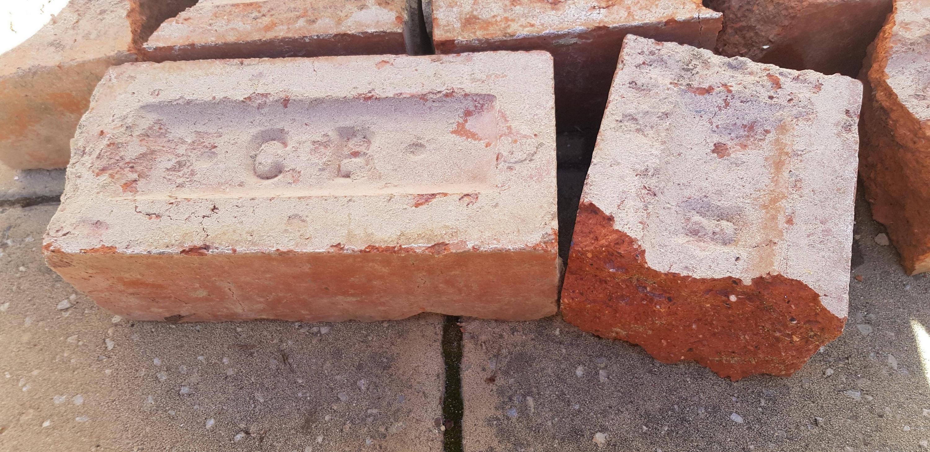

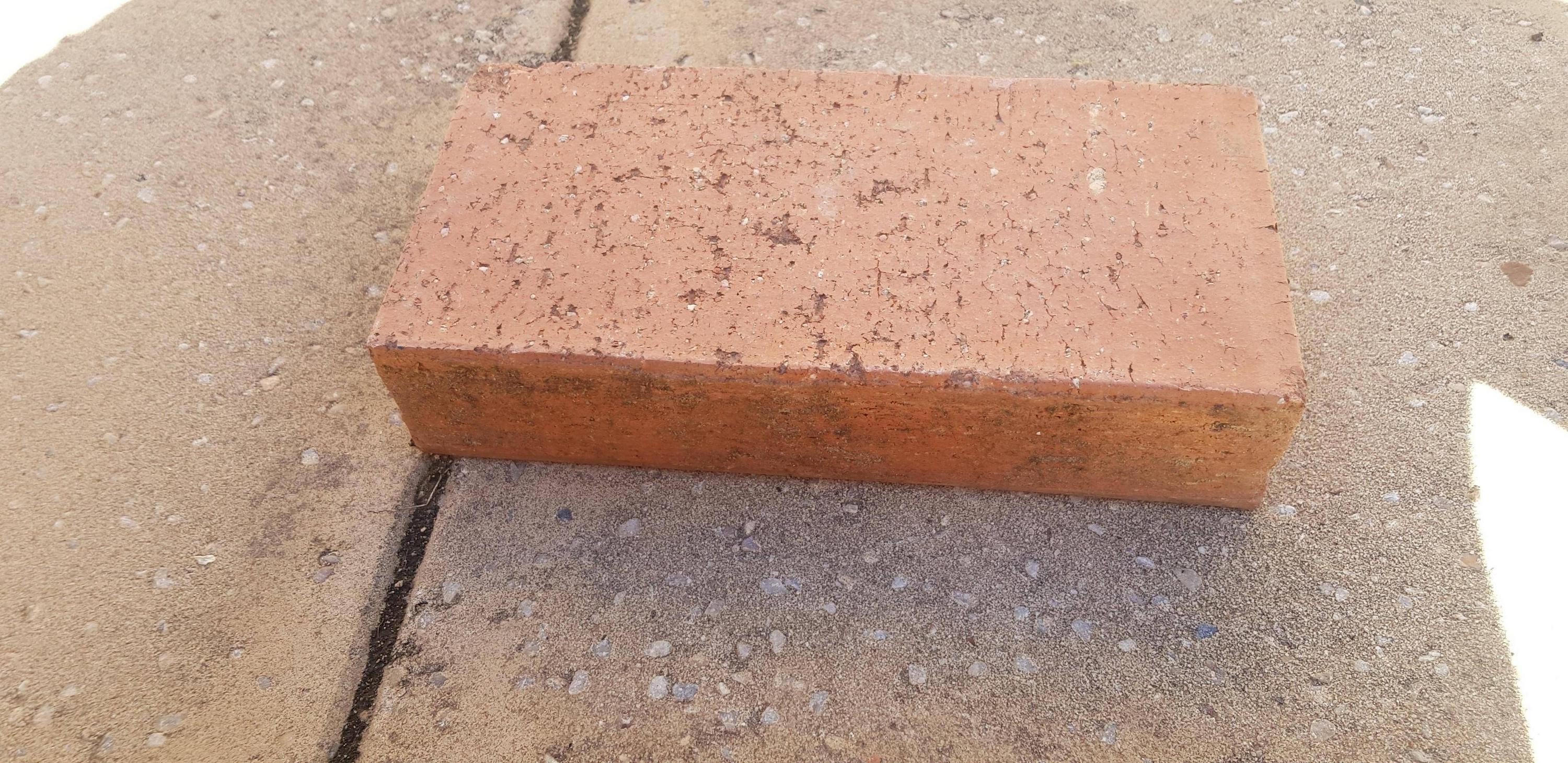

    The first pictures are brick pavers from a driveway.

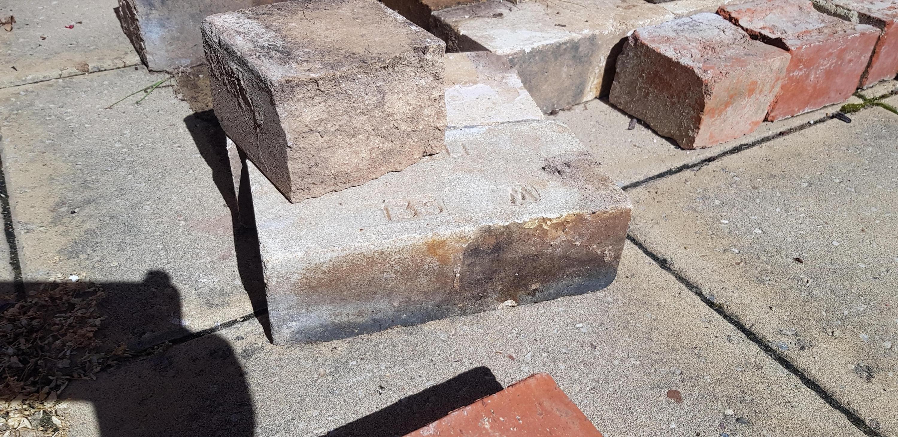

    The next brick I'm not sure, but it's printed "Bulli 135 M"

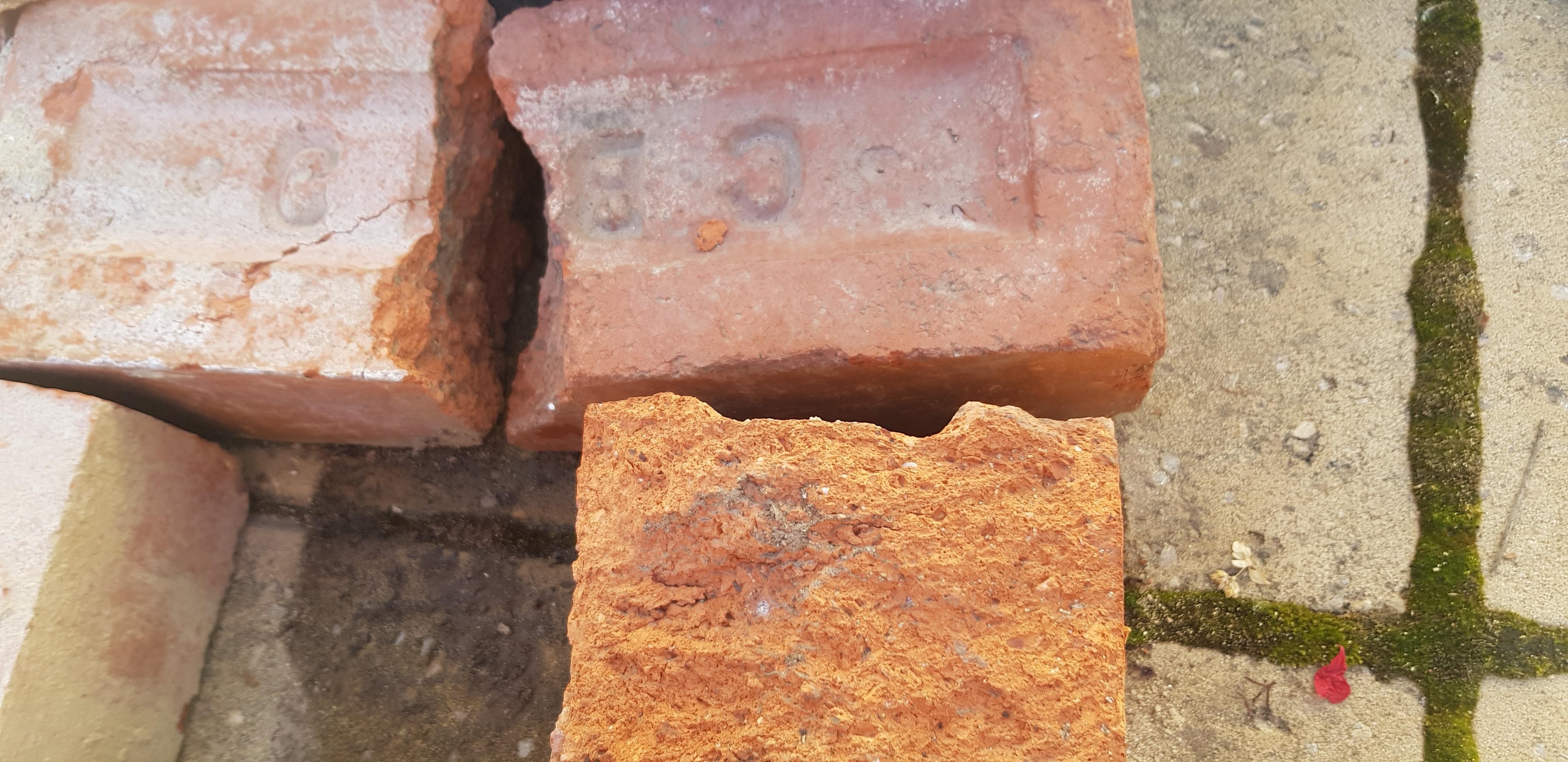

    The final pictures are what I'm pretty sure are pressed red brick (CB stands for Canberra Brick)
    I've uploaded to here what I can (discarding some that don't fit the size requirements)

    Pressed Red
    • 9215
    you'll probably get away with using pressed reds for the dome, but not for the cooking floor.
      Do you know if the first 2 bricks are pressed reds?
        • 9215
        The first pic looks like a fired clay paver which I think are extruded and wire cut. The second pic look like fire bricks and the third and fourth look likepressed red house bricks. The method they are made by has no bearing on their suitability. Neither is the temperature to which they are fired, it’s the composition of the clay body that determines their suitability and you will have no idea of this by looking at a photo, striking the brick with a hammer or hitting it with a blowtorch.
        To test whether they have been sintered ( fires in a kiln to turn the clay permanent), soak the brick and rub the surface. If it doesn’t turn to mud it’s sintered.
        Generally you need dense bricks for both the dome and the floor. The denser the brick the higher is it’s thermal conductivity, but the harder they are to cut. They should be around 2 kg/litre. A quick measure, calculate volume and then weigh the brick will give you its density.
