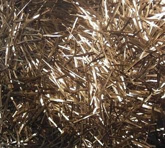

          Refractory Reinforcing 1" 430 Stainless Steel Needles
          I had a link but found out I couldn't do that so here's what they are called
          You can also do a search under this discription.
          refractory reinforcing stainless steel fiber

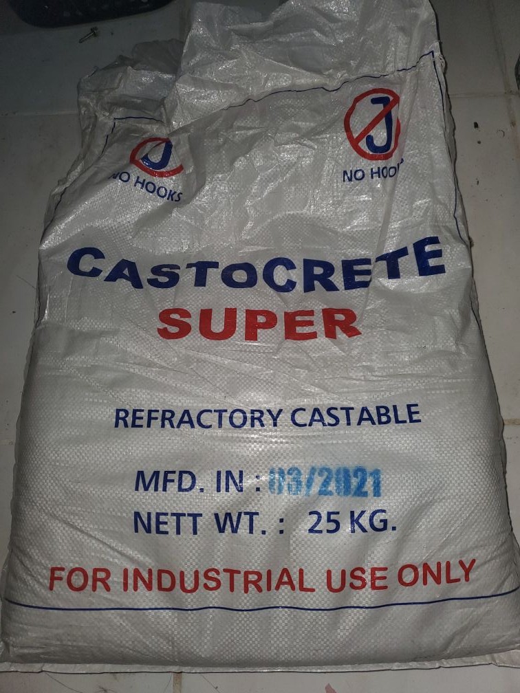

                  While I have you, if I may please ask a question regarding castable, I bought 5 sacks of "industrial use only" refractory castable, I am pretty sure it won't be enough for my dome (scope creep, but happy wife = happy life), what do you think about mixing one part 3:1:1:1 homebrew with 1 part refractory cement. I am not sure if the refractory cement has any strength or burnout fibers, I assume I should add both if after sieving I don't find any.
                  Thank you so much Dave for your thoughts,
                  Robi
                    • 9213
                    There are many types of castable refractory, but they generally belong to one of two groups, either insulating castable or dense castable. You want the dense castable rather than insulating because you are after conductivity, thermal mass and strength. A hard, dense, durable inner dome then insulated well on the outside, will give you the required strength and thermal mass. The density should be around 1800-2000 kg/m3 or (1.8kg-2.0 kg/litre) The carbon nano tube reinforcing I use is called Edencrete, a liquid admix. I believe it is the only product of this type available. I know of another manufacturer developing a graphene admix for concrete, but they have yet to develop it via a liquid admix and obtain the required approvals for its commercial use.
                    Sieve a sample of the castable to check if it contains burnout fibres, most dense castables do.
                    Regarding mixing the castable refractory with home-brew to extend it, DON'T. Because the chemically active ingredient is calcium aluminate cement, it reacts with both normal portland cement and lime as an accelerant. As the castable already has a very short pot life, it needs to be placed quickly in small quantities because it goes off fast. Anything that accelerates the process just reduces working time. During summer I always have to use chilled water with the stuff to extend the short working time. Perhaps you could lay up a thinner layer of the castable refractory and then cover it with another layer of homebrew over the top to achieve the required thickness. Most cast ovens have an inner dense dome around 2' thick, although the monster 1.6m internal diameter oven I'm currently working on is 3.5" thick.

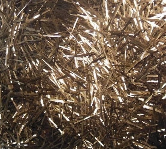

                        Have you seen this product? I have bought some, if it ever stops raining I will render my oven. They recommend 10kg per cubic metre.

                        I expected it to be brittle, but it it is flexible, but bounces back to shape. I was also wondering about splinters, but I doubt that will happen.
                          • 9213
                          They look interesting, i’ve not tried them. How long are they? Sometimes long and stiff fibres will stick out from the rendered surface. You can either pull them out before the surface has set or sand them off after.

                            I bought 12mm but they also have 30mm. They don't stick out at all.
