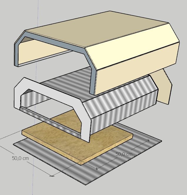

    My construction will be like this Click image for larger version

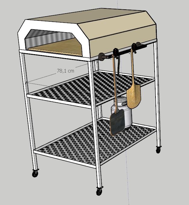

    Oven parts will be: Click image for larger version
    Between external cover and internal cover i will put ceramic blanket 5cm
    Ceramic Floor plate: 50X50cm
    Internal metal will be 316SS 4mm thickness
    External cover will be aluminium sheet 1 or 2 mm to avoid extra weight.
    I need your opinion about the metal at the bottom of the oven which i put on the floor plates.
    My first thought was to use 316SS metal 4mm but will make the total cost too high.
    So,can i use carbon steel sheet?Is it safe or not?
    Of course,i will not cook direct on the metal sheet,only on ceramic floor.So is it safe to have this metal in the same cooking area?
