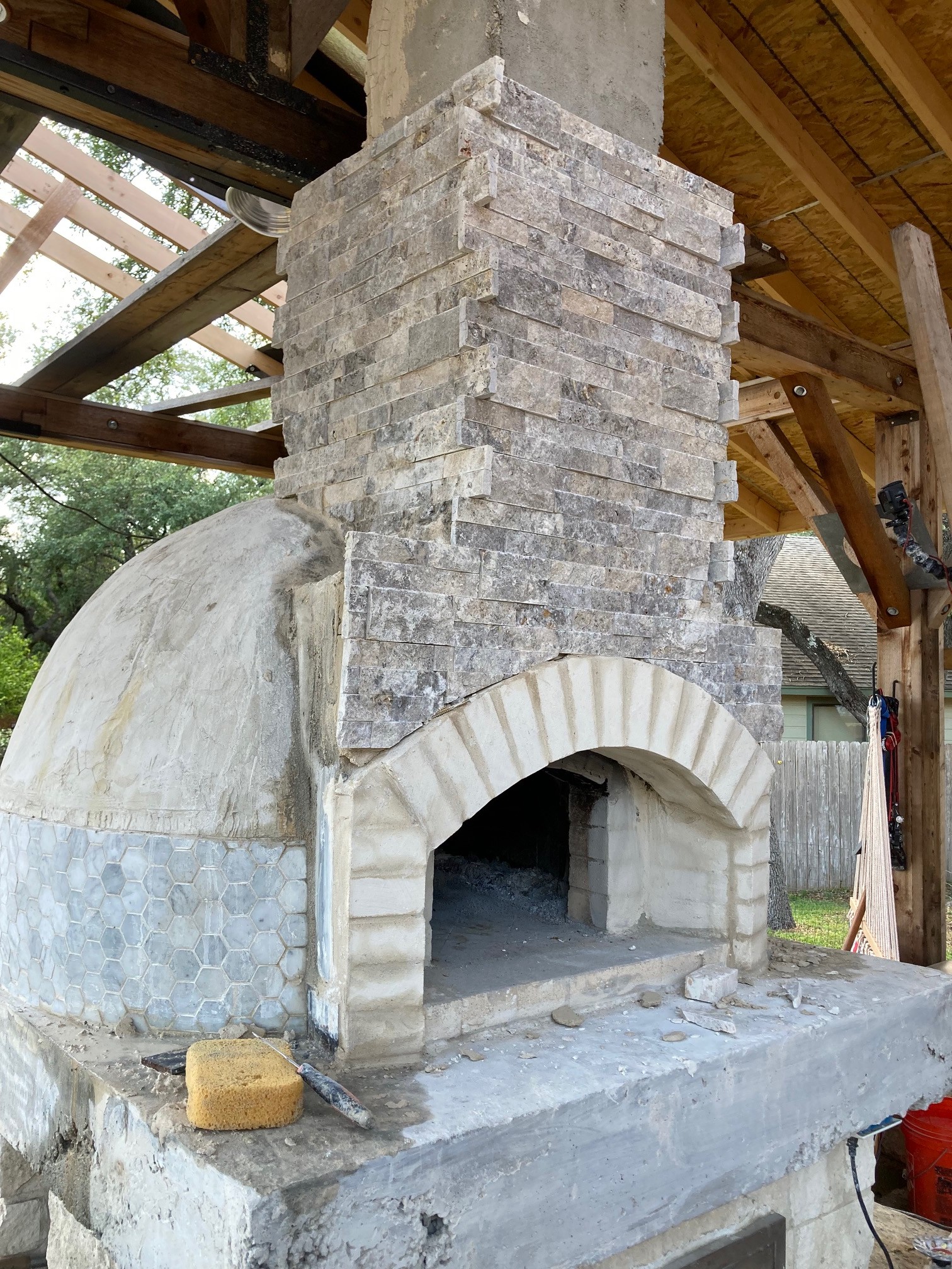

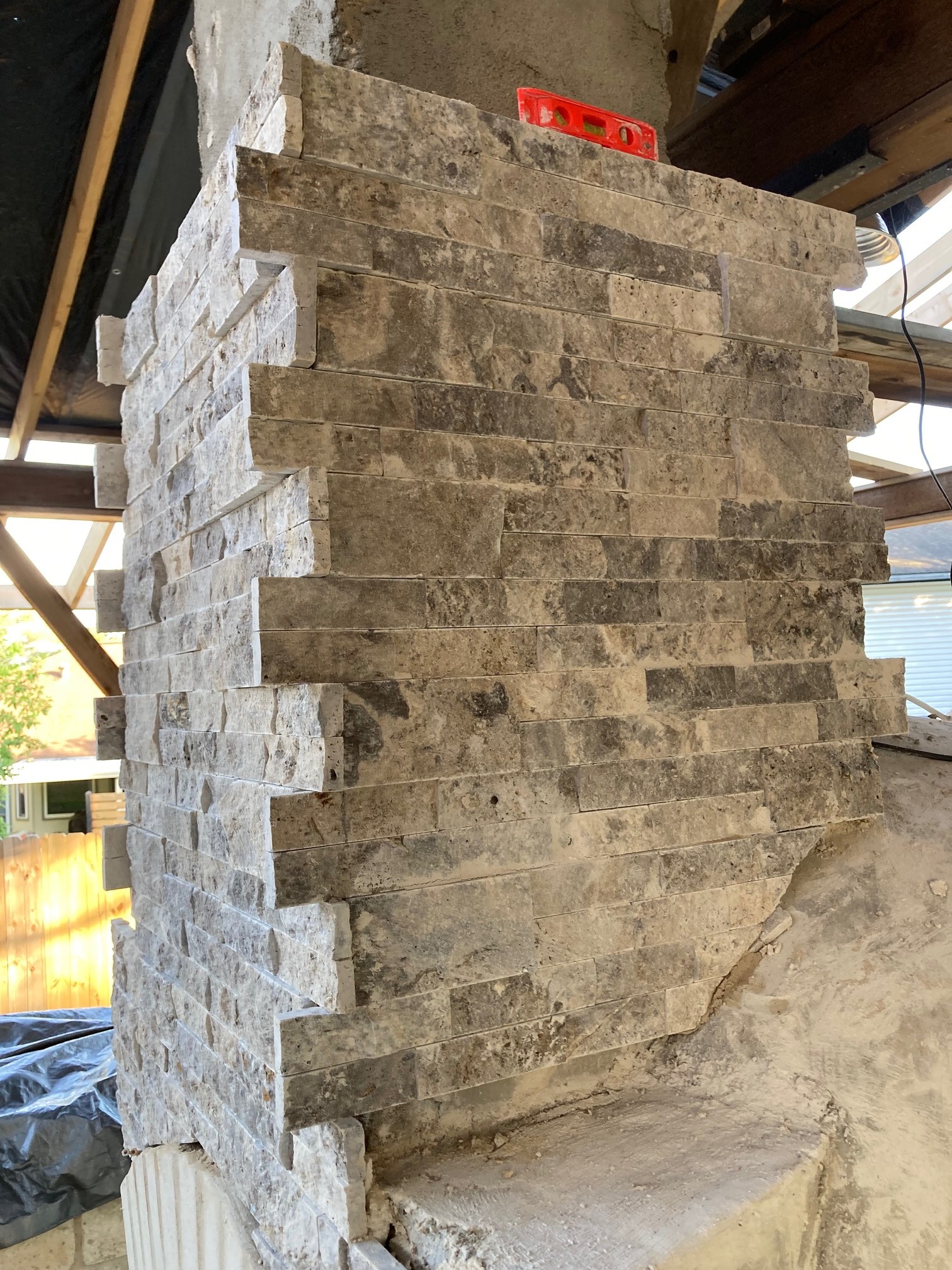

Best way to cut this stone off?
  • stevef22
    • Mar 2020
    • 131
    Hi guys, I didnt cut my stone before putting up. Now it looks funny. How do I cut these without damaging surrounding stones? I have a 4" grinder with masonary wheel... but Im worried of hitting other stones. Thank you

    I would try a hand glass/tile cutter. Do a test in the back where it will not be quite as noticeable. Score one tile front and back. Then give it a tap and see how it breaks. Good luck.

      Hmm, thank you, I will give it a try.
        Too add to that. Place a small wooden block on the tile outside of the cut. Then tap the block. That may help it break more evenly along the fault line.

          Thanks, going to try today. Will let you know!
