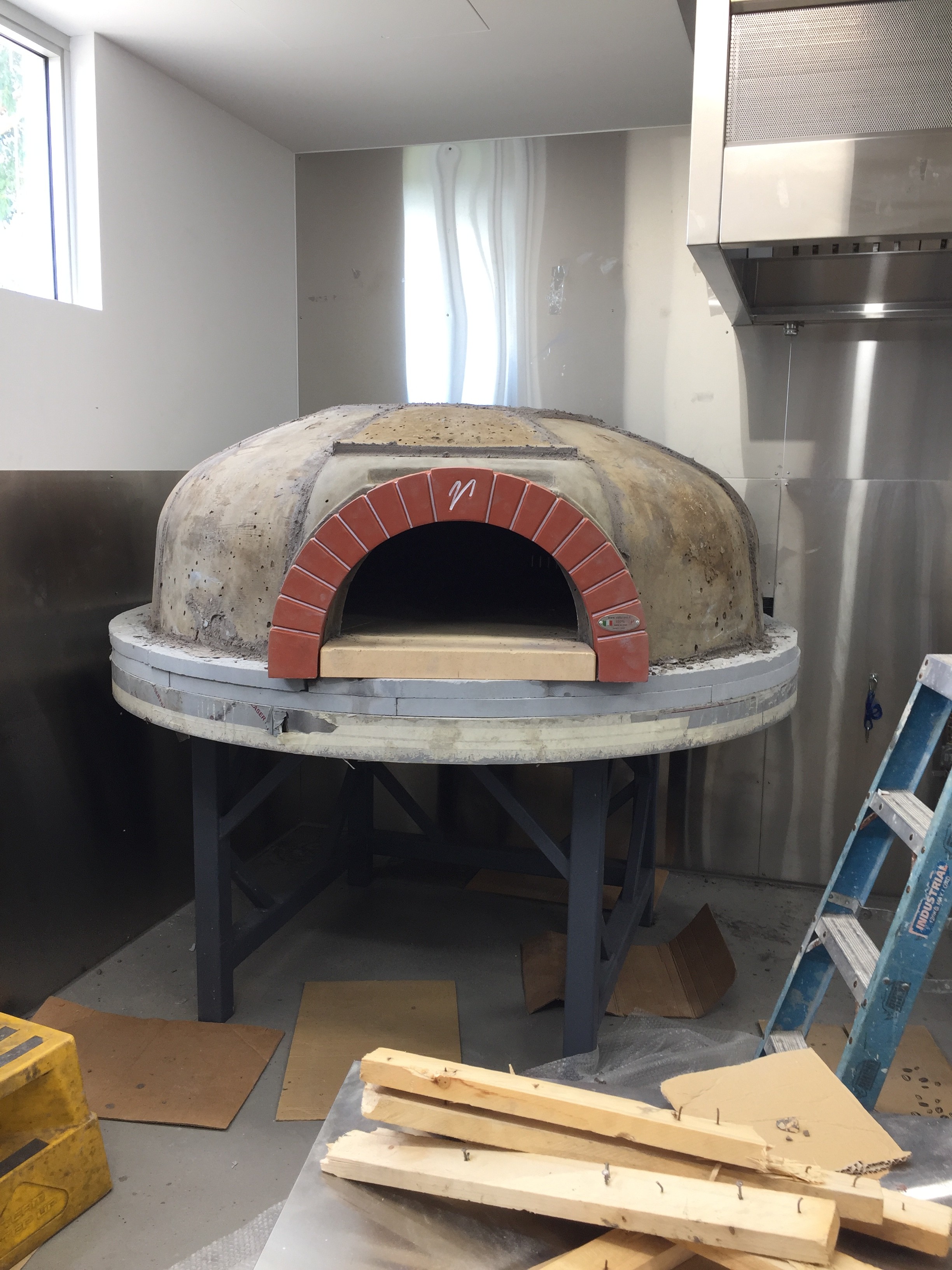

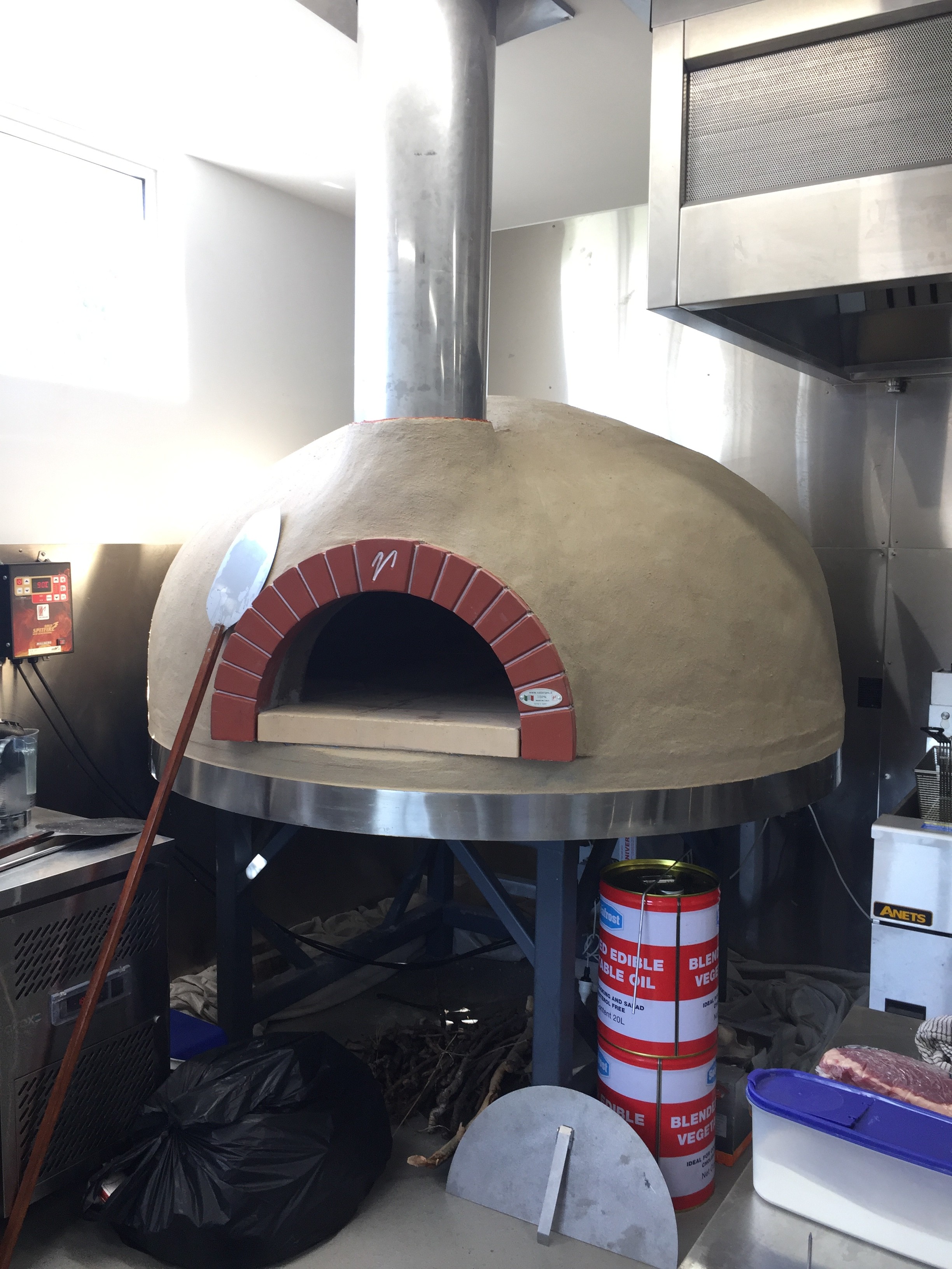

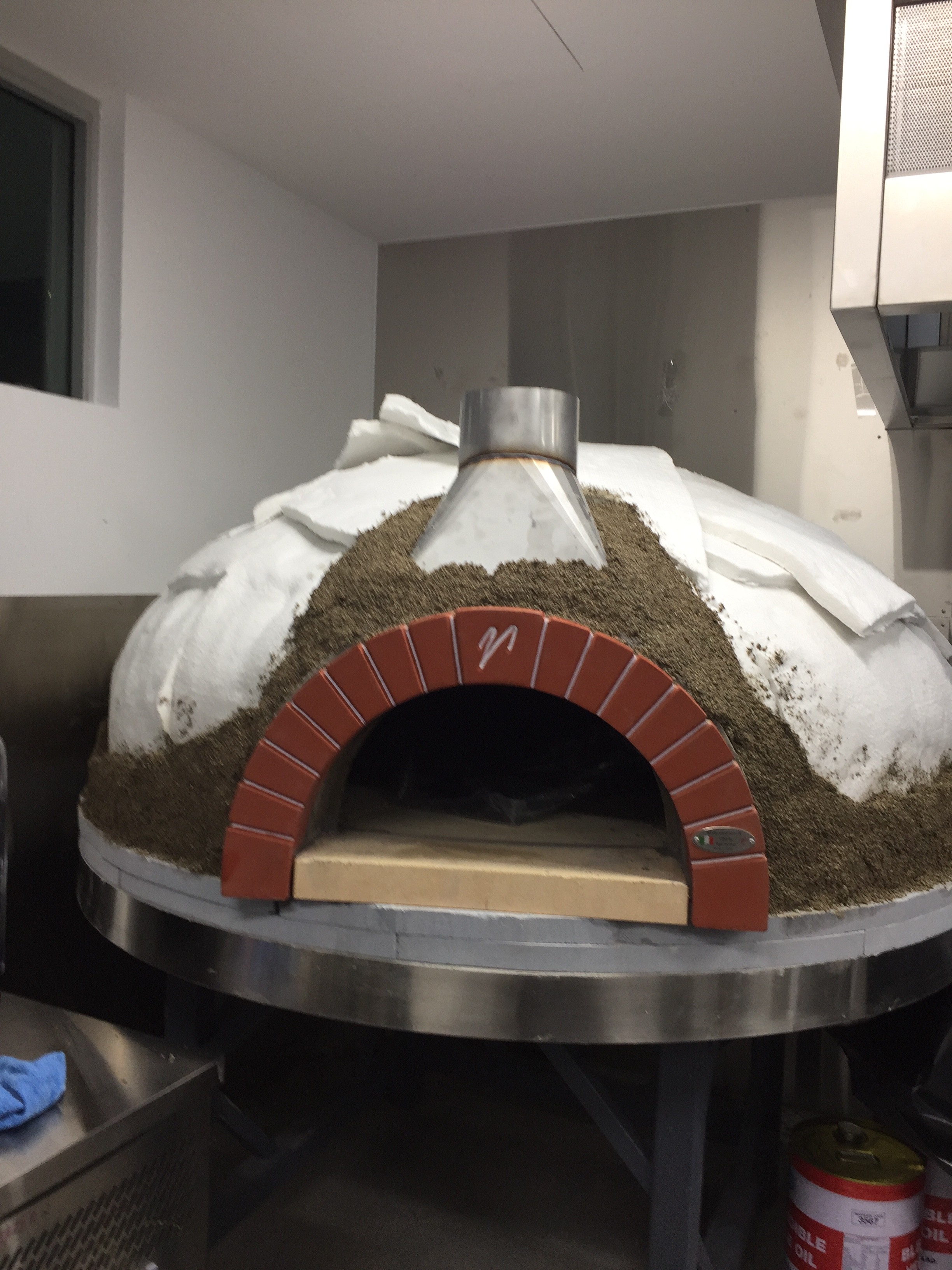

        Here's a large Valiorani oven I built which shows such a flue gallery.

          Thanks for sharing, Dave. That front arch looks like a pretty reasonable depth for access.

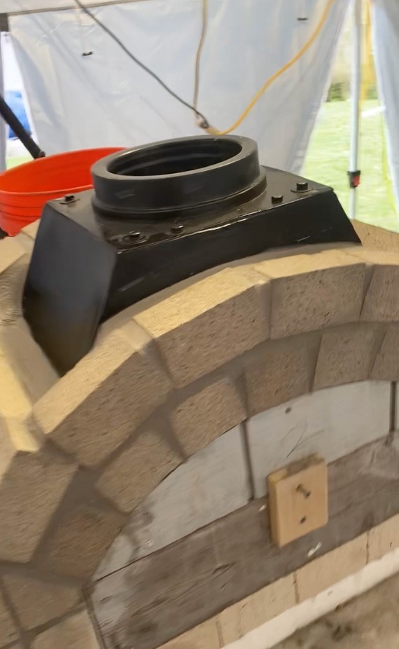

ID:	464482I went with a relatively large "flu-box" because I was a bit over worried about the smoke drawing well and not having any black or smoke streaks on the front of the arch or oven. It made for a deeper landing (by a few inches) and a fun challenge to reduce the larger opening up to the double walled 8" vent pipe. But it draws smoke awesomely. I have a good size landing, but that makes a bit harder for shorter people to reach across it as they start a fire or push pizzas around the back of the oven, but I would not do anything differently.

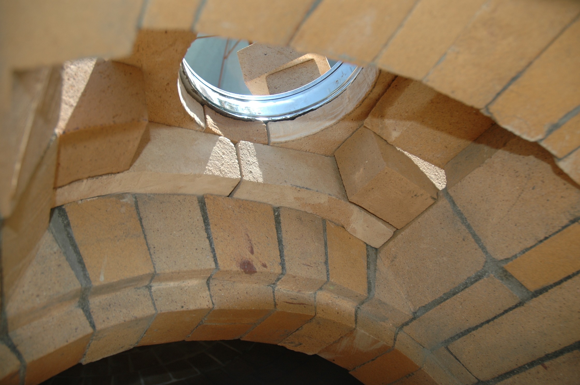

              That's fantastic...I'm glad to hear that the larger front arch and landing are worth it, since we're doing that, too. We're just finishing the front arch...not quite done, but soon:
              I built an earthen oven 25 years ago and made about 2,000 pizzas in it over 8 years with so many backyard parties. I loved that oven, but it was a vent-less downdraft design, and I'm really looking forward to having a chimney
