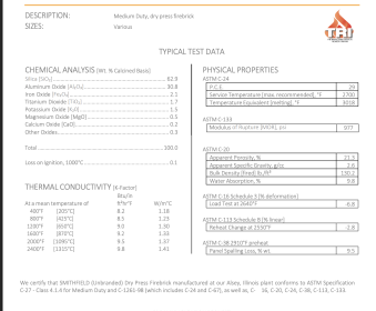

              I'm currently sourcing materials and had a question on the right type of firebrick. The Forno Bravo guide on firebrick has a grid that suggests Medium Duty, the ideal firebrick, has Aluminum Oxide content of roughly 38%. The firebrick I'm finding for purchase is called Medium Duty but the Aluminum Oxide content is usually lower, around 30. I'll attach an example here so you can see the decision I need to take:
              The first option is called Medium Duty and has Alumina content of 31; the second option is Heavy Duty with Alumina of 37. Is this really the primary driver of the decision? Does it make much a difference on the cooking surface? They are roughly the same price...
Name:	Screenshot 2025-09-09 at 9.02.48 PM.png

                2” of cal sil is adequate, but some would recommend 4.
                Medium duty are what you want. Light duty a bit too soft and high duty a bit too dense (which therefore burns the bases more easily) and are very hard to cut., wearing out expensive diamond blades faster. The Al oxide content is only one factor to consider, their density is the more important factor. Any medium duty bricks should be fine. Your stand looks terrific.

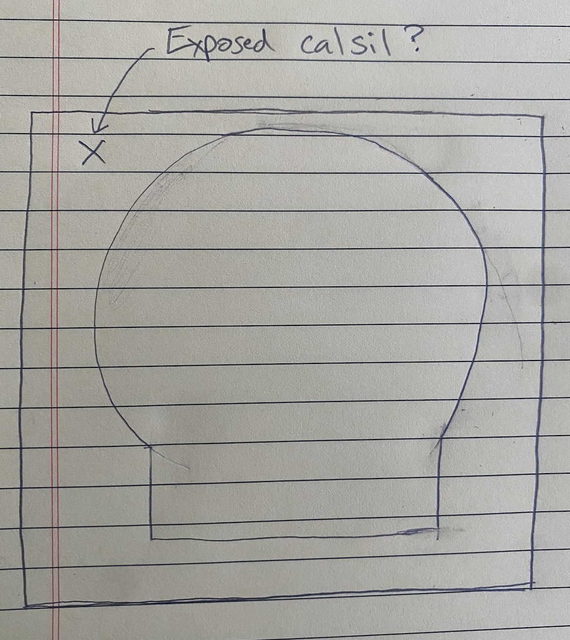

                      Thanks David. I follow what you're saying but since I haven't seen this on a prior build perhaps I haven't been clear in what I'm asking about (or I'm missing a critical element in my design).
                      Here's a rudimentary top-down in hopes of illustrating what I can't articulate!

                      Put another way: I imagined using the firebrick just for the shape of the oven to avoid excess, but hadn't considered that this would leave the top of the calsil board exposed. Are you imagining that I'm using firebricks across the entirety of the surface?​​​
                        • 9213
                        The exposed calsil will be covered and sealed by the layer of render/stucco. You have two choices with the floor bricks. Build the oven dome on top of the floor or build the dome beside the floor. There are advantages and disadvantages of each method.

                          It appears that you weren't planning on cutting the calsil board at all...just fitting it in your metal hearth base. I believe that David was just referring to an exposed perimeter of the insulation board that's normally left after trimming the board. That exposed couple inches outside the oven dome base footprint is what your top insulation batting sits on, completing the thermal insulation of the oven. In your last drawing, that exposed calsil board is really useless to the oven since there is no need of insulation. It would seem to me that you are simply needing to put in something in those corners to bring up the base level to match your oven's base or the metal tray's top edges. Ultimately, (in my old head ), you just want to create a little bit of "counter space" to set your beer or wine glass on while working a pizza. It looks like you won't have enough space or need for anything hot coming out of the oven, so even cutting some nice pieces of wood for the four corner sections would work.
                          If you still want to avoid cutting the calsil and fill your entire tray space of the stand with it, the same thing will apply. The exposed board is too "soft" to take wear & tear. So if you went with the tray fill option, after your oven has been built/insulated - as you realized you'd still want to cover those outside corners with something more durable (wood, stone, tile, pennies , etc.)
                          I hope this makes sense and it does mesh with what David was been saying...I just think a little misunderstanding on your question - which your drawing showed nicely. Your base frame looks great (I do assume those are gaps in the base that will allow any possible moisture to escape out the bottom tray). Looking forward to your build!​​​​​​
