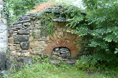

                  Whilst looking I found an old barn for sale in Ste Orse with a bread oven (which doesn't look like it's been used for a while!)...

                      A second look at the photo you attached.... the arch over the entrance is made with Roman bricks. I wonder how old the oven is and whether it was made with recycled materials at the time of it's construction or perhaps actually dates to a time the Romans occupied the region.
                      Wiley
