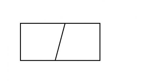

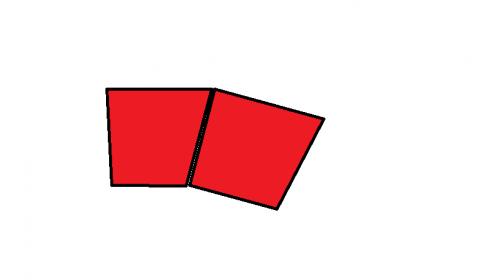

ID:	280839I don't know how many of your bricks you have cut at this point, but if you just do one cut at an angle instead of straight thru the middle, you can flip one of the bricks and they make a pretty tight joint. you will use a few more brick but a lot less mortar and it is still only one cut per brick.
            WCD

                WCD - thanks for the tip.. Aactually, that looks a stroke of genius.
                Is it generally for the higher layers. or anything above the soldier course?
                If on the lower courses, dosen't it look a bit odd, one thicker, one thinner? or is the angle of the cut so shallow as to not really show.
                What sort of angle are we talking about for a 36 inch build? Firebricks arriving tomorrow!
