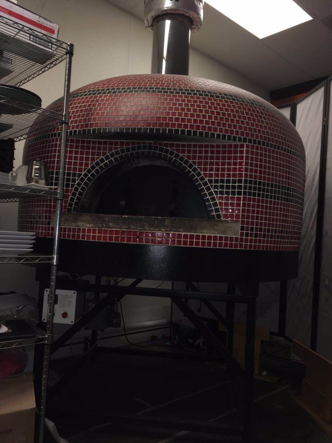

    Hi, I have to move this Forno Bravo oven--does anybody know how much it weighs? dimensions? and suggestions or precautions on moving/crating for freight shipment? Any help is appreciated! thank you

        ACP I cant tell what size Napoli is in the photo but I have attached the dimension sheet for both sizes Including the oven weight listed on each in the left hand side on the first page. You will also want to make sure the forklift you use has at least 6 foot forks . I would also advise to NOT ship the oven on the stand as it is extremely top heavy and will most likely tip over during shipment.
