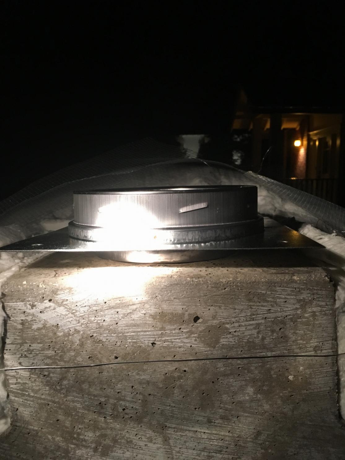

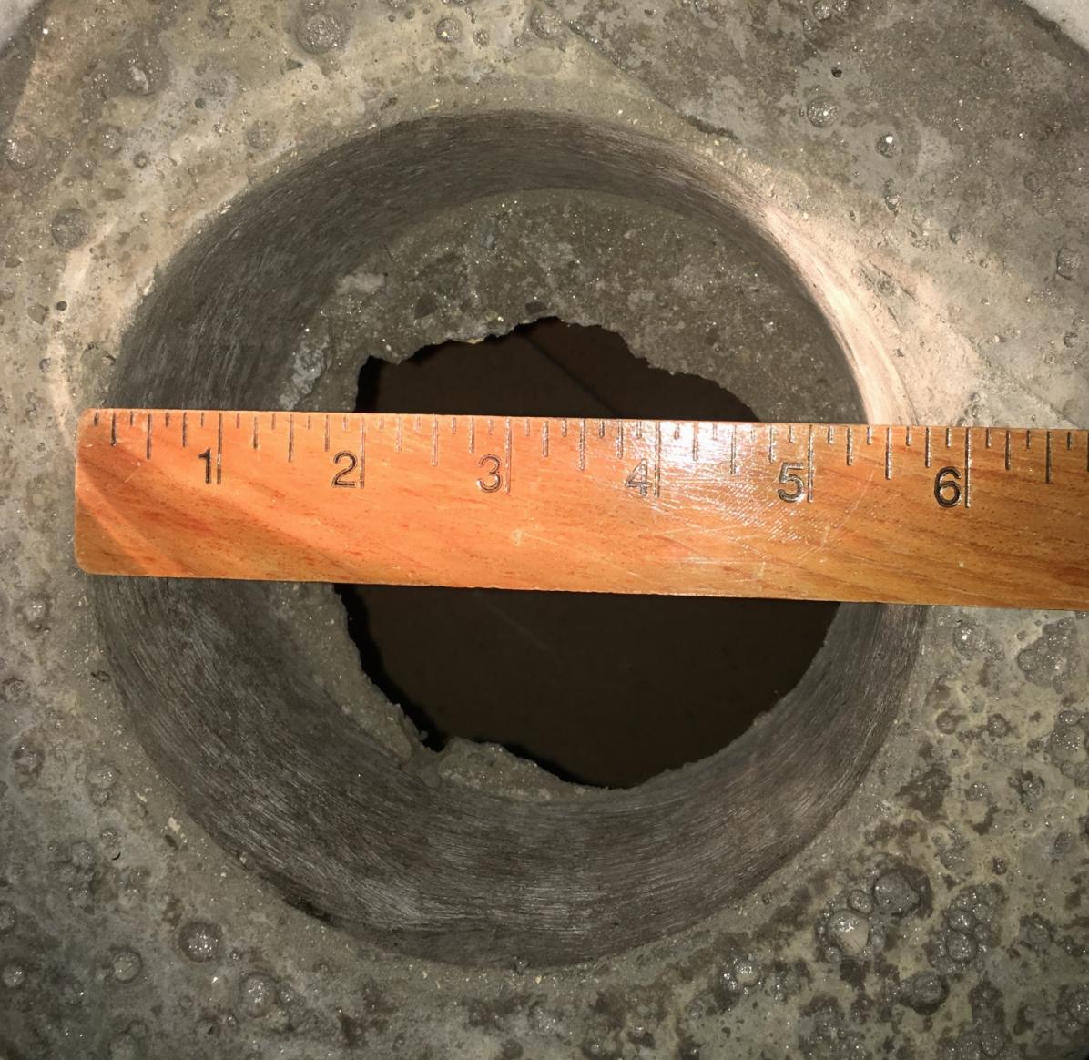

    My Casa2g80 vent measures about 5 7/8 inches instead of 6 inches so of course pipes supplied don't fit. All specs say it should be 6". Am I missing something obvious here or is this is a serious problem?

      What are you trying to mate to, the anchor plate? I believe there are two different "sides" to the anchor plate, one is a crimped connection is for single wall pipe that I think comes with the Casa kits, A the other is a threaded connections which is typically for double wall pipe. Attached is a pic of the single/double wall connections of a Selkirk anchor plate but I believe DuraVent is the same.configuration.

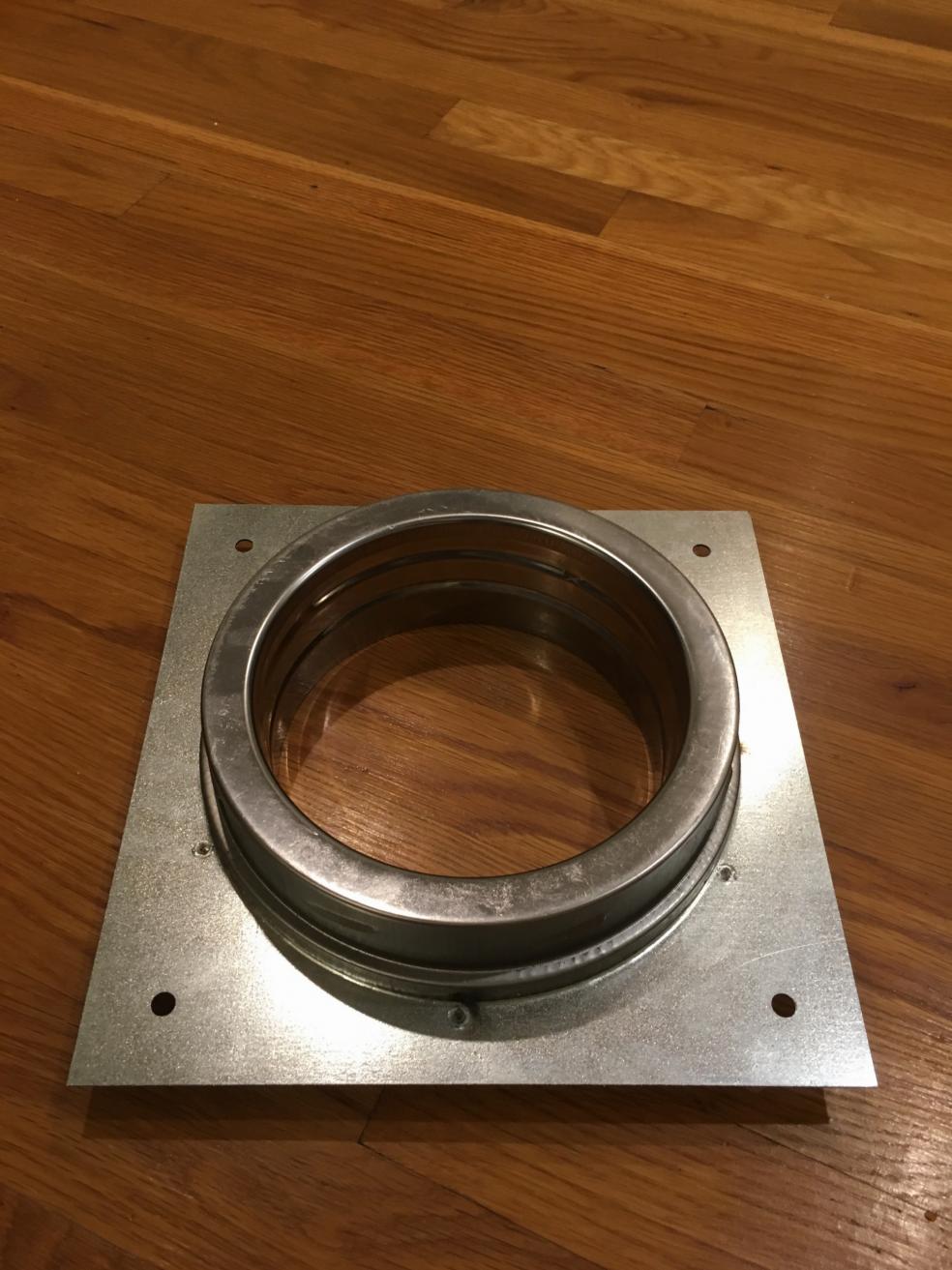

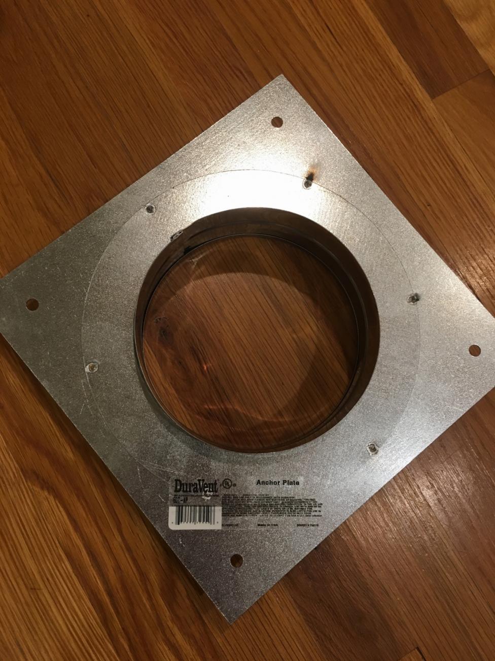

            It's a DuraTech #6DT-AP double wall anchor plate. Small part (which is 6") should fit in the vent.

              I see what you are talking about. You can call FB customer support but I suspect a small cone grinder on a angle grinder or drill will knock off enough to let the adapter plate slide in for a 1/2" or so. Good luck.
