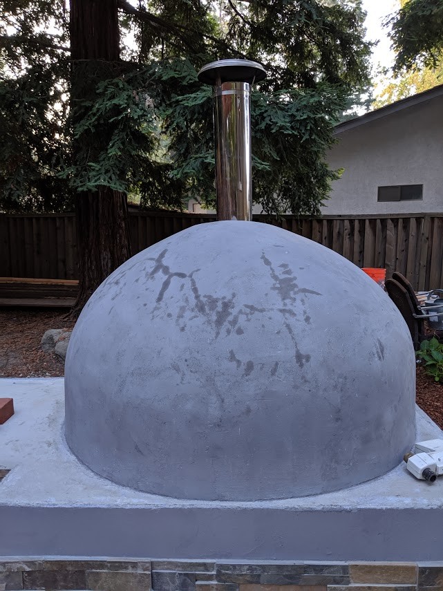

      HI Gulf,
      thank you for your response. I ended up using the insulating layer based on your suggestion and the dome ended up being fairly spherical
      thank you for your help
