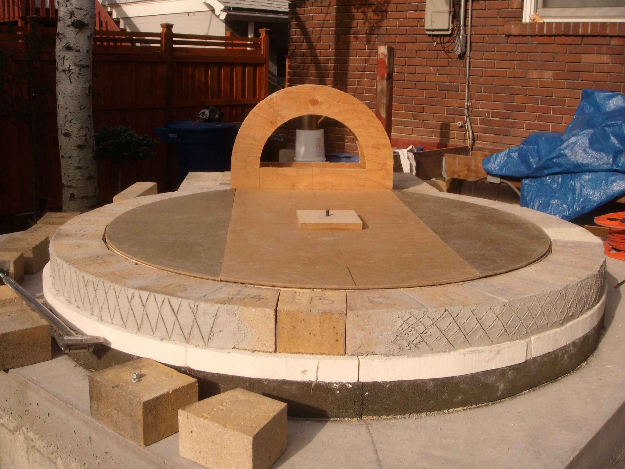

              UtahBeehiver - When you said earlier that none of the oven sits on the hearth, I'm assuming you are referring to the firebrick oven floor, but the firebrick sentinels (first layer) would sit on the concrete hearth... is that right? Also, I see that FB Board is sold in 24" x 36" x 2" boards. They say they sell 3 boards for the 36" Pompeii oven, but if the internal diameter is 36", wouldn't 2 boards be sufficient?

ID:	466931 No, none of the oven walls or floor should be in contact with the concrete hearth or you wind up with heat sink from the concrete hearth. You need to calculated the oven OD, IE 36" ID, 4.5" x 2" = 9" so min oven OD is 45" not accounting for dome insulation, stucco and final coating. I doubt two CaSi boards will be enough. You can check locally at any refractory suppliers for CaSi board, needs to have about 70 PSI compression strength at 5% deflection. ThermoGold 1200 is and an example.

                    UtahBeehiver - In your photo, it looks like you have something between your FB Board and your concrete slab. I've been wondering about this because I'm concerned that someday water will find its way into my structure and damage the FB board. If I could elevate the FB board above the slab, that could be a solution. Do you have another suggestion for keeping the FB Board dry in case of a leak in the roof of the enclosure?
                      FoamGlas, aerated glass made by Dow and is water proof and good thermal K value. It is difficult to find. If you look at recent builds, the latest trend is to make sure you have weep holes in the hearth, then a layer of cheap ceramic tile that raises the CaSi board off the hearth and give errant water a way to egress through the weep holes. I suggest you look at the builds in the Newbie Section under Treasure Archives, they are some of the more documented builds and you will find most answers there.
