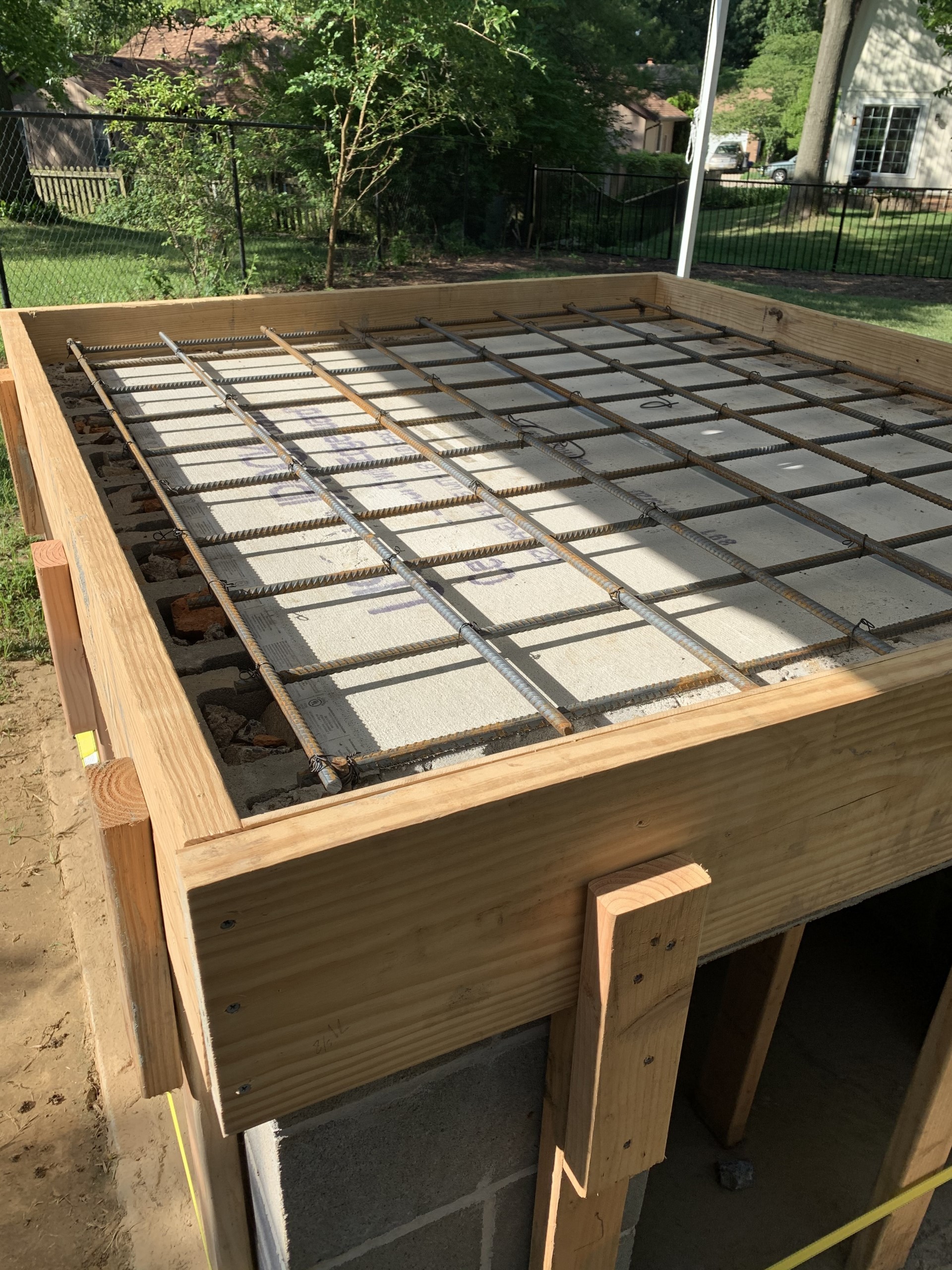

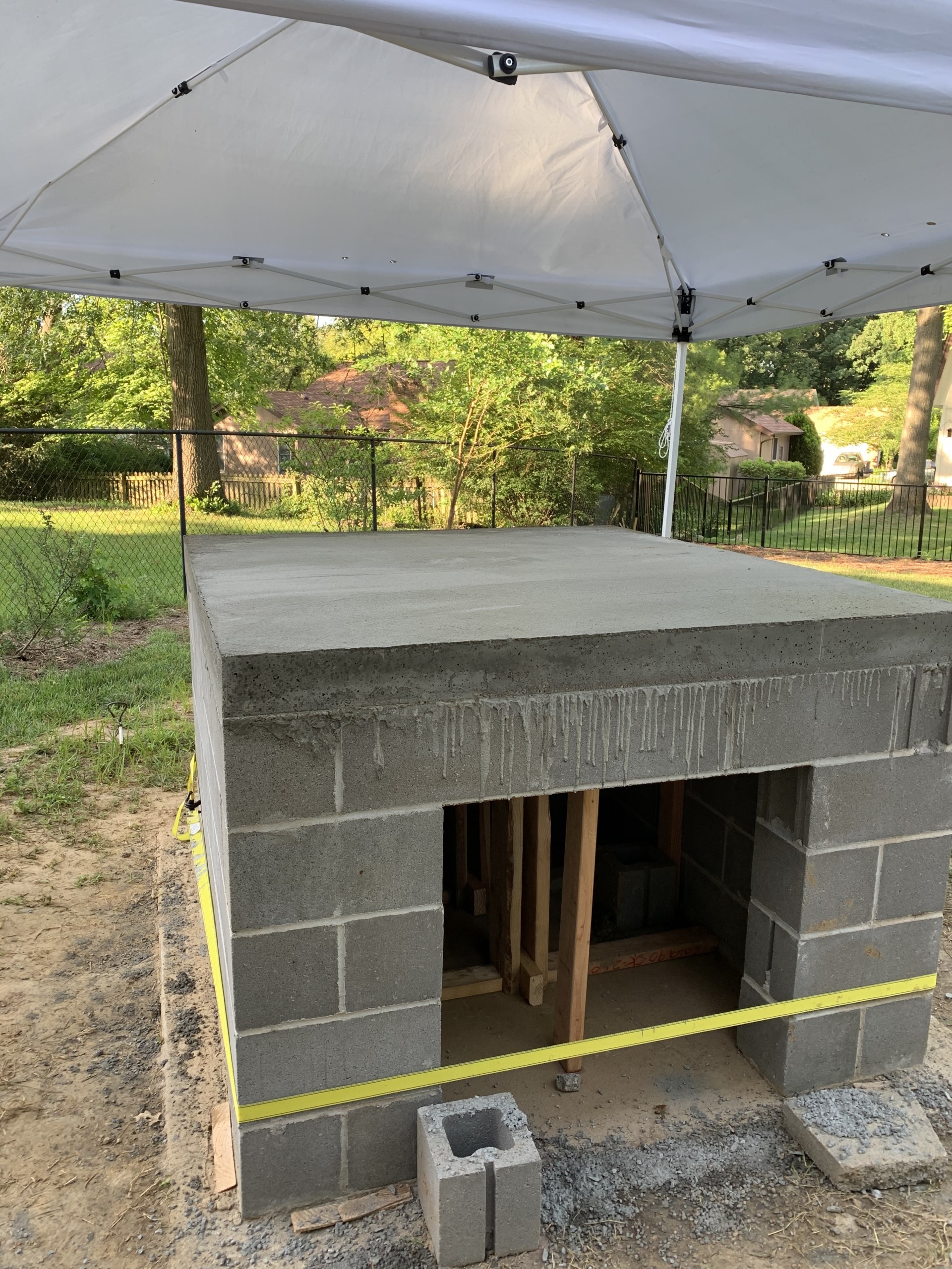

    Received my Casa2g90 last week and finished up the base for the oven this past weekend (included some photos). Excited to start constructing the oven. Wanted to share my plans to see if the Forno Bravo gurus see any glaring issues.
    1. Lay out the oven floor tiles where the oven will sit and trace around it. Remove the oven floor tiles.
    2. Drill 3 or 4 weep holes down through the concrete slab within the outlined oven floor.
    3. Position the FOAMGLAS on the concrete slab (originally I was going to have small tiles underneath the foamglas, but I was advised this wasn't needed)
    4. Place the ceramic fiber board on top of the FOAMGLAS.
    5. (add aluminum foil on top of the ceramic fiber board?)
    6. Add thin layer of sand on top of ceramic fiber board
    7. Set oven floor on top of sand and ensure it's level.
    8. Set dome pieces on ceramic fiber board surrounding oven floor.
    9. Apply refractory mortar to the out side of dome only.

    Base was done nicely. Comments, 5. What is the purpose of the aluminum foil? 6. Should be a mix of 50/50 clay/sand and only if needed for leveling.

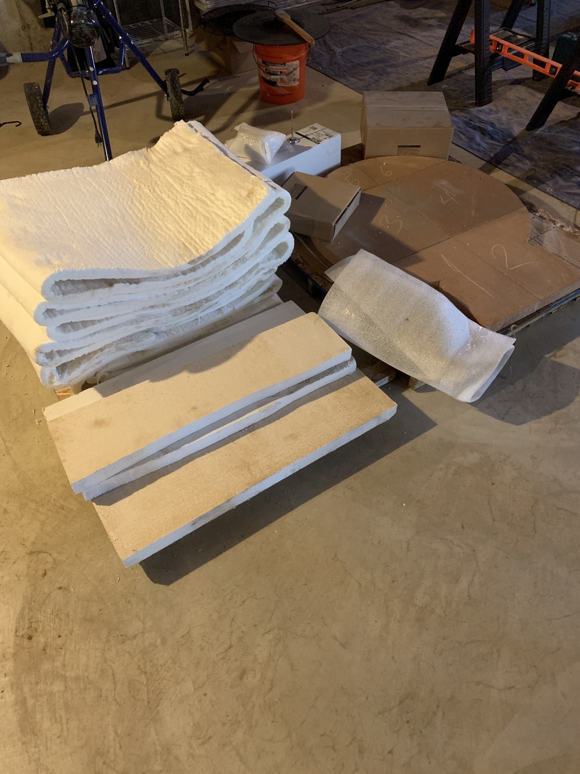

      In one of my photos I show a picture of the Ceramic Fiber board that I received in the crate. It was not cut very precisely, do you see this being an issue when trying to create the pieces to fit under the oven? Is this how others have received their ceramic fiber board?
        I am not sure who recommended aluminum foil as a water barrier but it goes both ways, if water gets in, and it will it, also acts as a barrier for letting water egress out. I can't say how other receive the floor insulation. What is the issue you are concerned about? Are you enclosing the oven with a structure, if so just leave proud. If not you probably need to precut board from a cardboard template.
