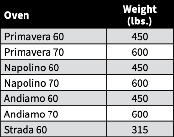

    NAPOLINO 70, actual weight
    I'm in the planning stage of replacing our patio earthen oven with a NAPOLINO 70 on our screened in porch. The porch is build like a tank with 2x12s, but I would like to get hard numbers on what the NAPOLINO 70 actually weighs. This seems like it should be easy, but the documents on the site are riddled with obvious inconsistencies....
    In this installation PDF the weight is listed as 600lbs and suggests that 5 people can move it on 2x4s.
    In the data sheet there are thee mentions of weight. They quote the crated weight at 1300lbs +-100lbs. In the oven with stand 1105 lbs. Then later in the section without the stand they say oven and stand weight 1320 lbs.... not sure why they say stand too. I contacted support and there didn't seem to be any lot of interest in high accuracy. I was told the drawing were accurate, but the odd wording around the stand, no-stand and the radically different install guide has left me wondering if anyone had more info.
    Thanks!

        Hello pizza4life and damiano - I help maintain the forum but I can shed some light on this. Firstly, thank you for pointing out those issues - I'll let the team know to get those updated in both the manual and drawings you referenced.
        Because the ovens are handcrafted, there is some natural variance in weight. The Napolino70 with Stand is approximately 1,105 lbs (±100 lbs), while the countertop version is slightly heavier at about 1,320 lbs (±100 lbs), since it uses a concrete slab for the base rather than a metal ring.
        I'll also chat with the sales lead to ensure the team is up to speed and clear when responding to customers.
