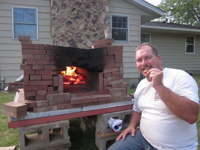

We were able to fashion a crude door.
We lit our first fire and started feeding it!

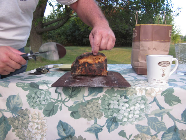

It was VERY sooty on the bottom... lesson learned. We ate the whole thing though... cooked in about 30-45 seconds (I guess I could watch the video and determine from there).

All in all, very happy! From start to first pizza.. 4 hours!!

When your oven roof and/or arch collapses, we'll help you to the next level, which will involve some cheap insulation, and some temporary mortar made from sand and fireclay.
We'll also try to talk you into making it a round dome.
If nothing else, some insulation under that floor will keep those portland concrete pavers from getting hot enough to fail.
In all, though, an amazing project for 4 hours.
Re: building the oven
It doesn't seem like the roof will hold much, but it's quite sturdy. I do have some sand that I contemplated brushing into the joints for 'sealing' and somewhat better structural strength (minimally I know). You can't see it but I do have some insulation board under the brick (so there is the pavers, then a layer of brick, then insulation board, then another layer of brick which is the cooking surface,). With all that said, I do expect at some time it'll collapse, but that's that is the beauty... I could re-build very easily. A future pompeii is in my head. This was fast gratification.Last edited by Tman1; 09-06-2010, 11:30 AM.My oven (for now):

After about 2 "sane firings", I stuff the oven full of wood, and lit it. I had to wait 4 hours before the temperature came down enough to do anything except incinerate my pizza and remove the hair on my knuckles. Hot enough? Ever see a lump of dough turn black in about 30 seconds?
