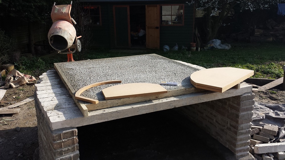

Name:	base and vermicrete.jpg
    Built the base from a stash of block paving I had.
    Used a rack 100.x 65 x 1,8m lintels and topped off with a 2" layer of vermecrete.
    3" of Calsil board laid on this and a dome of sand and bricks built for the form.
    Used a plywood/MDF form for the archway.

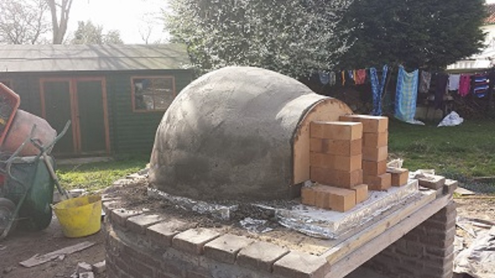

Name:	sand dome complete 2.jpg
    Form was then coated with newspaper - this was a pain since the wind kept blowing it away, no matter how wet the newspaper was. Eventually I held one sheet in place and stuck the next sheet to it using PVA glue. Worked around the form "wallpapering" it like this and that worked just fine.
    A 4" thick layer of refractory castable (1400) was then applied and patted into place. The sand dome had been kept moist and was reinforced with bricks inside so it could put up with a good slapping!
    Mixing one bag at a time and putting down layers of castable, 4" wide and about 1" thick. Working round the dome for each "course" so I could keep an eye on the thickness as I progressed to the top.
    I'm not a builder, or a plasterer, so quite proud of the result.

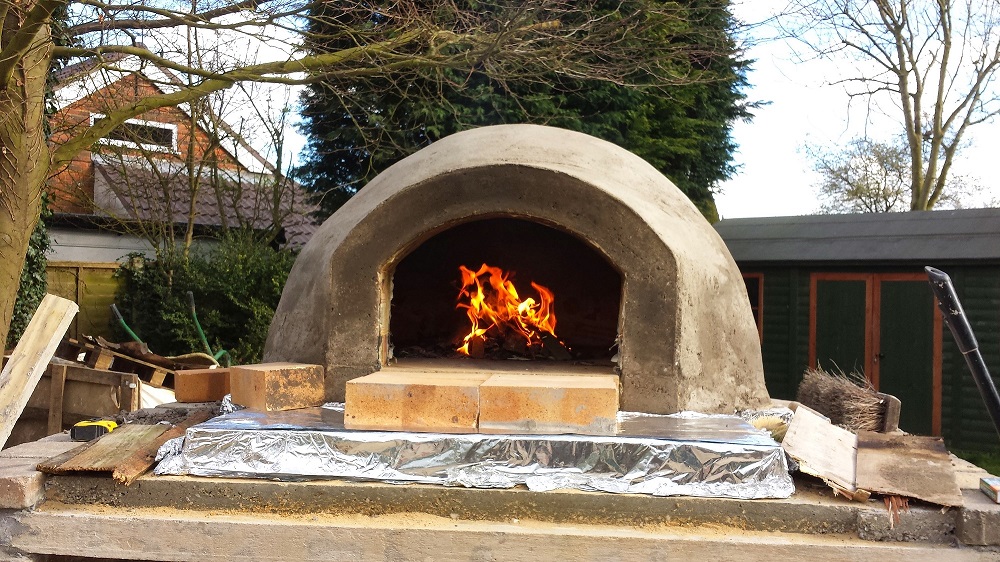

Name:	WFO first firing.jpg
    Curing fires in progress - verry satisfying. No cracks on the first two, but managed to get a couple of hairline cracks on the third. I could see the steam coming out.
    A touch disappointed, but from what I've read - these cracks should not be a problem.
    I'm a novice who's made a 4" thick single casting from refractory concrete - reckon I would be very lucky to miss out on any cracks.
    Still working on a wooden form for the flue arch.
    Looking at a sunny day today with poor weather for the rest of the week, so I plan to cover the main dome with 2" insulation and 2"vermecrete today.
