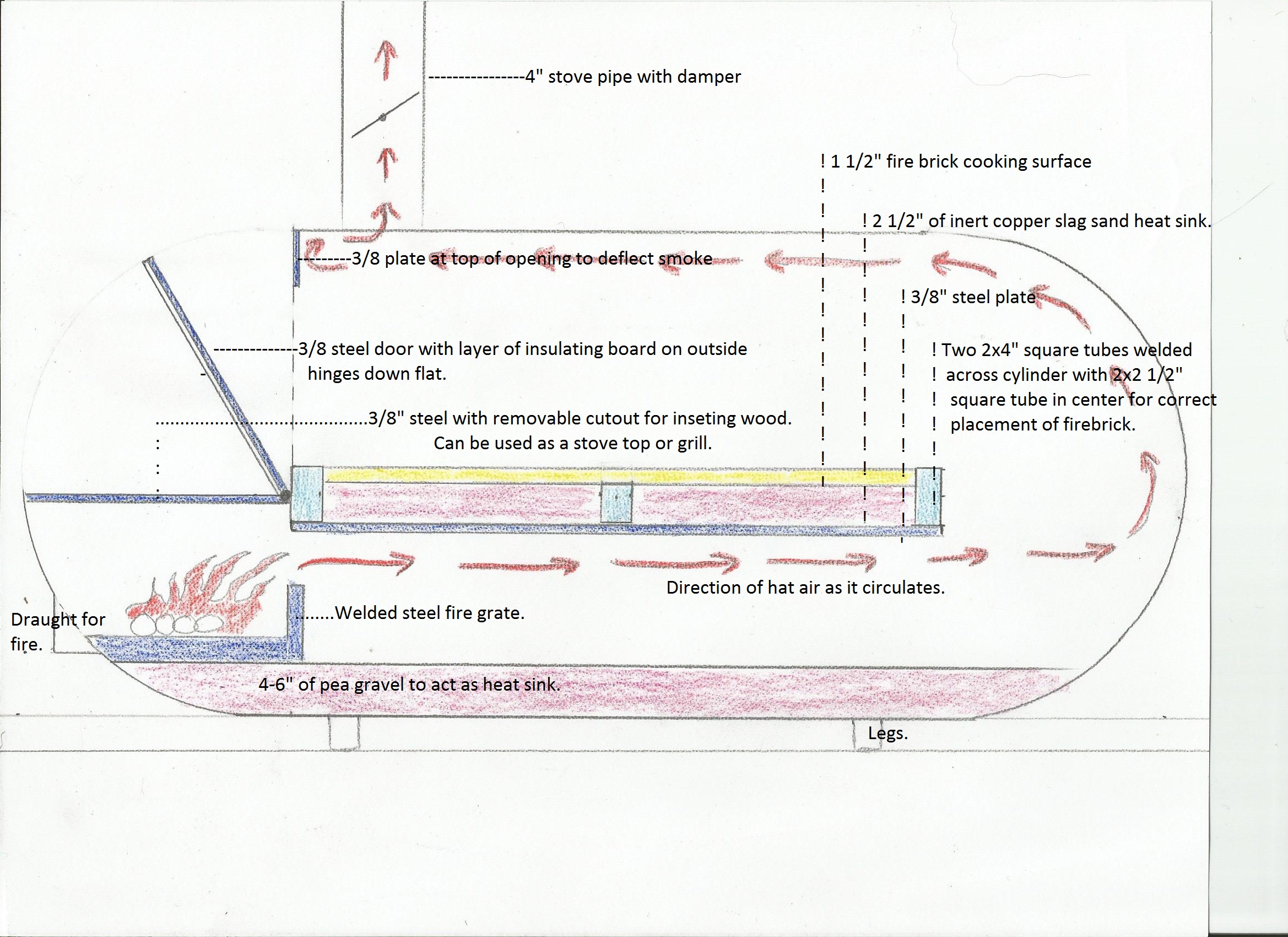

    My plan for a steel oven and stove top.
    I have had this old propane tank for a while now , with plans of making a cooktop/oven out of it.
    I traded 4 quarts of honey for it , it is very heavy steel and was made in 1947.
    Attached are some photos and a basic plan of how it will work (hopefully).

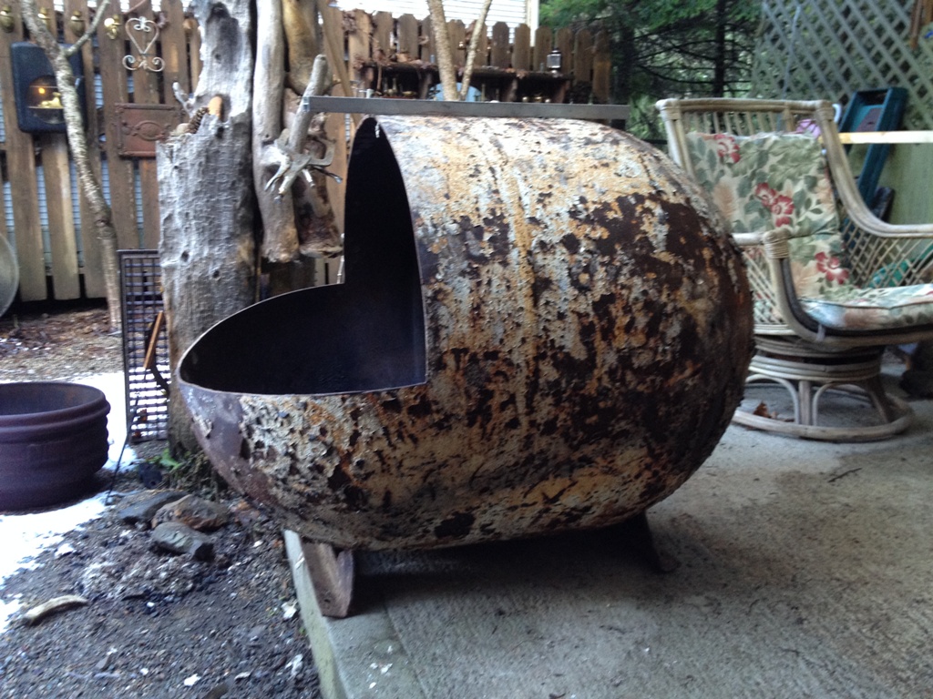

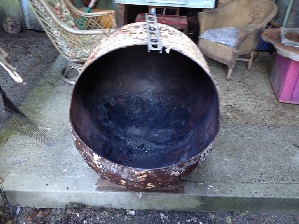

    I have just made the first cutout and had a huge fire in it to burn out all the crud from years of propane , and burned the paint off the outside.
    I hope the attachments work.
    I am currently considering a few different ways of insulating the outside , once I have it up and running.
    It is 31" in diameter , so the actual inside cooking surface will be about 18"x 31" which should be big enough for me since I will also have the outside stovetop/grill as well.
    The fire can be kept going while cooking and it will have hooks and removable racks inside so that it can be used as a cooker/smoker as well.

    Re: My plan for a steel oven and stove top.
    So , just wanted to update this post if anyone is interested.
    I have the basic oven up and running and will do the finishing touches , cover with stone veneer and replace current chimney with a straight up vertical one in the spring , when I put new roofing on the patio.
    For now , the oven is complete , 2 1/2" thick bricks were used for the cooking surface area , and act as a heat sink as well (so I omitted the sand layer) , the door is on , the steel cage is built around it and insulated with rock wool.
    I added another air intake up front just under the stove top area , wood is fed in thru the removable stove burners.
    It takes about 2 hours to get hot and holds that temp for about twelve hours , but I can keep a small fire going in the bottom while I am cooking if I choose.
    I also installed a baffle plate at the rear to keep direct flames from burning the food , once it gets hot , it draws very well and doesn't smoke at all.
    So far I have done two pizzas in the oven , it took about three minutes to cook , I have fried two steaks on the stove top and one pot of beef stew.
    I will be baking bread today and probably another pizza tonight as well.
    I am ordering a pyrometer guage and sending unit for a diesel truck , which reads temps as high as 2500 degrees , I will drill and install the sending unit in the front of the oven and attach the guage to the front of the steel cage to keep an eye on temperature at all times.
    So far , it is working better than expected , I can cook three 14" pizzas in it at once , looking forward to baking bread in it today.
