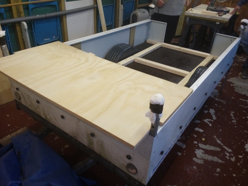

    Hiya last week myself and friends started on the DIY Pizza trailer which should be completed asap.
    I have uploaded the pics for you to look at
    Can you see any potential problems with this or should all be OK, I just want to be sure and iron out anything before fixing the dome to the actual trailer.
    The trailer is a trailer tent weighing 150kg and the oven is about 200kg and the max weight the trailer holds is 500kg
    I look forward to hearing from you
    Thanks

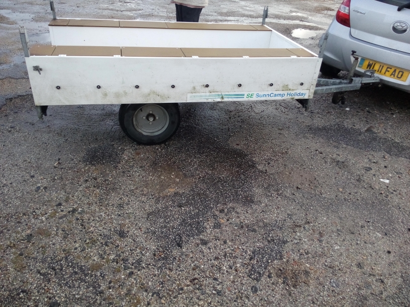

    Hey James,
    Is there any chance that you can add another axel to your trailer? Two axels will be safer imo. Aside from tipping when disconnectiong (I'm sure that you are working that out by centering the load a little foreward), I worry about what would happen if a tire blows out. Loosing the only tire on one side will cause a sideways shockload to an already topheavy structure. Just some things to think about when cross bracing the oven stand and securing the oven.

      I agree, those tiny 4 stud wheels look like the ones on a lightweight trailer for a small boat. How did it tow with the cast oven in it? Remember you still have to add a substantial amount of weight for the oven support to sit on, the insulation and outer shell, flue, cooking equipment and wood for firing.
      My ute is rated as a one toner, but I reckon it's overloaded with anything more than half that weight.

        Hi Chaps thanks for your comments which I have taken on board, Remember the trailer manufacturer says its suitable to 500kg.
        David - It has yet to be installed onto the trailer, this should be done Thursday

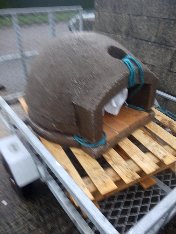

          Hi guys we done our first firing yesterday, what would you recommend thats nice but easy way of decorating the dome pls?
          Thanks
            After insulating all around it i.e. under and over it, you can either do an igloo with a render applied over the insulation or build an enclosure like a dog kennel. Regarding decorating it the easiest way is probably to paint it. I have flames painted on the outer shell of my mobile oven.
            PS If that's a hose you are using to douse the fire, don't do it again because it's damaging to the refractory and water will hamper the performance of the oven. Keep it dry.

              That looks smart and thanks for your input, Can i ask what would you recommend to fix the oven to the trailer to stop it sliding off.
                In my case I made a steel cradle that the oven sits in. It is held in the trailer by chains and turnbuckles. I did it this way so I could keep the oven under cover and also use the trailer for other purposes.Some builders have permanent chain or cables built in, others removable straps over the top. Search mobile ovens on this forum for ideas.

                    Check here for another method of securing oven to trailer.
