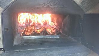

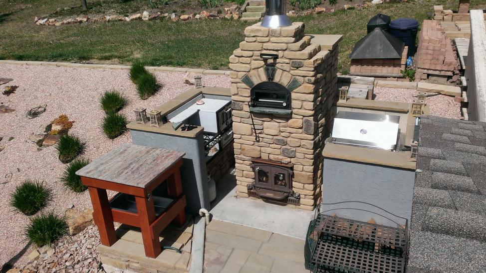

    Just sold this house above and I must build a NEW pizza oven. The fireplace insert chamber below, vented up into the traditional pizza oven chamber, and the heat from the wood alone up thru the sole vent in back was amazing for high pizza 800+ temperatures. My next pizza oven I want to heat up faster, and not need to be as insulated under the pizza floor, if I heat the oven floor with natural gas burners! In my new yard, I will build just a unique hybrid pizza oven that is gas fired and could also be secondarily heated in the chamber by hardwood.
    The 27" wide floor (3 firebricks wide) and the 45 " deep cooking area (ten deep firebricks 4.5" flat) is a perfect size oven for me, This hybrid goal is to be able to use only natural gas with a 3/4 inch gas line, and heat the pizza oven more quickly by having three huge gas burners below the firebrick hearth, to heat the floor of the oven. The three huge burners come on a 42 inch by 22 inch wide camp-style wheeled cart, that is 36 inches high, allowing it to slide right in the corner under the entire pizza oven. The 2 custom designed industrial built burners in the back and middle of the oven can each have a 100,000BTU rating, and the closest to the front I will order a lesser 40,000BTU burner. The 3 gas pipes under the 3 burners will be over 12 inches down from the burners, so the metal manifold and controls will not be impacted by heated as much. I want to buy a custom cut piece of thick sheet metal, 27" by 45", that is either 1/2 inch thick, or 3/4 inch thick, to have the firebricks sit upon and stay FLAT!

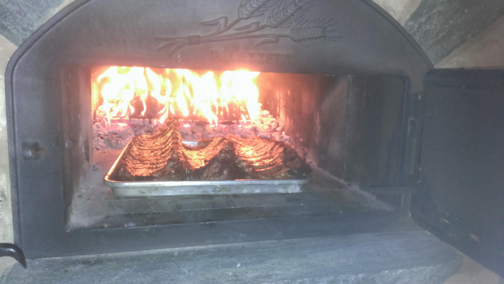

    The combined 240,000 BTUs I believe are four times as powerful as some of the marketplace gas jets for pizza ovens I see in the internet. The custom made cart and 3 awesome burners will cost under $900.00. Multipurpose, too! They can heat the floor of the oven, and simultaneously allow heat to go up and around the two sides, thru slots/vents in the firebrick adjacent to the oven's barrel shaped walls. We'd have a larger vent in the back, to best emulate the flames seen in my old pizza oven cooking ribs below.
