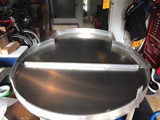

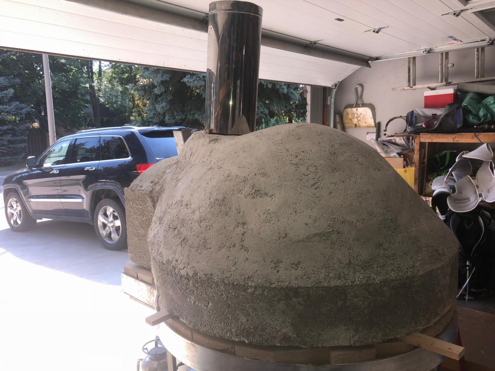

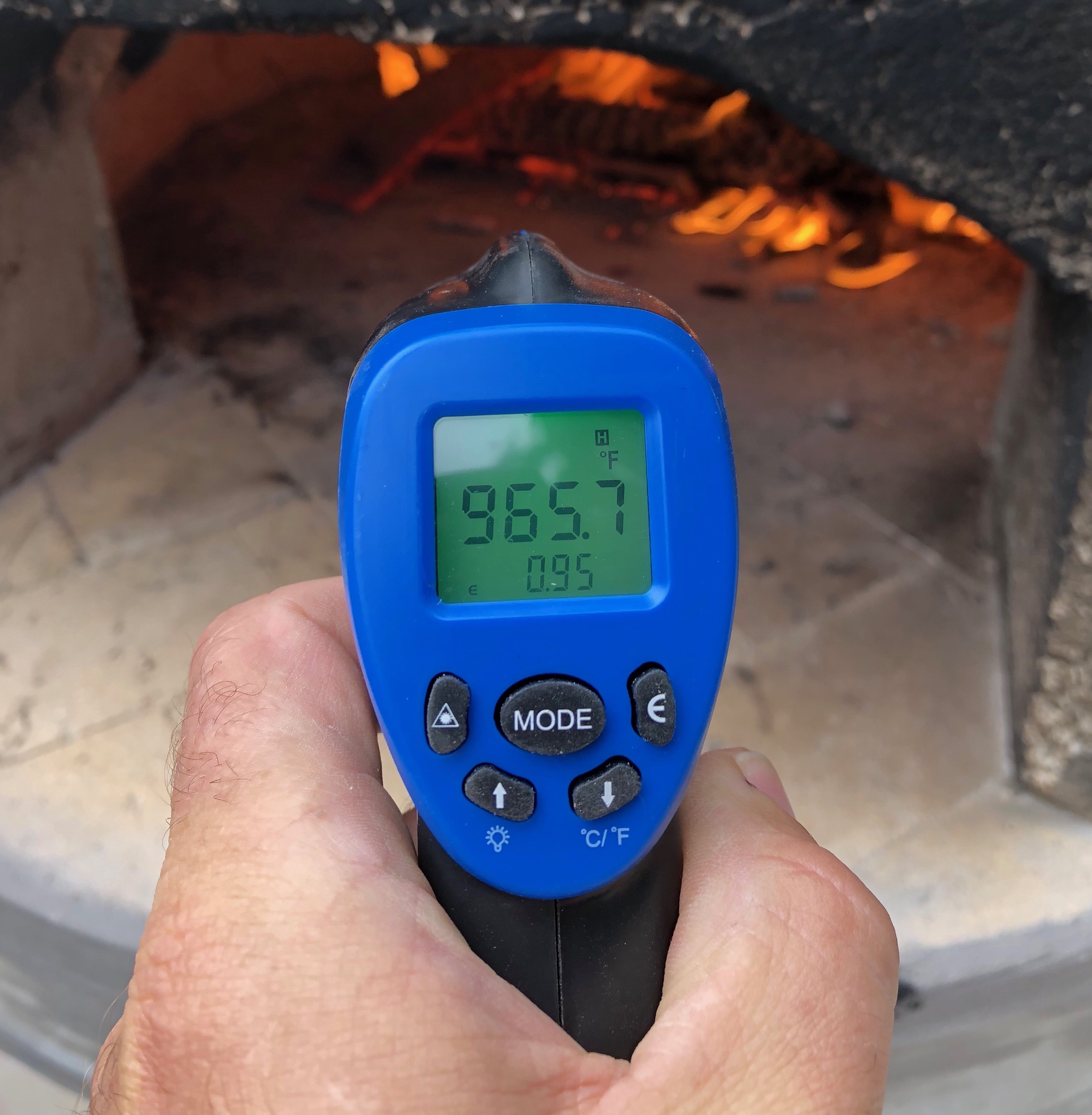

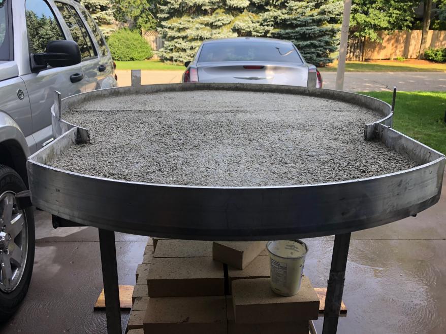

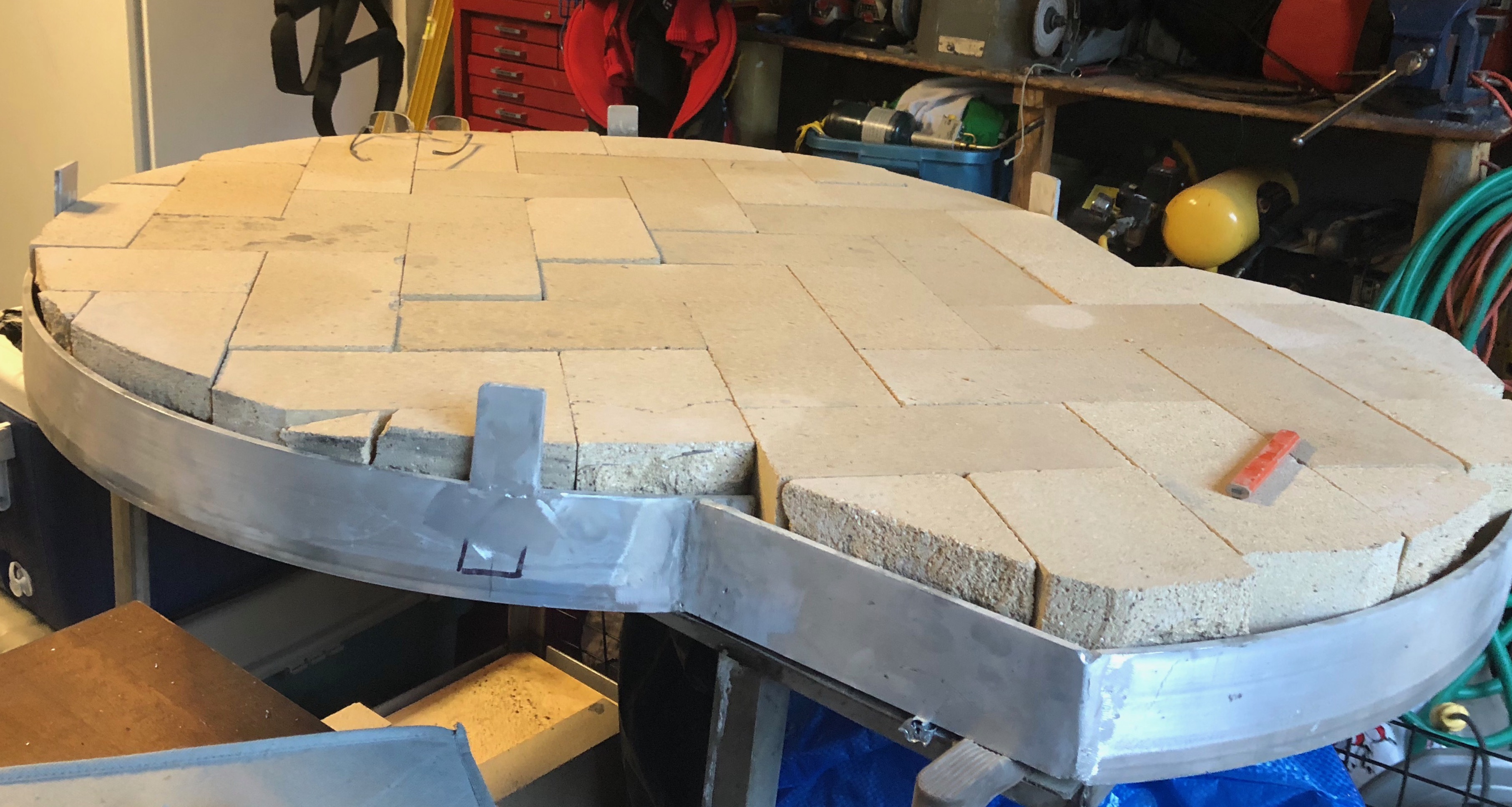

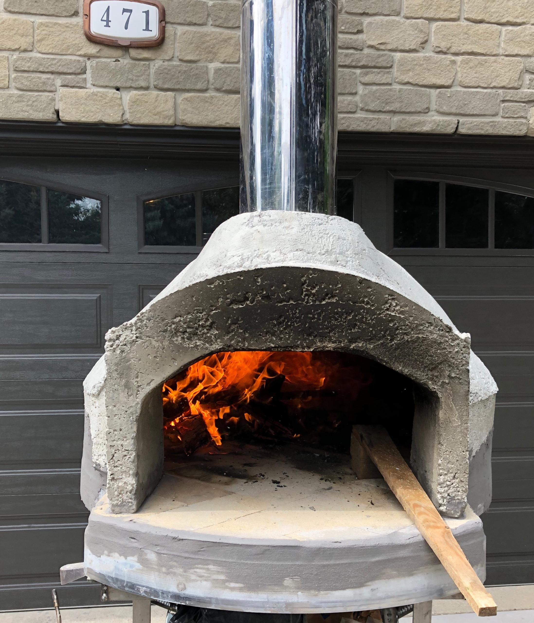

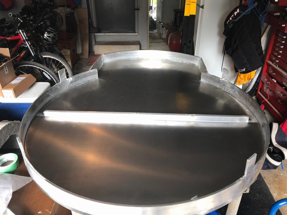

    My perlite concrete oven creation. started oct 2017, first firing Sept 2018

    Here are some more pictures

      Any my thoughts on using roxul insulation, wrapped in chicken wire and stucco render over top?
      • fox
        • Mar 2017
        • 388
        What mix did you use for the dome?
        • Richfergie
          • Apr 2018
          • 18
          It was a mix of 5-1-1-1
          perlite, concrete, fire clay, sand
