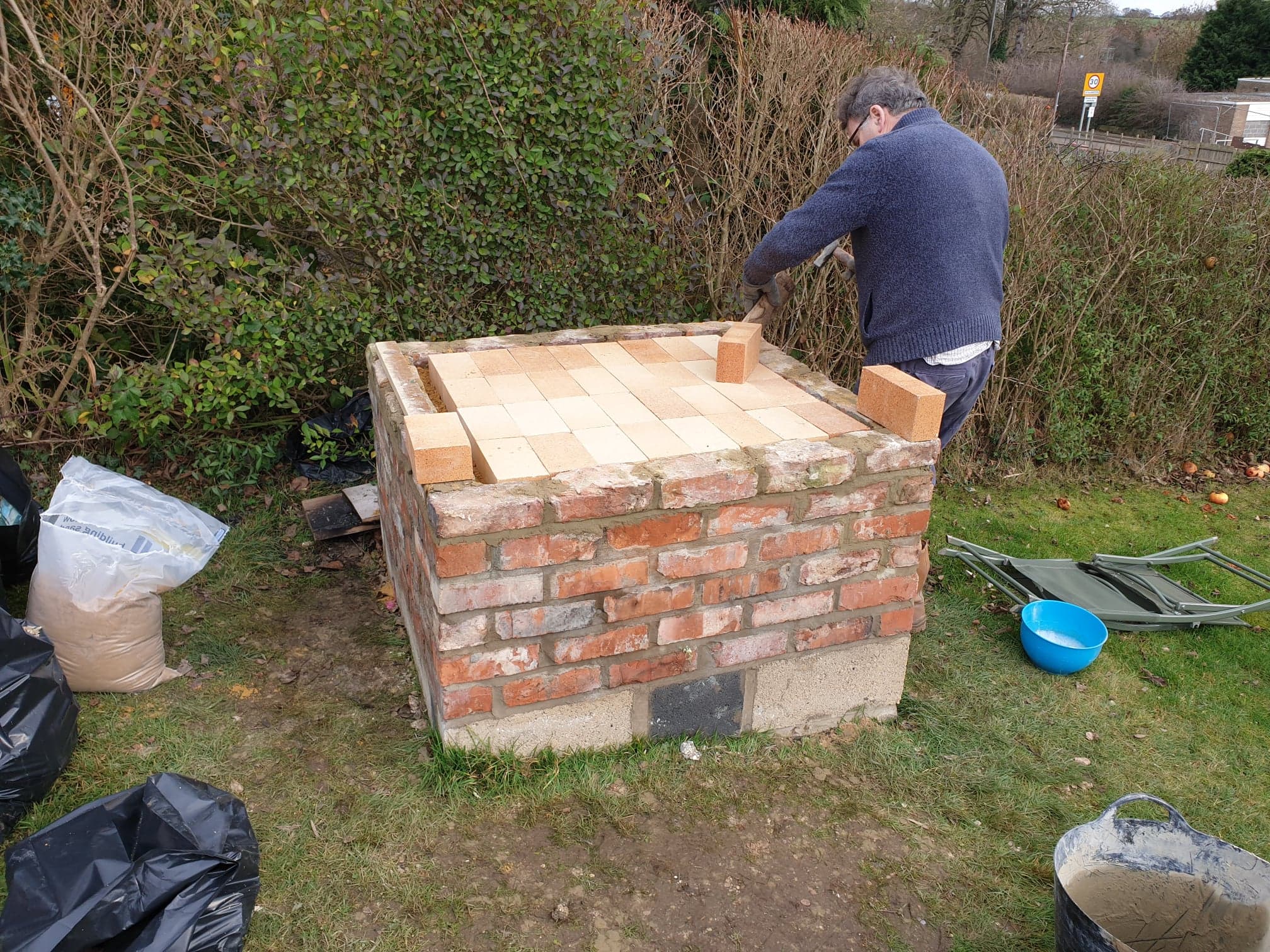

    First step was to break up and remove the old oven, add a course of bricks to allow me some depth to place and level the fire bricks for the oven floor,

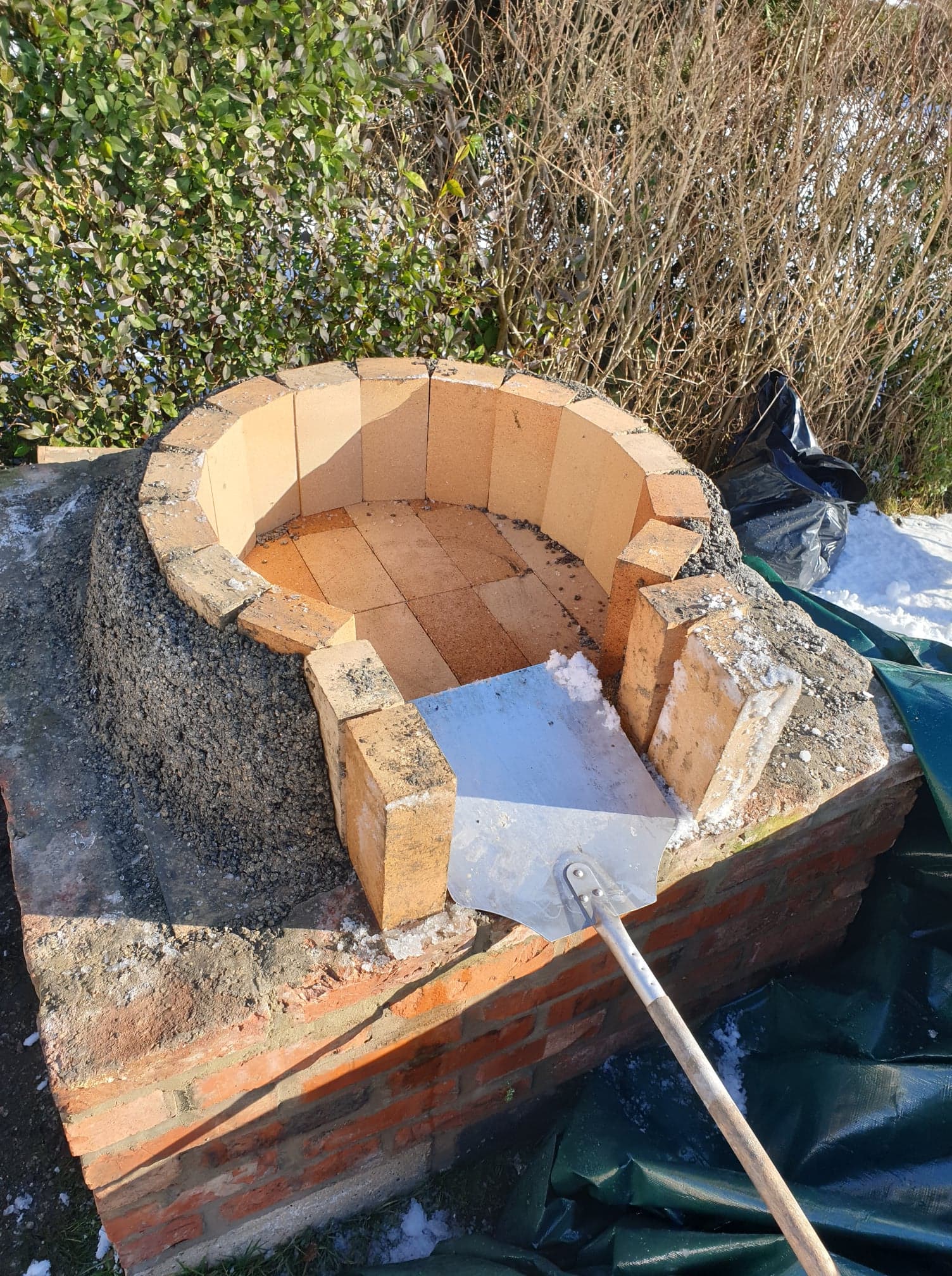

    I followed this with a ring of firebricks to form the bottom 22cm of the inner oven. I then packed 5:1 vermicrete around this to hold them in place and to act as insulation. This was covered with a tarpaulin to dry

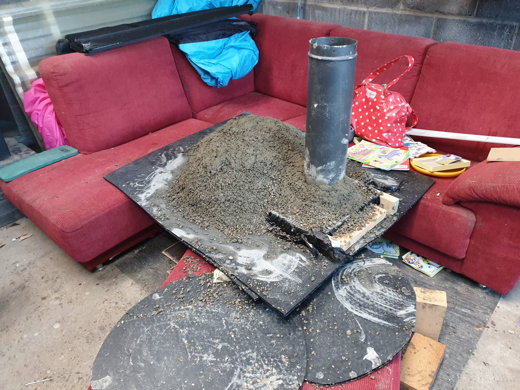

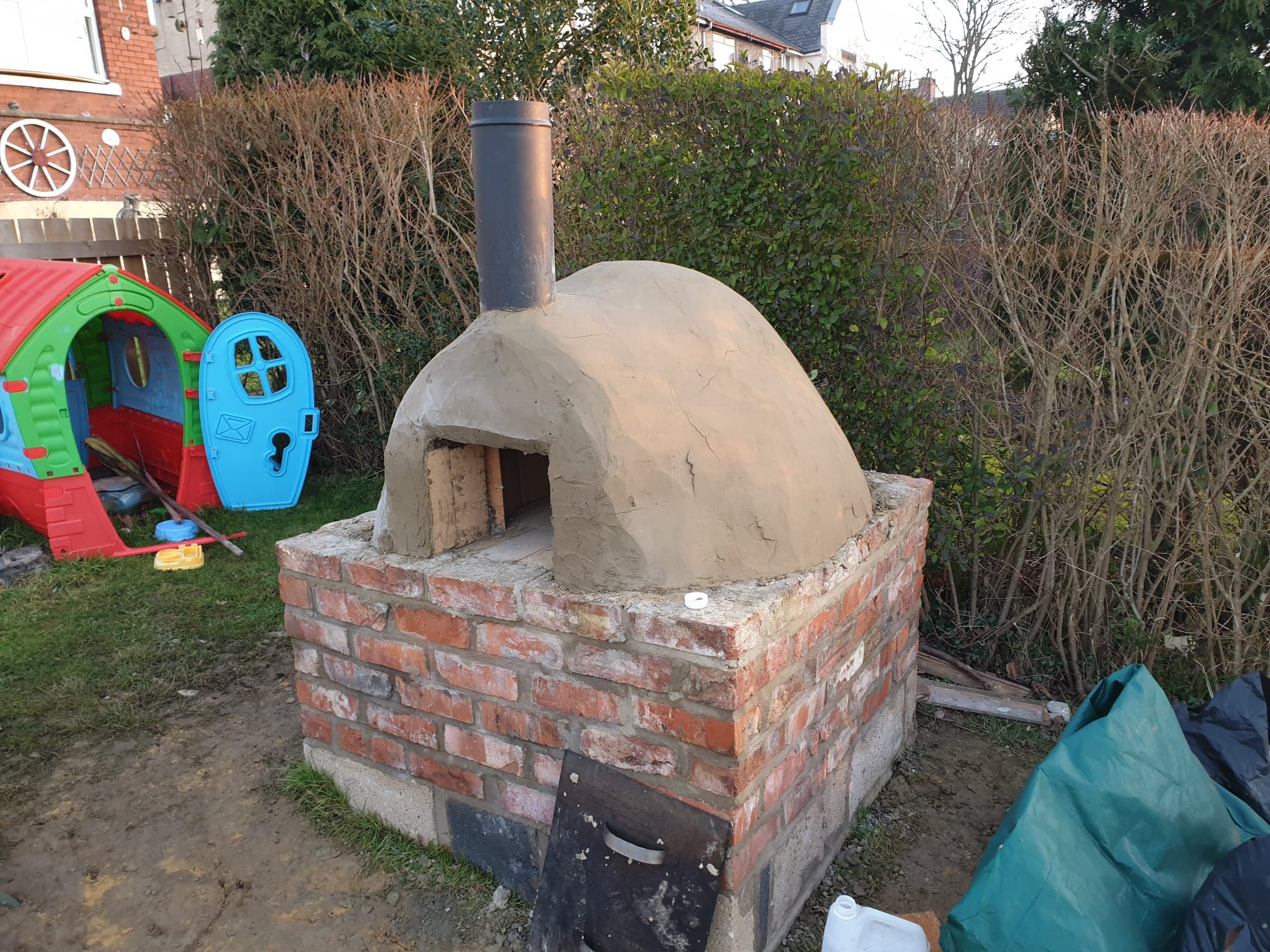

    I made a mould in the garage to form the top curved portion of the inner oven the flue (6" logburner flue) was cast in at this point.
    after drying for a week the oven was carried out and placed ontop of the form and vermicreted together.
    the whole oven was then skimmed with a standard mortar mixture (4:1 sand to cement) to give the roof some thermal mass.

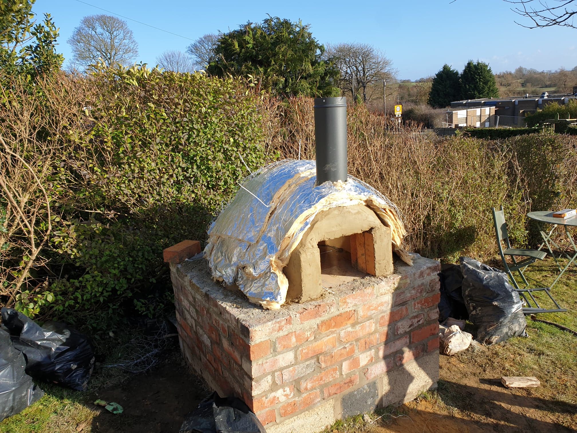

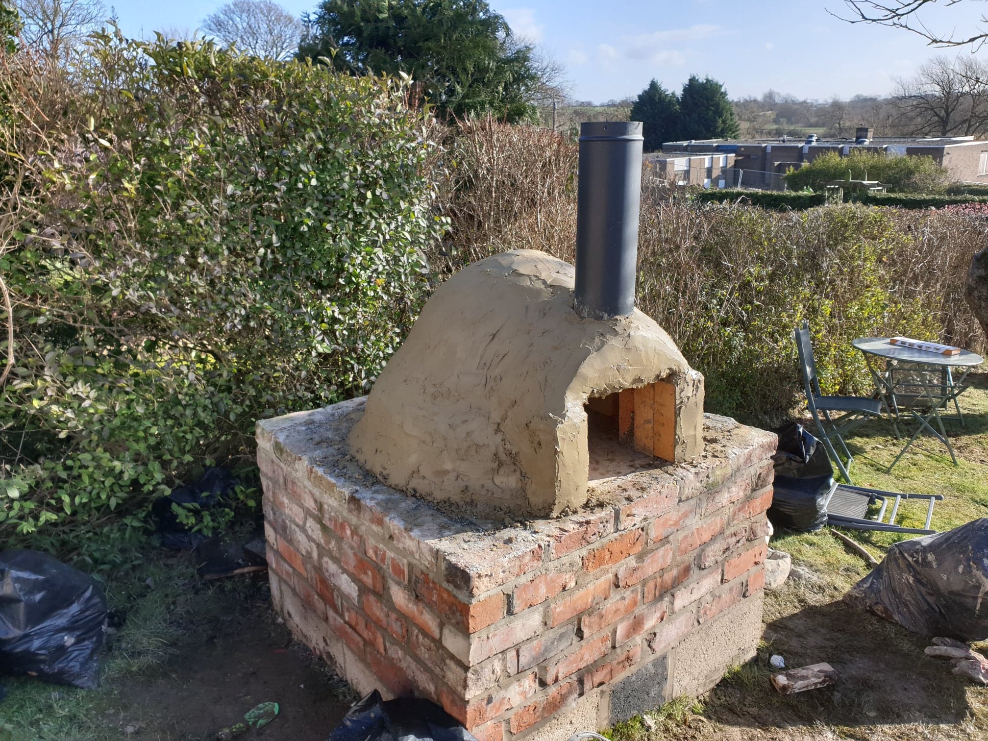

    The whole oven was then insulated with 2 layers of glass wool pipe lagging insulation held down with chicken wire and then skimmed twice more the first time to cover up the chicken wire the last as a smooth decorative coat.
    I am currently waiting for the second skim to dry to allow me to paint the whole thing white and then tile around the door way. Any questions let me know!

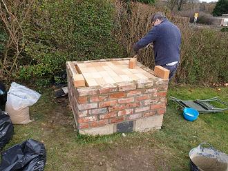

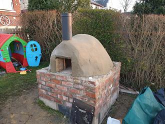

      Click image for larger version  Name:	52586514_1894459387329192_5928050274395488256_n.jpg Views:	4 Size:	417.4 KB ID:	410992Click image for larger version  Name:	51838939_504521110076170_3537025234634801152_n.jpg Views:	1 Size:	638.2 KB ID:	410986Click image for larger version  Name:	51865927_262162484682553_5415403493341003776_n.jpg Views:	1 Size:	581.8 KB ID:	410987Click image for larger version  Name:	52309193_553429345154502_3236728328253603840_n.jpg Views:	1 Size:	527.2 KB ID:	410988Click image for larger version  Name:	51957930_765244237194360_5021106511812755456_n.jpg Views:	1 Size:	651.3 KB ID:	410989Click image for larger version  Name:	52008374_1944914368968007_6094202879537577984_n.jpg Views:	1 Size:	483.7 KB ID:	410990
      Pictures of the process here, also its always good to be friends with an old bricky!

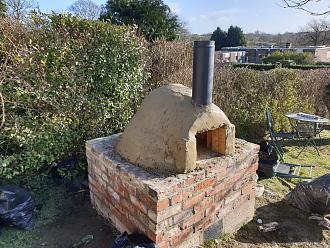

        last few photos below, including original oven

          I could be wrong (hope so), but it appears that there’s no insulation under the floor bricks apart from sand. It is vital to insulate the oven over the top and sides as well as underneath. Heat rises via convection, but will travel equally well in any direction by conduction, including downwards. Sand alone is not a great insulator as only the airspaces between the grains will act as insulation. Contact points between grains are where heat can easily move via conduction.
          • Theo_Dot
            • Jan 2019
            • 7
            Yeah fortunately I have done a layer of glass bottles just below the sand the firebricks are on. Not hugely technical but seems to work pretty well!
