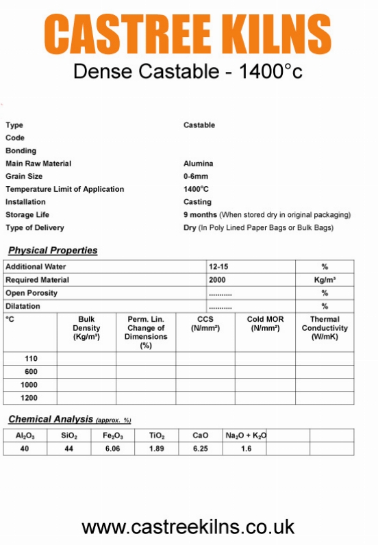

        So I have now recieved some Fibermesh micro fibres from Sika UK that were kindly donated to the cause, and a data sheet provided by Castree Kilns for their 1400c castable (which should both be attached for reference purposes.) I had requested a sample of castable to test though doesn't seem to be possible. If only the place wasn't so far away. It has been stated there are SS needles in mix by the both the supplier and Fox. Though I can't seem to be able to get an idea of amounts. Though I'll probably add some to the order and do some experimenting to be sure there is enough to assist my structural (mobile) needs.
