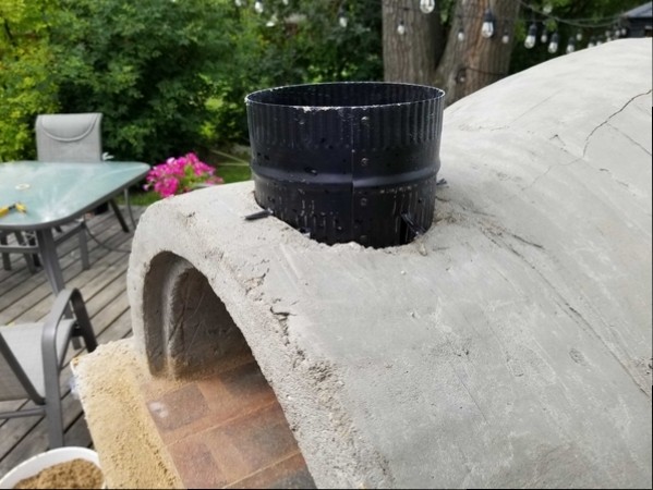

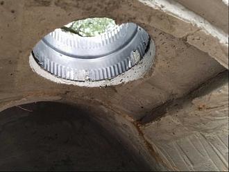

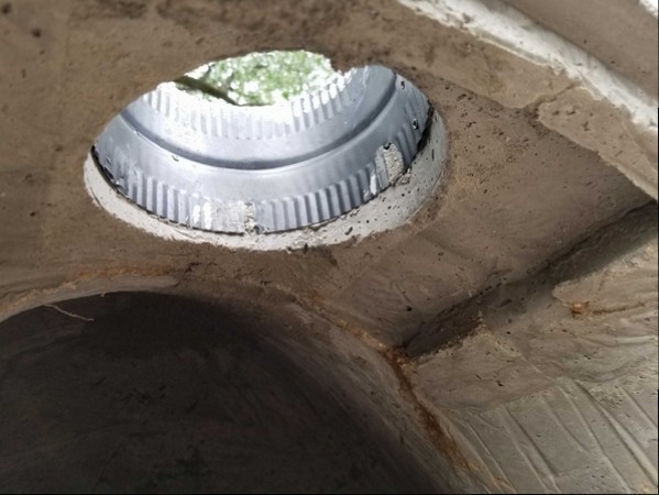

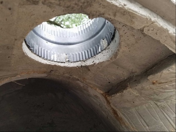

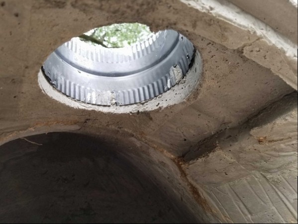

                  Hi TeddyVikings,
                  did you notice any cracks around the opening in your flue?
                  It looks like a tight fit, no problems with the black stove pipe joiner expanding and cracking the area around it?
                  Originally posted by teddyvikings
                  Hey Carbivore.
                  I used a 6" Black Stove Pipe joiner from HomeHardware. Worked great. Ted
