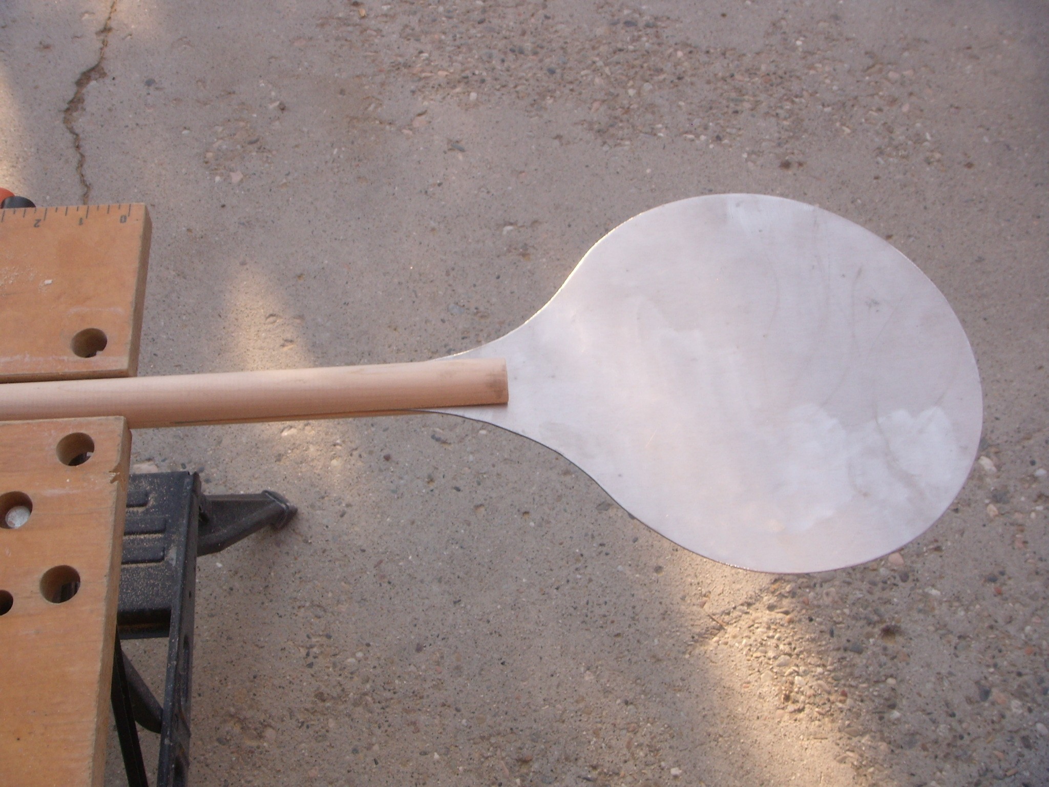

Name:	68B Banjo Peel  9.19.12.JPG
ID:	416997 The pizza will get better and better as you get to know your oven. One suggestion, a small banjo shape metal peel will help you with turning the pizzas in the oven, the loading peel you have is just too big. You can make one relatively easy, since you are a repurposer, an old stainless steel refrigerator or bbq grill ss panel will work. Even aluminum will work and easier to cut.

                      Thanks for all the replies, my oven flue is 6" diameter and 1 meter high, kept to the 62% ratio for hight and half the oven diameter for the door width. The tunnel entrance is about 12" deep with the flue starting 2" from the dome, this leaves 4" before the door. Got all this info from this site and the uk wood fired oven fourm, thanks guys totally agree the pizza peel i made is way to big just 1" smaller than the entrance! Was made in a hurry in work so i could use the oven last weekend. Will make a smaller one and 8" round peel / banjo style. Also plan to make a flame / heat deflector to sit between the fire and the pizza, was also going to make a andiron to sit the wood on and a ash scraper with the other end of the pole a hook to help move castiron trays around when i try roasts I work for a engineer company so get the material and making is easy. have seen some people use blow pipes to help get the fire started but so far have had no problem with lightning under the flue then pushing back once going.
