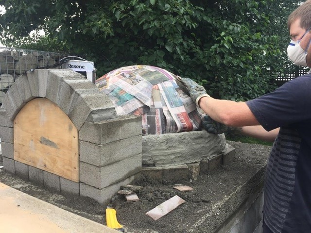

              been a while but i have finished the concrete dome
              • Natc
                • Jan 2020
                • 13
                Starting the application of home brew refractory. I had the news paper in small strips and it got such a pain that I took it off and applied the mix directly over the sand
