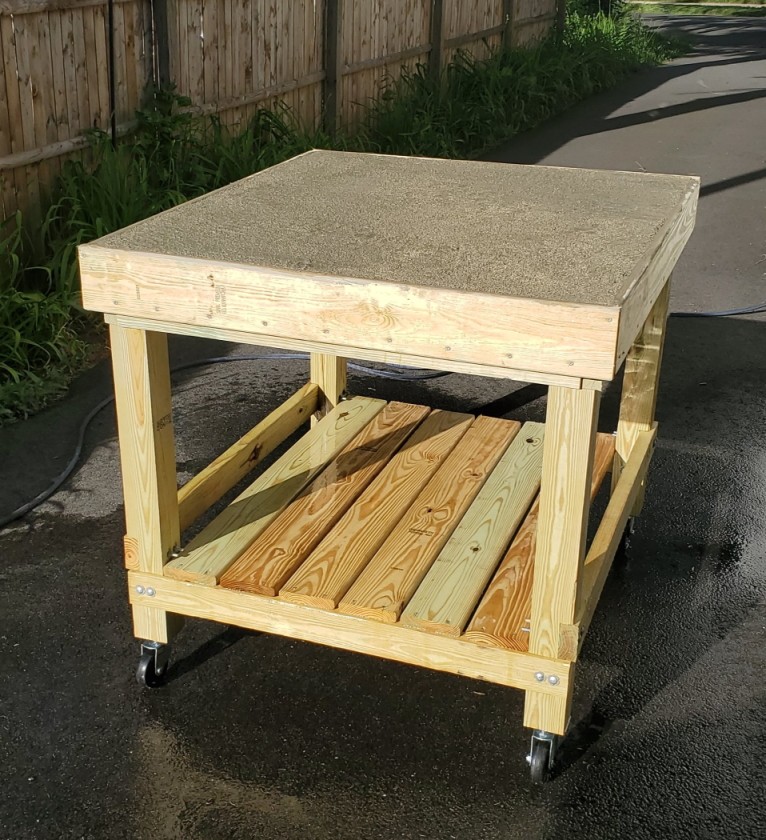

I understand and agree, however as I mentioned when I started this stand I was renting a home. So I could not build anything permanent or anything I'd be fine with leaving behind. So the stand will do for a while until it gets to its new home in a couple months.
I was wondering about stability but the stand is rock solid and is larger than it might appear. Its 4 feet by 3.5 feet. Not going to tip over even if a wheel pops off. The casters are rated for 330lbs each so I'm pretty confident I'm way under 1300lbs total. If I calculate up all the material weights the oven and base are in the 350lb range. Larger wheels will only serve to raise the center of gravity. I may add some cable cross bracing with turnbuckles if I feel it needs it.
You cant see in the picture but the horizontal cross beams on top are also supported inside by Simpson joist hangers. Not just the 2 screws you see on the outside. According to the mfg load tables they are rated at 200lbs load each end. I have 6 on there. The checked in ones are loose to be slid out and replaced with a long beam to move the entire top.
I dont plan on wheeling this thing all over the place, it will sit on one spot until moved to the new house where I'll make a permanent stand for it. Hence the knockouts to be able to lift and move the oven off the wood stand. Until then it will be stored in a garage out of the elements.
