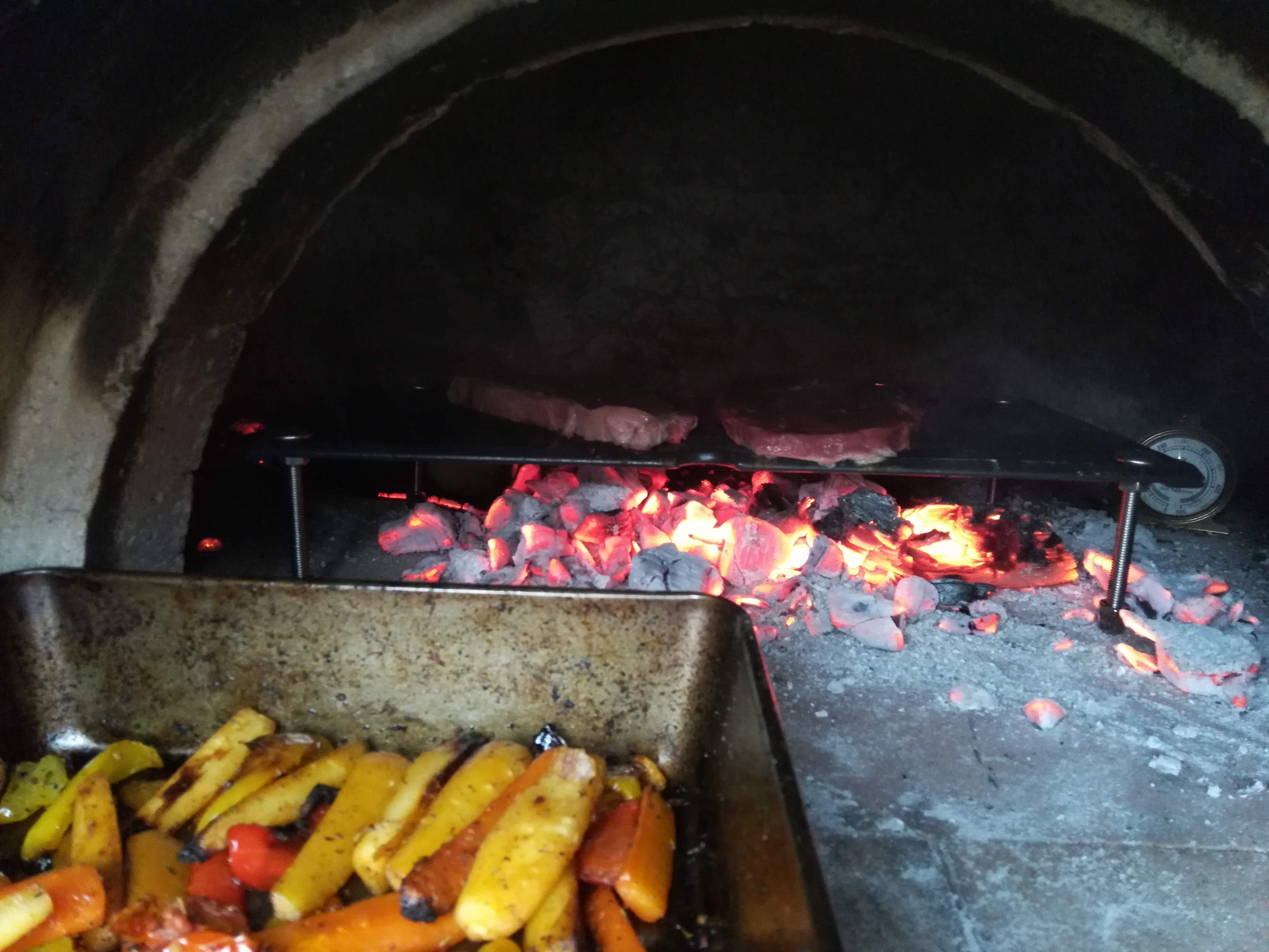

                  I'm happy enough with it, however I would go with the slightly larger option if I was doing it again. It would be nice to have a bit more room when sliding dishes in and out past each other. I got lucky that my Tuscan grill just about fits. Click image for larger version

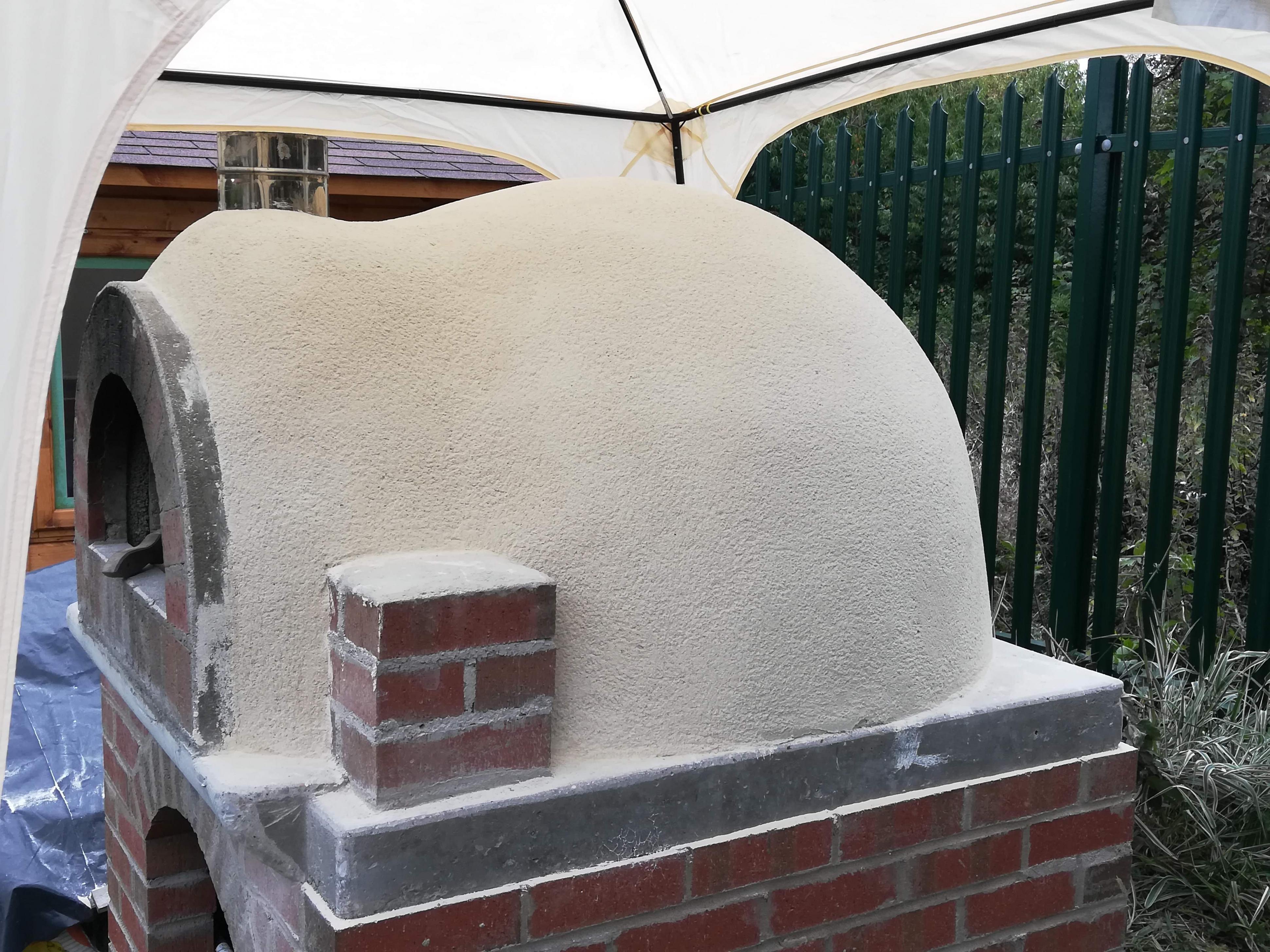

                    Over a year later I've finally rendered my oven. Weber through colour render.

                      Mesoiam, thanks for going out and measuring! I may just go with 18". Nice finish!
