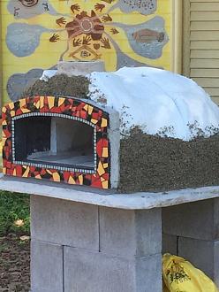

    I have now made some progress on my oven. I have cast the inner dome, damp cured it for a week and then further cured for another two. I have then added 75mm of CF blanket to the dome and 50mm perlcrete around the opening arch to hold the flue in place.
    My plan is now to add chicken wire and then render on top.
    My question is now what type of render I should be buying for this? Just any render I would use on a house facade?

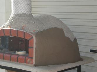

    1. The perlcrete mix Ben uses is way denser, thicker and stickier than what I use. The 10:1 mix is far crumblier and harder to apply, but is far more insulative (see table)
    I Then use a much stronger render to apply over the perlcrete in a thinner layer. Notice I don't use any chicken wire over the blanket as it's way too time consuming.
    Alright. I think 10:1 is too lean for me to work with. I can see from the instructions to the MFC oven, that he uses a 5:1:1:1 of litefill perlite, cement, hydrated lime and sand. If I want it to be more workable than the 10:1 I used before, would there be any benefit to adding sand and/or lime? I know you recommend fire clay as well to make it stickier.
    2. Often a crack can develop where the outer dome shell meets the supporting slab. My solution is to coat the whole dome and the supporting slab with a flexible waterproof acrylic layer around at least 1mm thick. I use flexible pointing diluted 20% with water so it can be painted on.
    Could I maybe ask for a link to the acrylic product you use? just so I have an idea of what to look for.
    Click image for larger version  Name:	image_83170.jpg Views:	0 Size:	146.2 KB ID:	438883 Click image for larger version  Name:	P2170021 copy.jpg Views:	0 Size:	45.5 KB ID:	438884 Click image for larger version  Name:	IMG_1369.jpg Views:	0 Size:	779.5 KB ID:	438885
