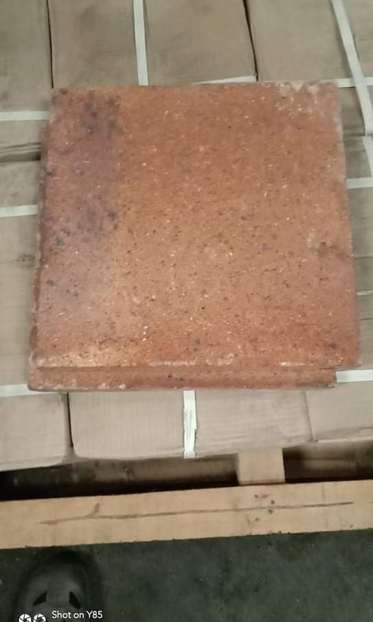

So I found what I hope is suitable firebrick (318mm x 318mm x 63.5mm or 12.5" x 12.5" x 2.5") the seller calls it 'Shiplap Brick' and 'pizza stone' about $17 USD each, he also sells 25kg refractory cement almost $100 USD...

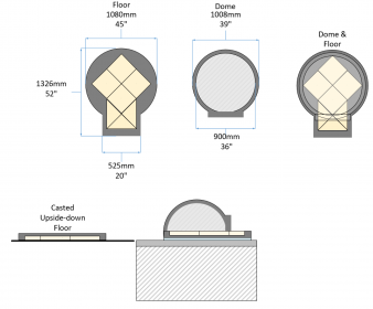

If this 'shiplap brick' is suitable I hope to use refractory cement to cast around it as shown in the drawings below... the black line represents the black plywood upon which I'll lay the bricks, I will place thin cardboard between the bricks and the outer perimeter of the bricks for expansion space then cover the tiles with plastic wrap so they won't stick when I pour the castable in the 4" mold, I'll screed the top which will be the flat bottom of the floor (when flipped over). Total oven floor thickness will be 4" (2.5" floor bricks plus 1.5" castable under the bricks 4" thick around the bricks) Should I chickenwire or do any reinforcement for inside this floor? Once cured this will be flipped over and placed on top of 36mm CaSil which will be on top of some deco tile sheets for drain channels. The bricks will then be placed back in the space they left when the floor was cast.
So far is this floor plan a good or bad idea? Will two 25kg sacks be enough for the floor? I also plan to cast the flue top, do I need more refractory cement? Or should I do it all with homebrew?
