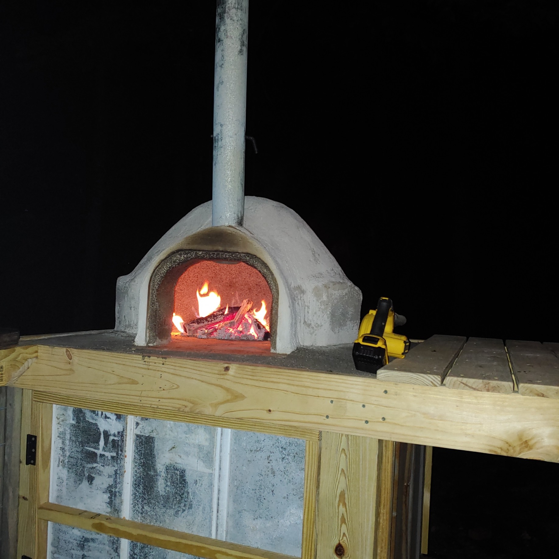

      Evening Gulf,
      I understand that the perlite and concrete is an ugly word to enthusiasts. I have watch and read hundreds of post and videos before deciding to go the route I did. Also it worked flawlessly until the last 2 times I'd fired it. I am posting some pictures of the oven so you can view it.

            David,
            Thanks for the pics. Your cooking surface appears to be at the same level as the support slab. insulated or not, that creates a recess that can trap water under the floor tile/brick. I can't tell if you have a flue cap. There is much advice on this forum about building to prevent water/moisture intrusion. However, the best after the fact advice that I can give is to build a roof over the oven to shed water off of the exposed door and hearth. Build it with some overhang and it will increase the number of days per year that you can comfortably operate the oven. Again, keep firing the oven until it is dry and do your best to keep it dry.

              Gulf,
              Thanks for the advice. I had planned on a cover/roof over it tied into the deck. Future plans... The fire brick floor is only about 1/2 inch above the surrounding concrete floor. That floor is about 3 inches thick and in over a recycled tin roof metal (like around the base, which is my wood storage). Again thanks for the advise.
