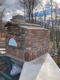

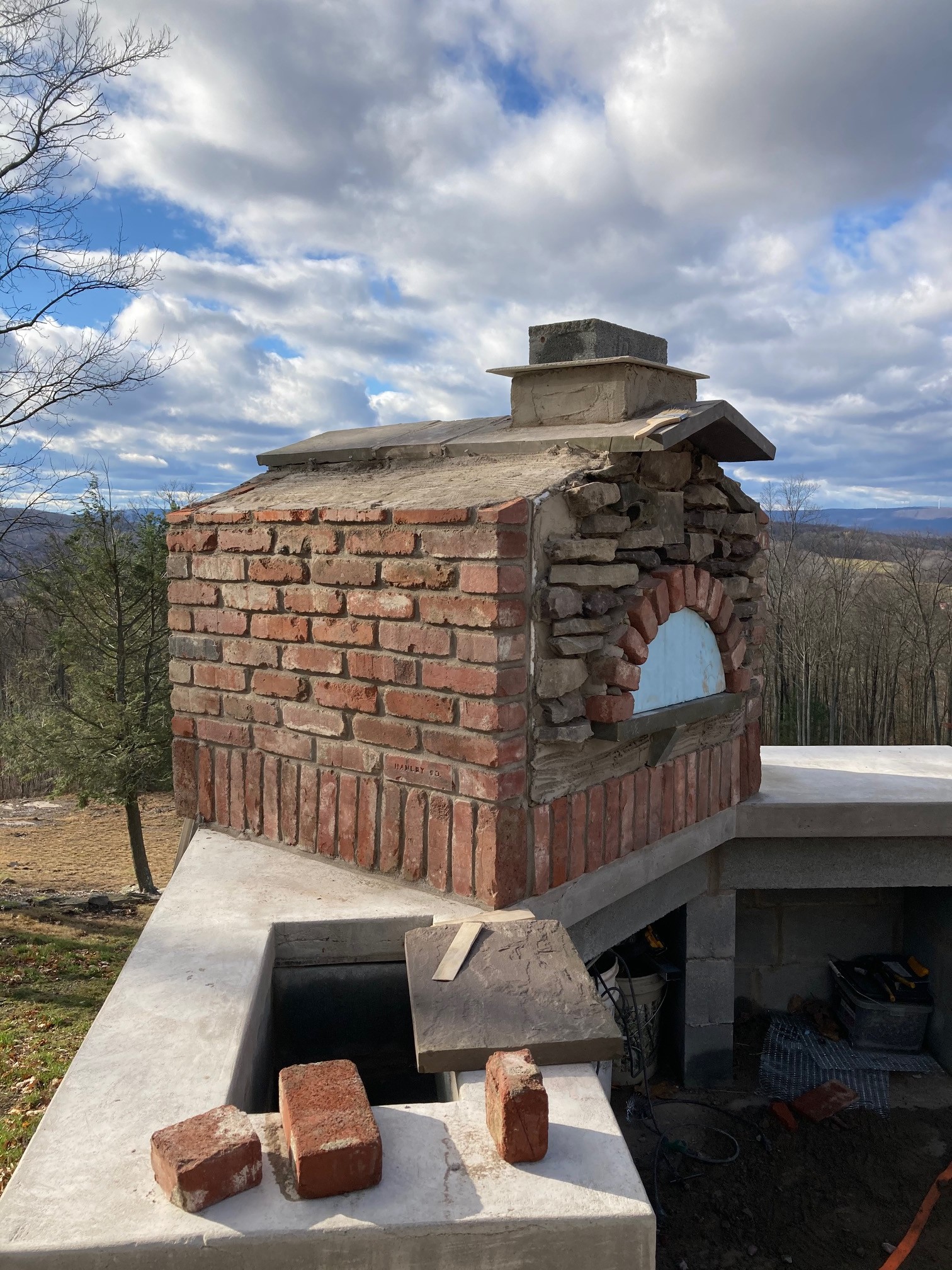

    I spent the day finishing all of the stone/mortar work and the roof panels. I had to make some wooden supports for under the edge of the overhang because the fieldstone roof panels were sliding. I will get pictures tomorrow when I’m able to remove the supports and clean up the mortar from the countertop.
    I am thrilled with how it came out, even though it hasn’t been fired yet, I love the look of the stone and brick together and more importantly, she likes it as well. Thank-You to everyone who has posted pictures of their ovens for inspiration and ideas.

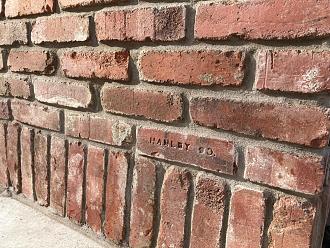

    Also, while sorting through the bricks, I found 2 which had the foundry name cast into them. I did a little research and Hanley Brick Company was founded in 1893 and the building that the brick were reclaimed from was built in 1903. Nice piece of history and story to go along with the build. One went on either side.
