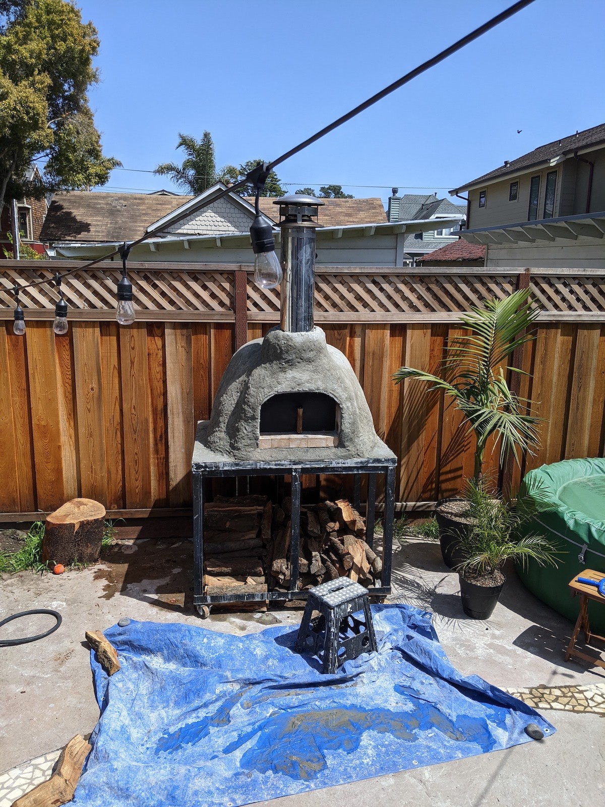

          Here's over after the coat of 4:1:1 with AR fibers was applied--definitely starting to look a bit more finished. Been getting great pizza results, so happy about this project.Click image for larger version

          • #20
            Looking very nice! Am very jealous you were seemingly finished in a month with your homebrew cast while I have been laboring for months with my firebrick geodesic build and am not near completion. May I ask how long it takes for you to get to 900 F or pizza temps?
            • #21
              Thanks! I typically fire by stacking logs around the perimeter then building a smaller fire in the center and letting it burn with the door mostly closed. I'm usually ready to cook pizza after a hour and fifteen minutes or so.
