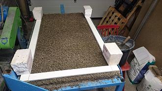

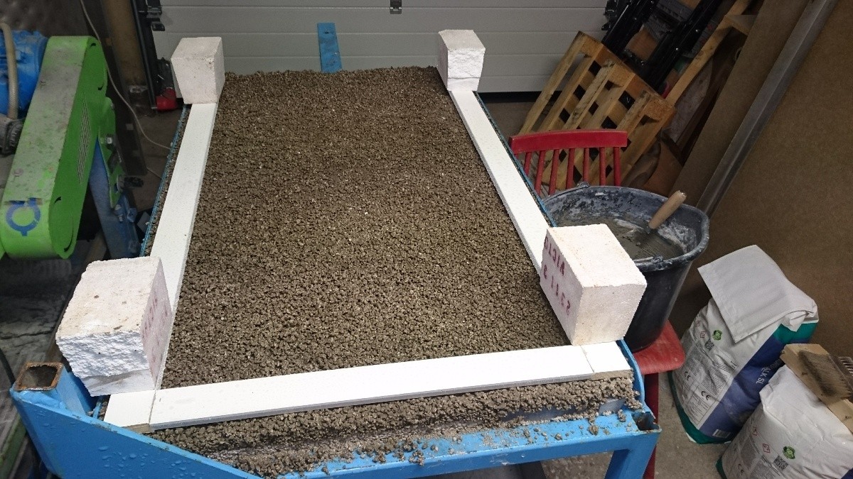

    Bottom 60x100 cm wide x long, 7 cm deep. Look at the bottom right in the picture for understanding.
    - Supported 3 mm hot rolled steel.
    - Insulation made of 7 cm mixed leftover CaSi- board and ratio 25:1 perlite:cement (by volume, 2:1 by weight). About 30 % board and the rest perlcrete.
    - 1-2 cm Homebrew for leveling and floor and dome support.
    Click image for larger version  Name:	_20210515_194243.JPG Views:	0 Size:	290.3 KB ID:	438085 The homebrew was cast inside this frame on the insulation.
    No stainless needles or PP burn out fibers were used in the homebrew. The sand was plain sand, 0.1-1 mm in size. The clay was kaolin, I did not have fire clay. It is less stickey but more refractory and shrink less than regular fire clay.

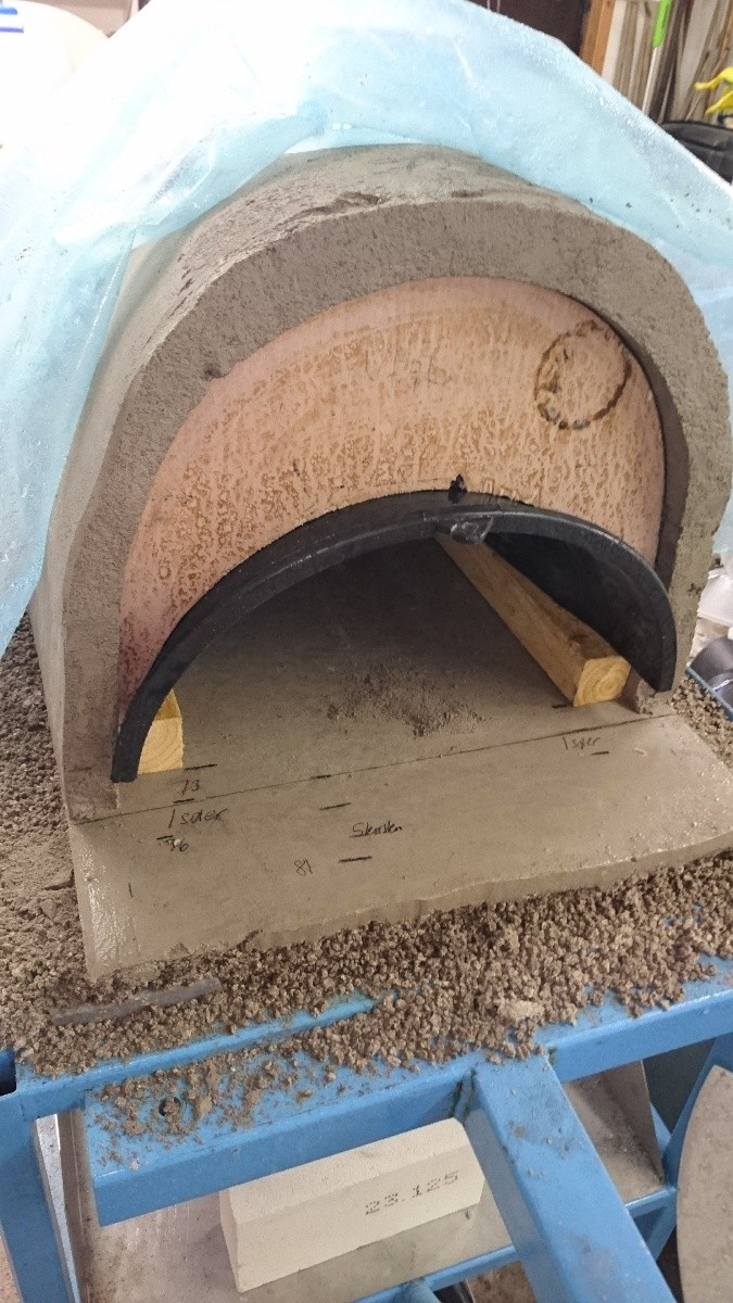

    Dome
    - 3 cm thick front and back.
    - 3 cm thick sides, gradually thicker to 5 cm at the dome top. I did not fill in the casting defects after mold removal.
    - 27 cm high, 40 cm wide and 70 cm deep.
    Click image for larger version  Name:	_20210515_194142.JPG Views:	0 Size:	242.8 KB ID:	438082
    Flue gallery
    - 1:5 refractory cement (Calcium Aluminate) and perlite. About 3 cm thick adjacent the dome and 5 cm towards the front. I was scared of spalling if OPC was used and I already had the CA.
    - About 50x150 mm flue, XX cm high.
    - 15 cm opening height (9/16 ratio, 0.56 instread of the commonly 0.63). XX cm deep.
    - The opening was cast on a half bucket and expands towards the opening from the oven chamber.
    - Thin render with homebrew. Maybe 2-4 mm to protect the perlcrete.

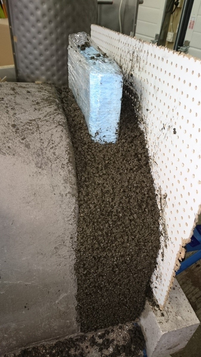

    Insulation
    - 7 cm on the sides expanding to 10 cm around the dome of 25:1 perlite : cement (portland). 2:1 by weight. 0-5 mm perlite fraktion. About 0.22 kg/l dry density.
    - 7 cm on the back.

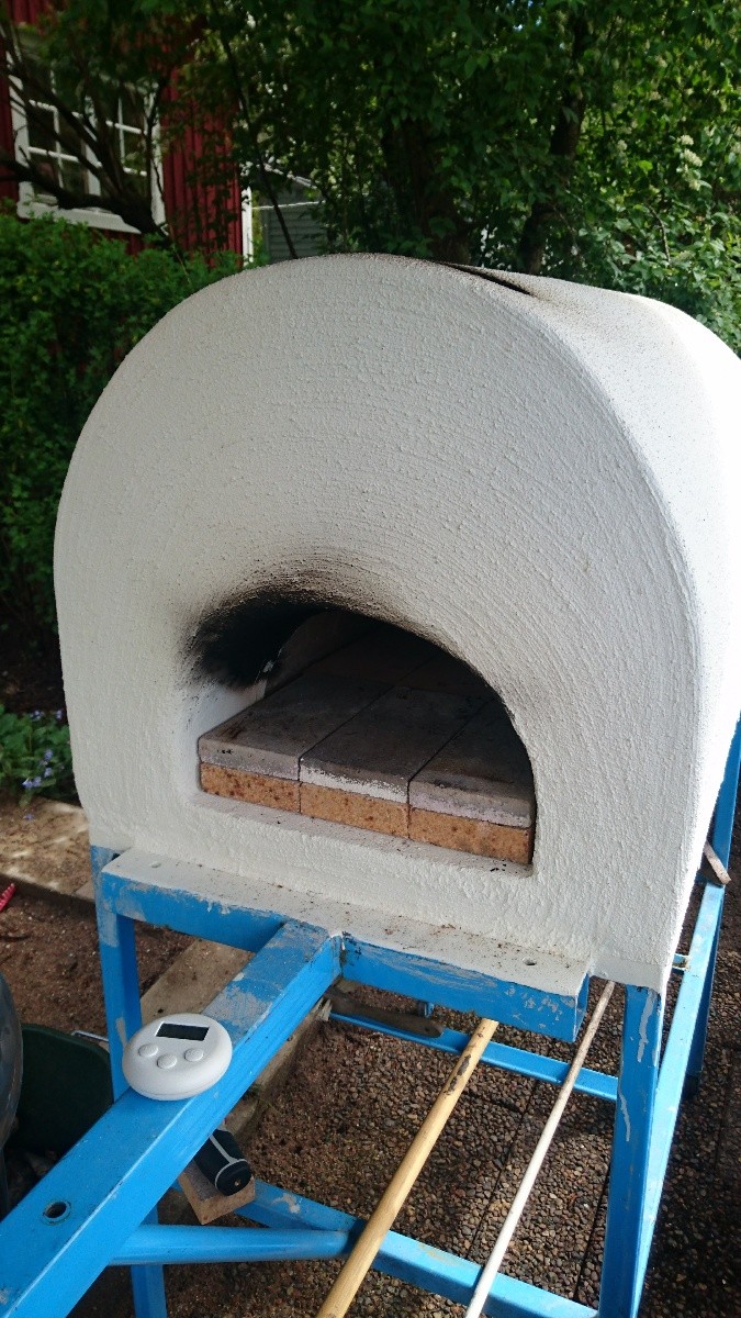

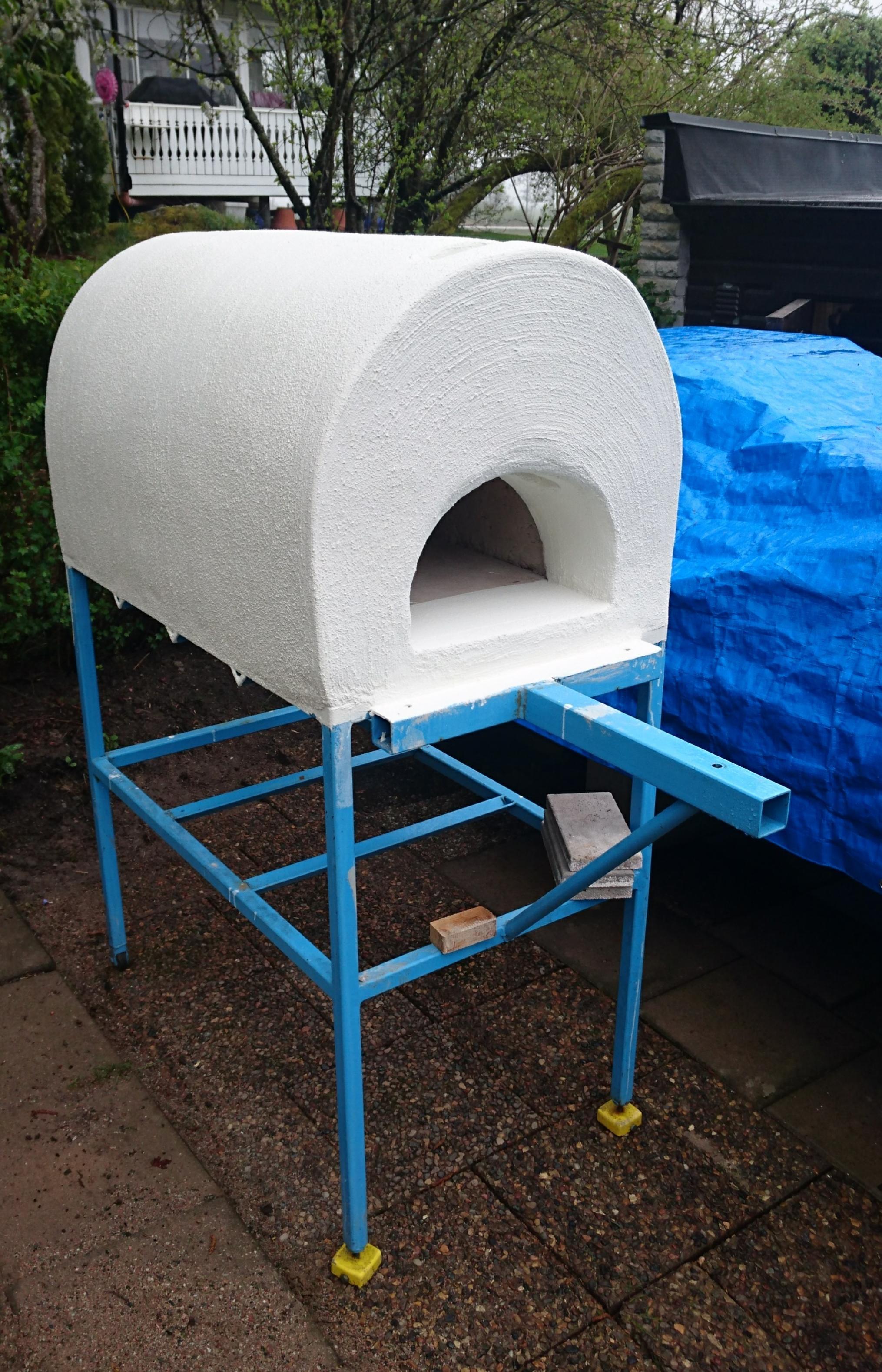

    ​​​​​Final render
    - Galvanized wire mesh 2x2 cm squares around the whole oven.
    - 1.5 cm 4:1:1 sand cement lime.
    - White Silicate paint.
    Click image for larger version  Name:	_20210515_193659.JPG Views:	0 Size:	807.1 KB ID:	438084

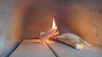

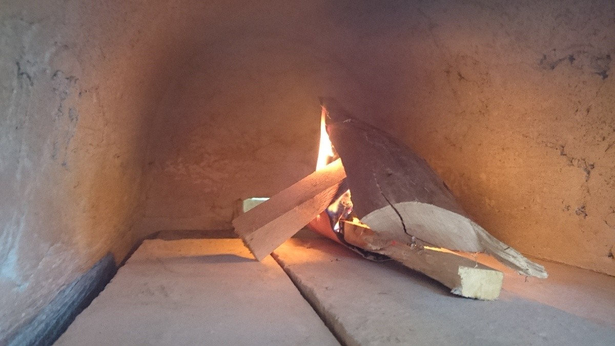

    I got help from 3 hungry neighbours to lift the oven into position and started the fire the next day (today actually). 200-300 C top dome temperature for 8 h. No steem, cracks or so. Increased to 500-600 C over next period of 4 h. Everything went very well. Two small hairline cracks on the inside of the opening where the 2 mm homebrew layer was. I have not noted anything else. Not in the dome or on the outside. Very pleased with that so far.

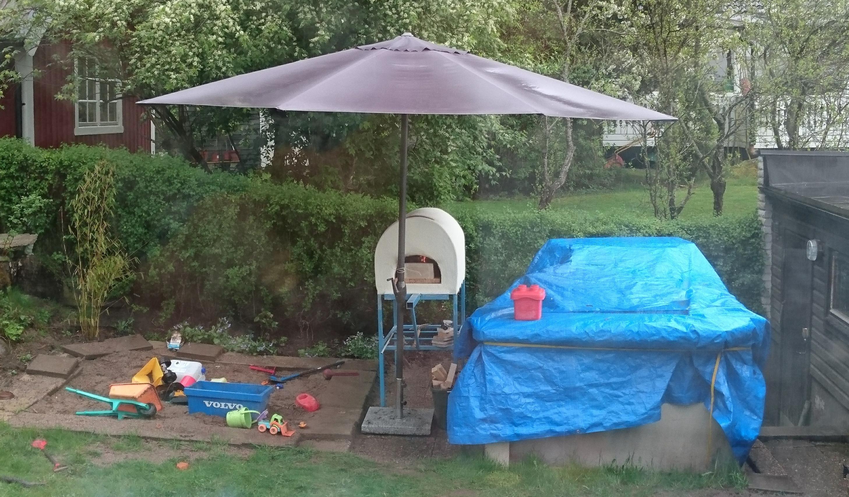

          Ha ha, yes, I forgot to take the homebrew smear thickness into acount when casting the gallery... I did not want to infear the over all mouth shape too much, so I just smeard some.
          ​​​​​​It will be covered with a small removable roof. A gas-bbq rain cover would fit perfect, but I want to be able to see the oven from the garden even when not in use.
          Very exited about today. Rain is still falling. Hope it stops Pizza for lunch. I'll let you know!
          The next oven is under the tarp... The garden and kids have priority but I'll build some when warmer, better weather comes.

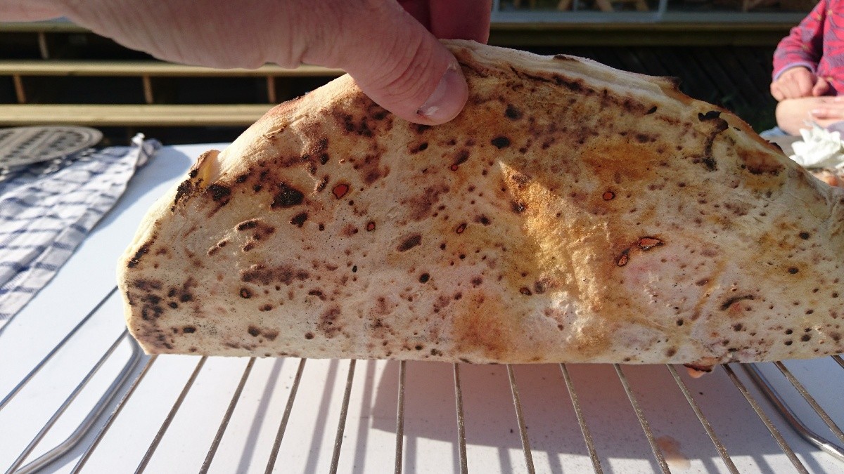

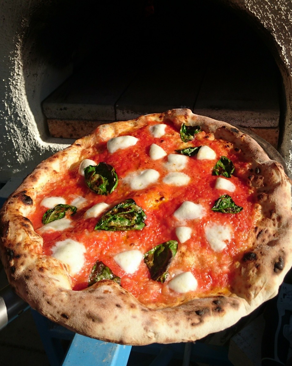

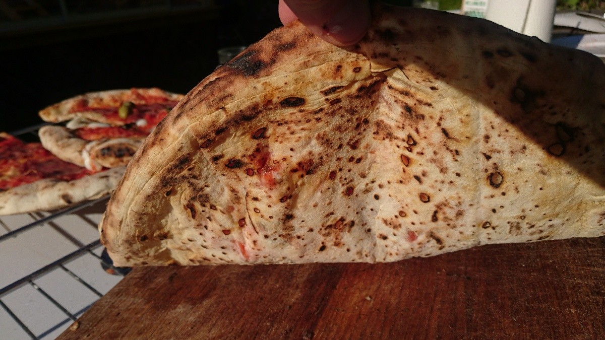

            Pizza today. The rain stopped. 3 h preheat. Mostly 480-520 C (900-970 F) on the floor. Pizzas baked for 32-52 seconds. Best was about 45-52 s. 35 was good but 32 gott bitter in the bottom. Temperature was 560-570 C for that one. None was burned. They all looked pretty similar.
            24h, 2% sourdogh. 12+12, 23 C, 65 % hydration. Low activity unfortunately. Only 10% rise. Made the crust low and dense. I have a few fails with white SD. Will go back to yeast for a while now.
            47 s pizza:

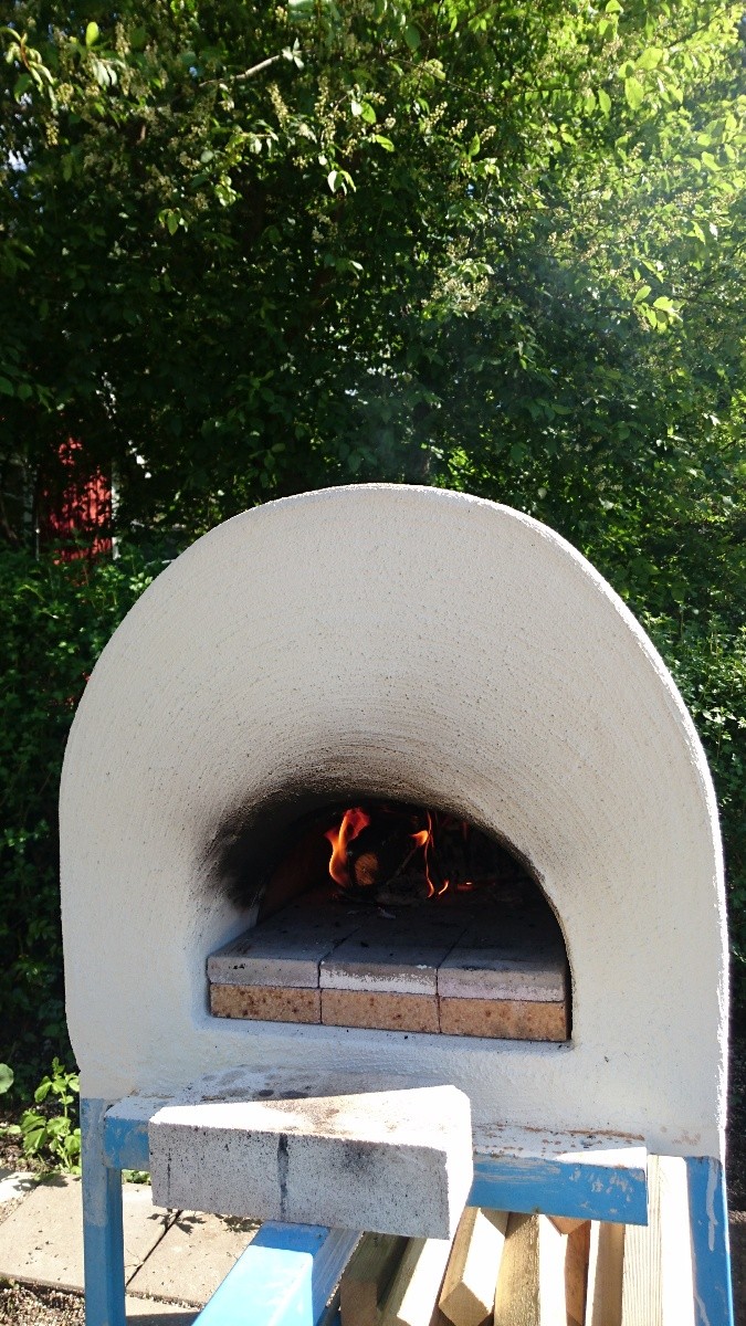

            oven front after 2 h fire and cooking without a draft door. Not too bad. I'll skip the additional height on the chimeny for now.

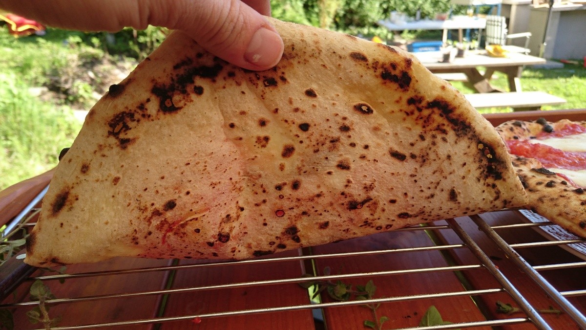

              14+10 h RT dough. Hand mix, 4 stretch & folds. 0.15 g yeast per kg flour. 65 % hydration. Ramlösa kvarn 00 flour. (Swedish 00-flour)
              65 - 70 s bake time. 430-520 C deck temperature. Rotated after 20-25 s.
              Made 4 Margherita, 2 salami and 2 with only EVOO, rosemary, garlic and sea salt. 320 g balls, 12" pies.
              Like the more even browning better but miss the rich favour of the sourdogh. Hmmm...

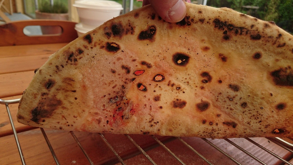

              Upskirt:
              Click image for larger version  Name:	_20210521_192855.JPG Views:	0 Size:	237.6 KB ID:	438332
              next deleted image. Edit: posted the same pizza twice :-) (embaressed) I deleted the correct top image unfortunately. The upskirt image us correct though. Sorry...
              Click image for larger version  Name:	_20210521_192717.JPG Views:	0 Size:	237.8 KB ID:	438330

                  Thanks :-) It is fascination that fermentation can make such a difference. I asked the two oldest kids, 5 & 8 years old, and they both said the first (SD) pizza was the best. More favour in the crust. Hmmm better to learn to please the croud... I will try your suggestion of adding yeast to the SD. Sounds like a good compromise.
                  I've learnd that the leoparding comes from sugar deficit in the dough. That's why you get a pale crust with dark blisters. I personally strive for the second-pizza-look, a even browning. It taste sweeter and more complex but lack depth. Only wish to combine it with the SD-fermentation taste.
                  Yes, I always have a flame while cooking. The top takes too long otherwise. Room temperature dough as well. My spy indicated a 10 % rise. People at Pizzamaking.com seems to bake at 50-80 % rise. That would take me 48-72 h at room temperature with 2 % starter. Got to adjust the feeding schedule and starter amout. So far I've taken my bread-SD, given it a few feedings with 00-flour and then used it. However, it has never exceeded 100 % rise. Even without salt.
                  I'm not the best with bread but can make decent loafs with sufficient consistancy. So I got the confidence just not really know how to do the error-ellimimation process. The salt addition really slows down the fermentation, so in bread, I add it after 45 min. It works well. Maybe try that for pizza too for a start.

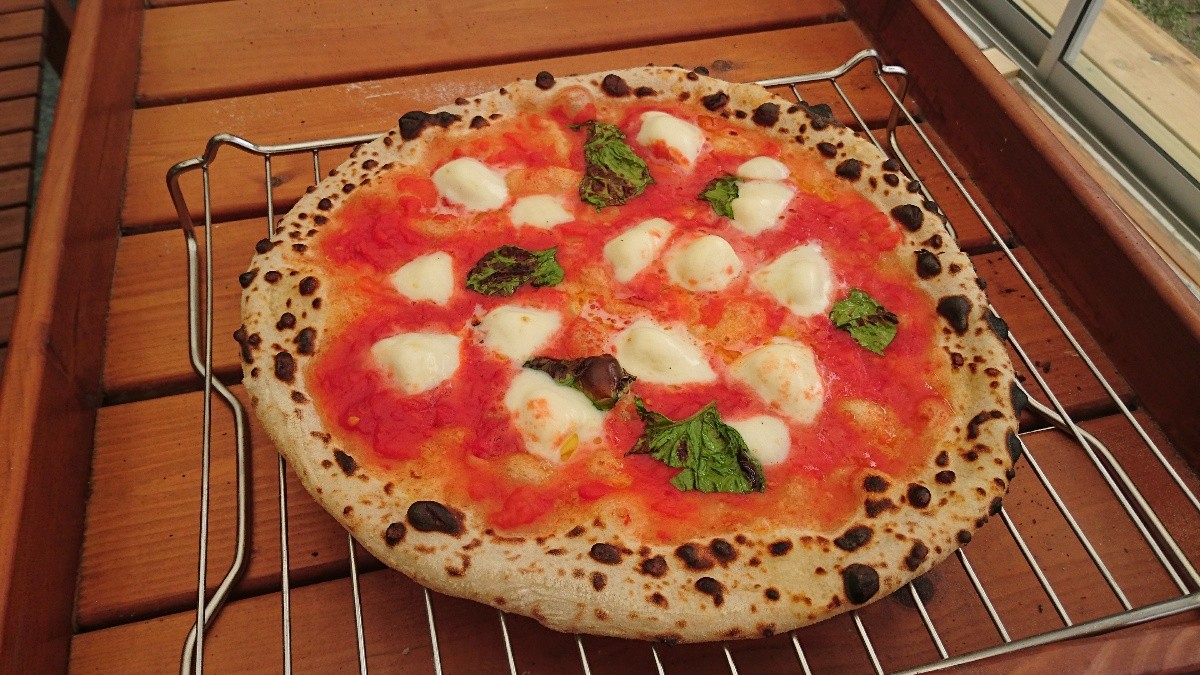

                        Today's bake. 6 % starter, RT water, dough temperature about 24 C. 11+10 h. 64% hydration.
                        Dough has risen 10 % after 11 h. 50 % rise when baked. Got nice crust this time. 61 s bake at 480-520 C deck temperature. The dough was smoother but not as relaxed as I wanted compared to yeast. I think I'll aim for something like 1.7 rise.
                        Fire...
                        I loaded a bit too much tomat sause and teared 3 bottoms...You don't get to see those ha ha.! The other five was okay. Here is 1.5:
                        61 s
