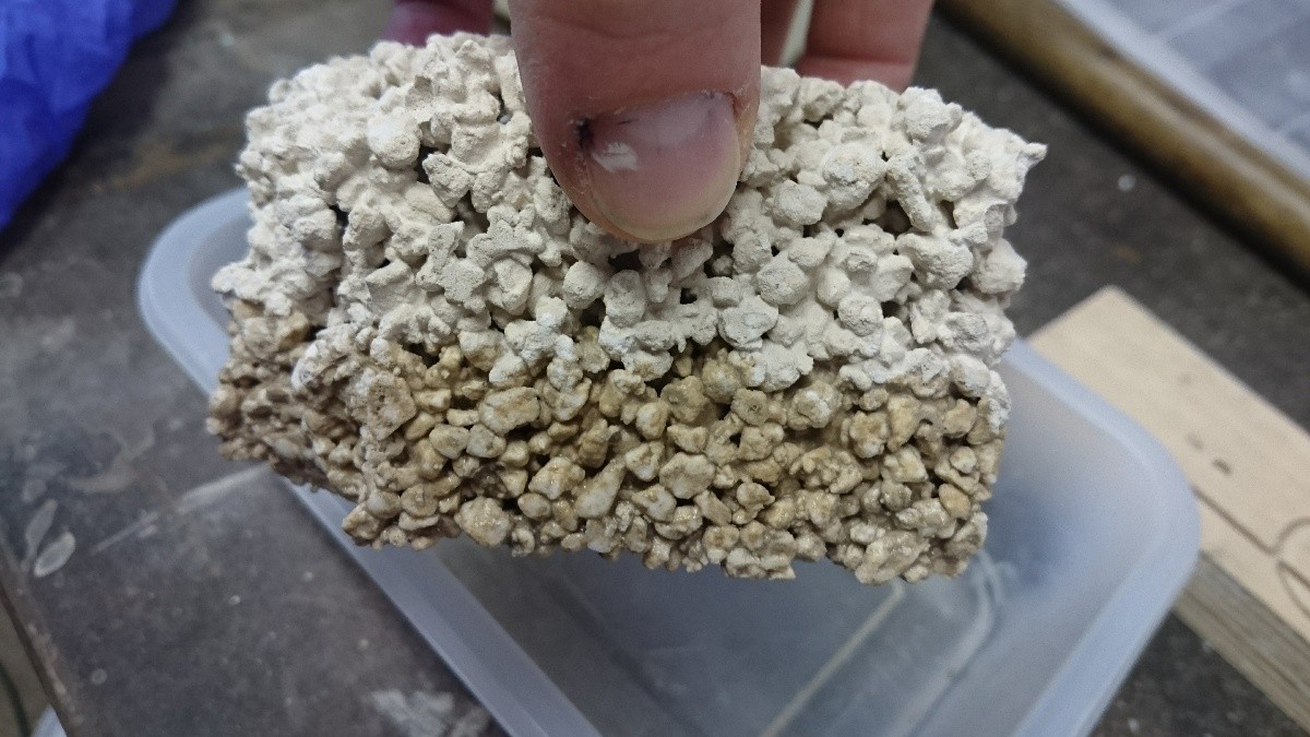

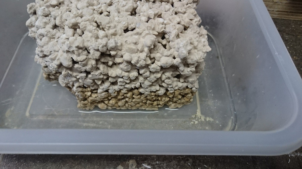

            Diluted the SS 1:1 with water. About 5 mm deep in the jar. Let a 1:25 cementerlite cast absorb for one minute.
            Got a capillary rise of about 20 mm.

            Lifted it out do dry on the jar edge, wet side down. Will cure it later today and put it in the fire for a few hour to see what happens.

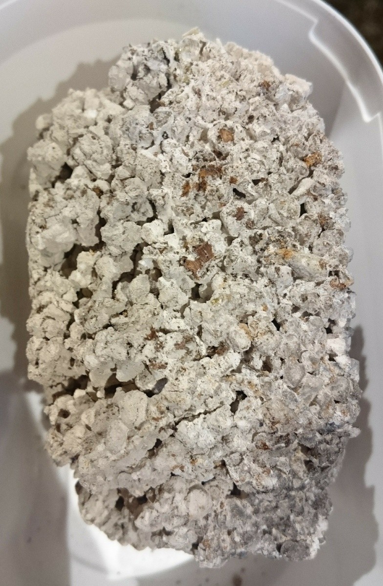

              After 1 h drying under the chimeny and 2 h in the fire/coals (700-800 C):
ID:	438334 the right is the SS-coated perlcrete. The left (untreated) side show signs of wear at the edges from log drops. It is also brittle and falls apart when poked on. The treated side is way more robust and though, a 1:25 mix!!. It does not crumble when poked and is still intact.
              I would with no doubt recommend you to coat it. Can you remove the dome and turn it up-side-down?
              Use a garden sprayer to apply. Wear mask and eye-protection. Coat it twice with a 1:1 blend and then a single coat of only Sodium Silicate only.
              Let it dry one day between coatings.
              Cure very very slowly. Keep a dome temperature of 50-70 C for a few h using coals. Then increase to 120-150 C keep for 2 h. Then you are set to go. Too fast temperature increase will make the bonded water go to steam too fast and form blisters.
              Good luck!
