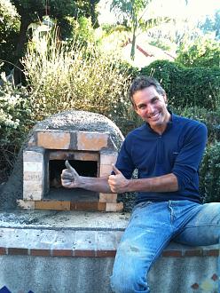

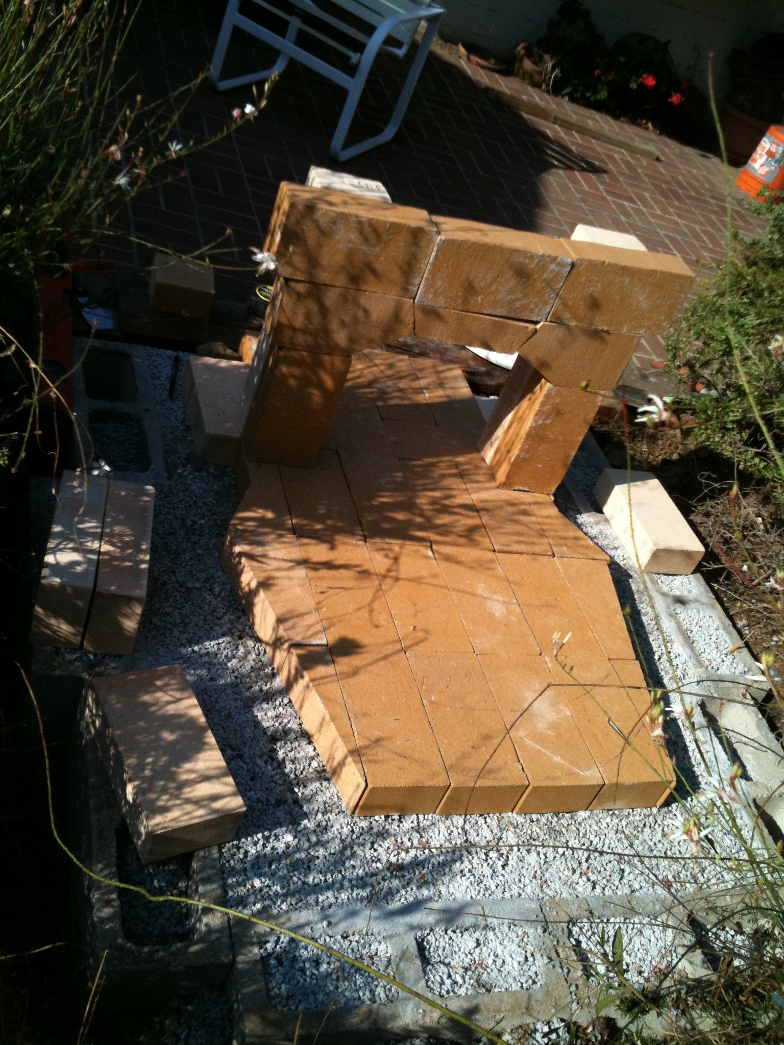

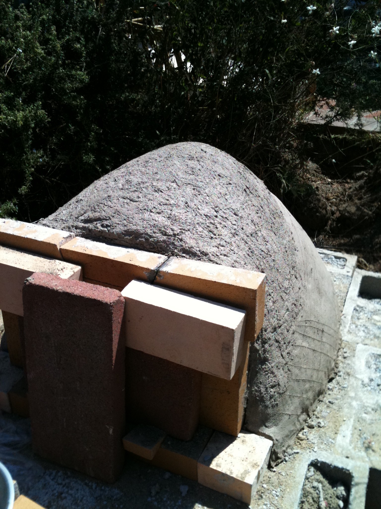

    Here's some photos from my previous build. I built it into a low planter, which I love. I can sit with people, eat and cook all at the same time. Works great for my life. Only problem in the original build was that the dome sank a little, so I had to lose the nice arch for the door I built. And this time, I want to add a chimney and push the oven lip closer to the edge of the planet area.

    Just another pick up from your build, an 8:1 perlcrete insulating slab has generally been found to have insufficient strength to support a heavy oven. A 5:1 mix is better although has a reduced insulation capacity. The insulating mix over the dome however, as it is not supporting the weight of the oven, is better to be much leaner to maximise the insulation value. I find a 10:1 mix is about as lean as I can go and still have the mix reasonably workable as well as having sufficient strength. It produces a mix that is firm enough to apply a cement render onto.
