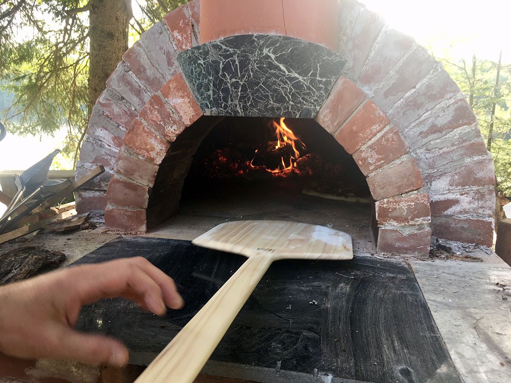

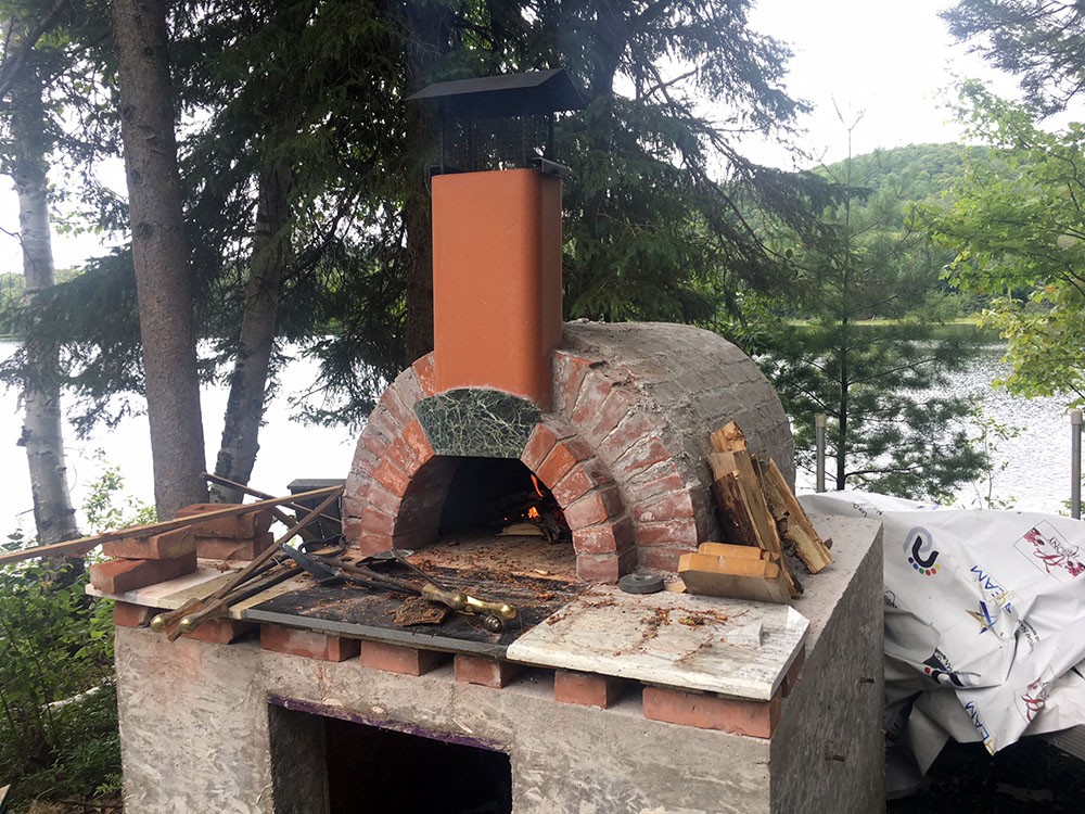

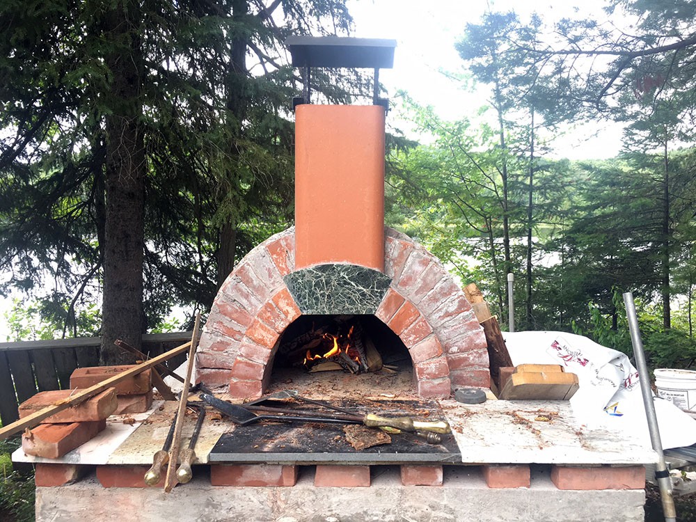

    Here are a few pics of one I built before for my father in law. It's not perfect but it made some nice pizza and bread. Mostly used clay brick and scrap marble... not quite finished here. I wish I had the space at my house and could afford the materials to do something like this again.... or even a brick dome... but it's not possible for me.

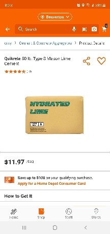

                          Ps. This is what I used for lime from home cheap-o. Found in the masonry section by the sand and cement... Click image for larger version
