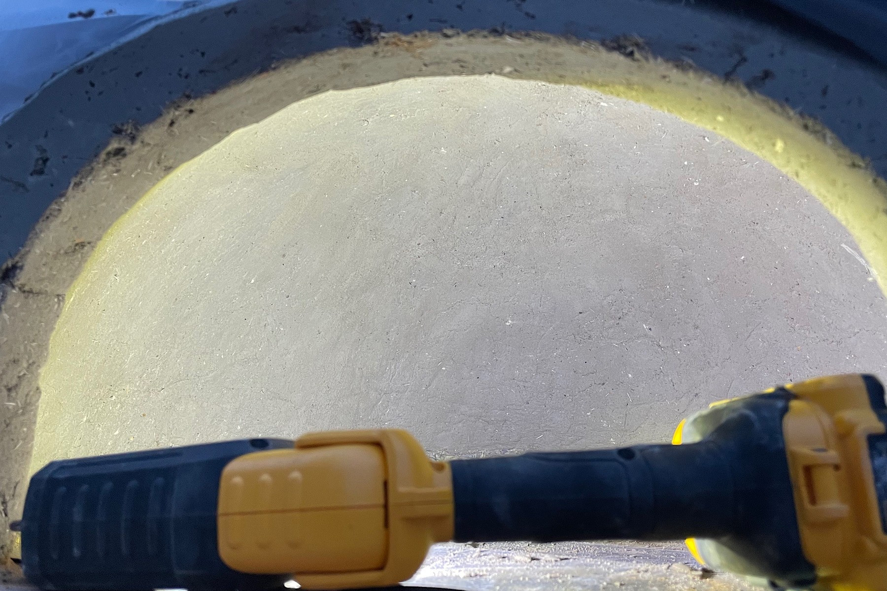

    I checked on the oven this evening, glad I did as it was ready to remove the form and sand but still green enough to blend in the worst of the voids/ripples.

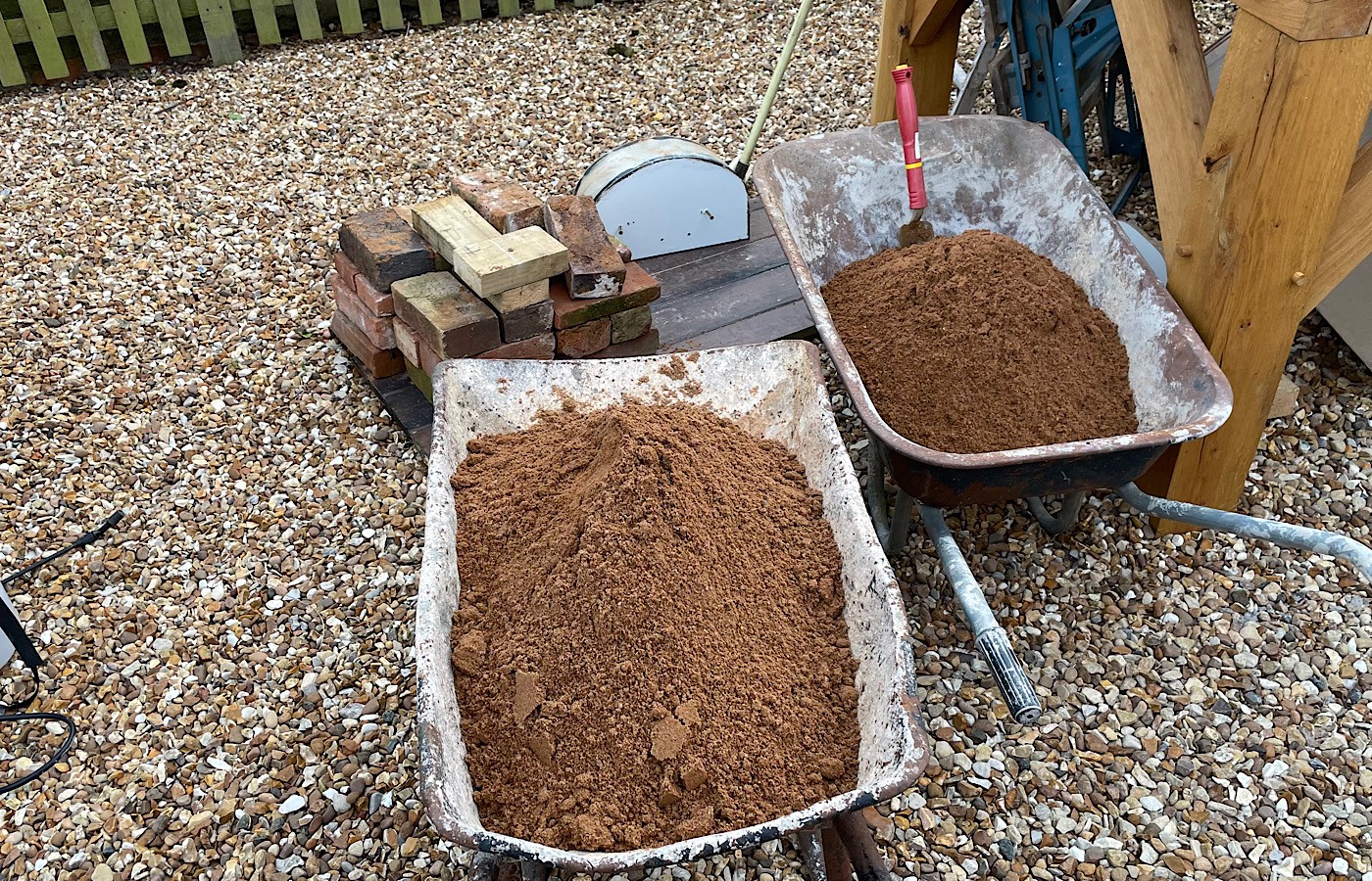

    I had not realised quite how much sand and bricks it took to build the sandcastle. I used a 800mm circle of DPM to mark out the base when I built the sand castle, this worked really well to keep the base clean and dry.
    There were a few ripples in the casting where it slumped, and voids where it did not quite mould together, a little fresh mix seemed to blend in quite nicely to smooth these out, hopefully once set it will hold.

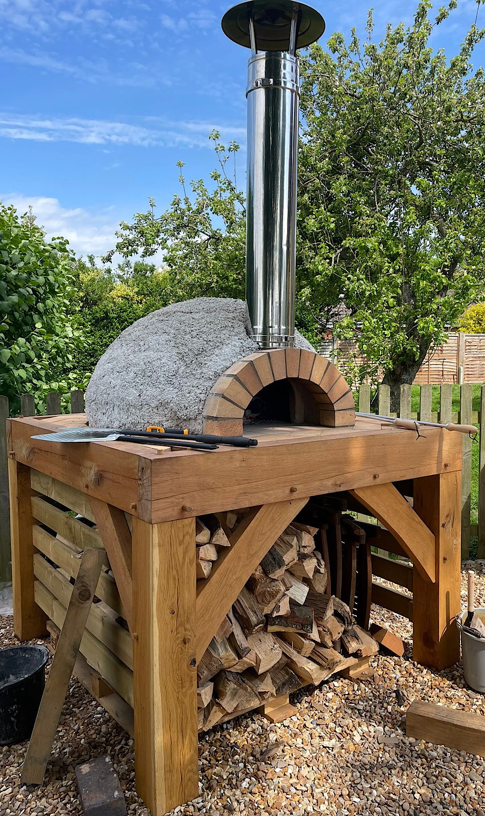

              A bit more progress over the last week, I built the arch, and cast the gallery behind.
              I tied the arch to the gallery with a few bits of wire between the mortar gaps. I made the arch top slightly lower the the dome entrance and with a decent depth to the gallery hopefully it should collect the smoke nicely. I also kept the contact point between the gallery and dome to a minimum to slow down heat transfer.
              I also got the dome covered in a couple of layers of 25mm ceramic blanket, with a third over the top made of the scraps left over from cutting it to shape.

                It’s looking very good. Usually the flue gallery is made a little higher and wider which leaves a rebate so a door can be placed against the oven mouth. Making it lower than the oven mouth might make fitting and sealing a door difficult.

                  It has been a while since my last update but my oven is finally getting there, we had our first pizzas over the weekend and they were fantastic! I had expected the first to be a burned mess and to for it take a bit of practice before getting any good at cooking pizza, but not at all.
                  The oven still needs a coat of render, and possibly a roof; I cant see it still looking good and not getting quite damp inside the after a UK winter without some sort of protection.

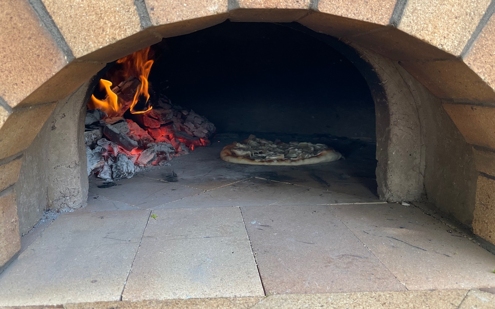

                    Looking good!
                    Personally I think 80cm internal diameter is the sweet spot, I chose 70cm and while the floor space is large enough to cook what I want, I could have done with just a little extra space between the fire and pizza.
                    at 380 - 400°C and so close to the fire, I have to be watchfull and rotate the pizza quickly to not let it burn on the fire side.
                    It has happened once that the fire tumbled down and on my pizza as well
                    Being so small the oven is at pizza temp in under 1 hour, big advantage imo. I can imagine yours will not take much longer.
