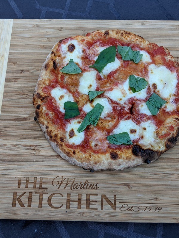

              Finally cooked our first pizza yesterday!!
              It's been a long journey, but so worth it. I never would've attempted anything like this without this great forum. Started digging the dirt for the foundation the day before Easter, 2022 and had our first meal Mother's Day, 2023.
              We ended up making 5 pizzas last night: The first was, of course a margherita. 2: pepperoni. 3: pesto. 4: prosciutto with balsamic/fig drizzle and mixed greens. 5: dessert pizza with just butter and lots of cinnamon sugar.
              Once I finish a couple of small, finishing items, It'll be DONE and I'll post the pics!
              Joe

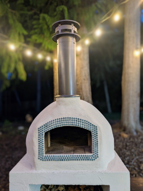

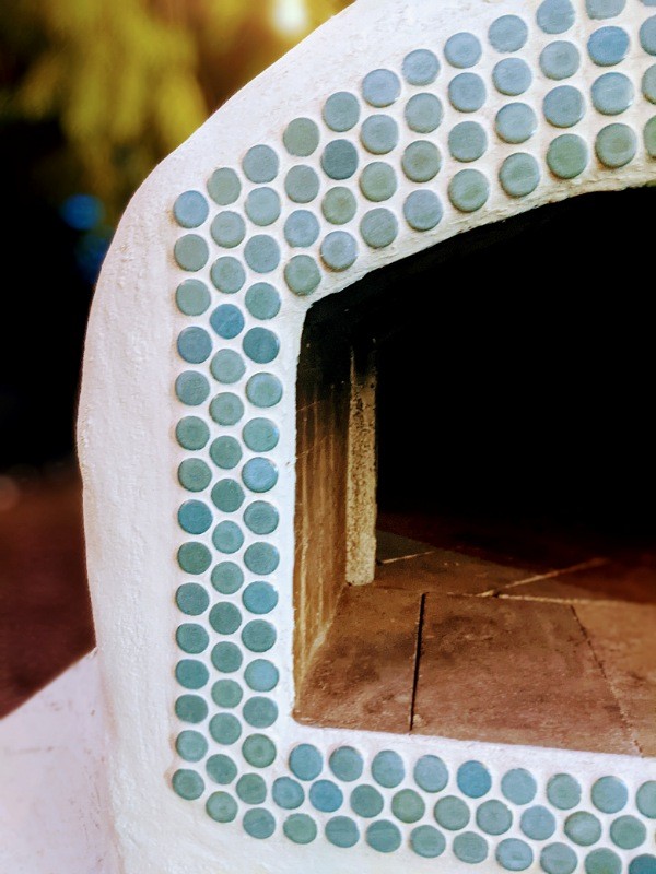

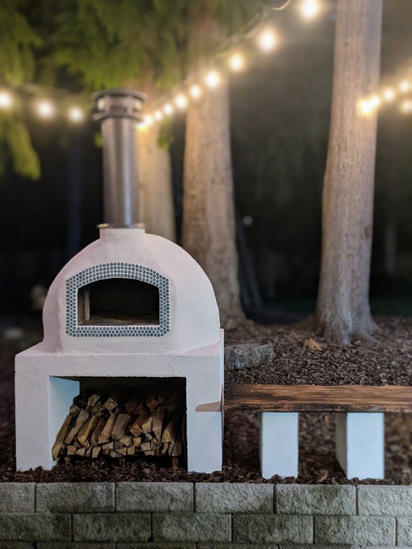

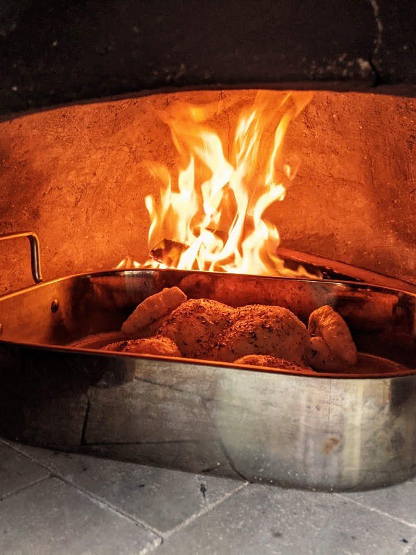

                  Oven is done! Well technically, I still need to finish my door, but other than that, it's done.
                  So far, its working great. Did a spatchcock chicken last night, then cranked up the heat and did a couple of New York's in the cast iron, finished with a peppercorn sauce. A few hours later, made a couple pizzas for the neighbor kids... It's going to be a fun summer!
