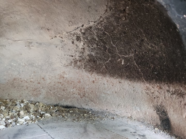

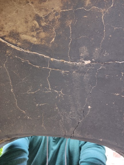

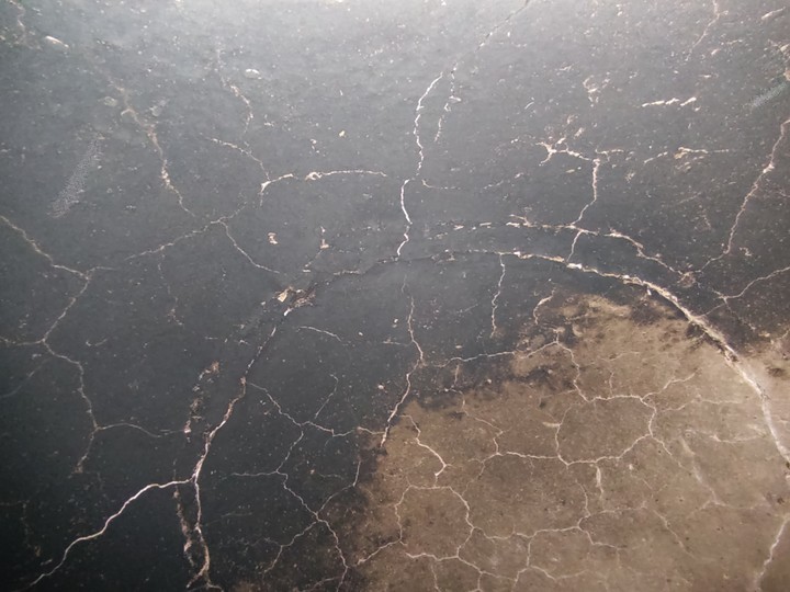

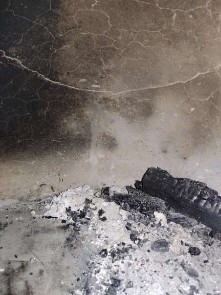

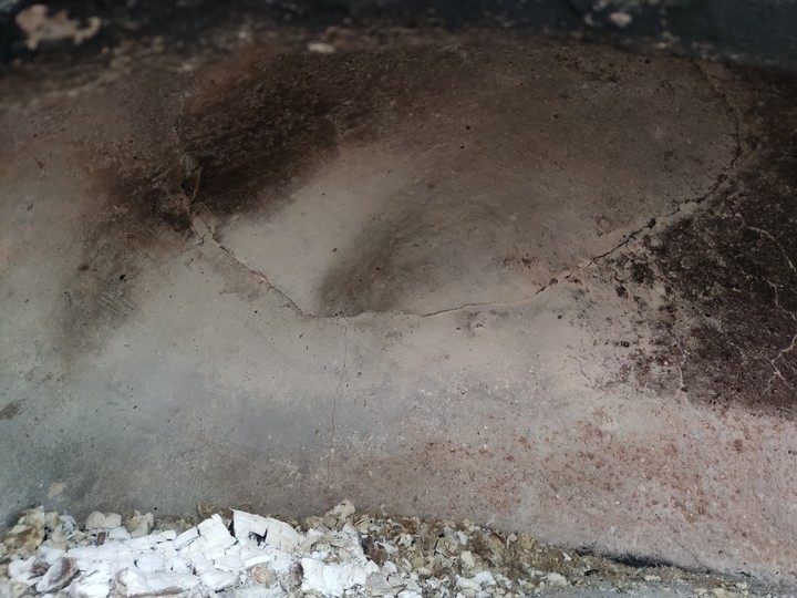

      Hi, I think the experiment worked out pretty well. I do have some cracks propagating up from the floor of the oven but they only get as far as the weak joint rather than propagating a full 180 deg across the dome. I have attached some photos from the two ovens that hopefully illustrate what I mean. Given that it's easy to add the weak joint I think it's worth the effort and it certainly has not adversely impacted the integrity of the dome.

        That's most intersting. I made exactly the same obsevation in my one piece dome casting that's now 16 years old and fires as good as new. A very fine hairline crack running all the way around. I thought if that's where you want to be that's where I'll engineer my join for a three sectioned cast build in future. With heat rising by convection a faily large section is going to get way hotter and faster than any other oven part and the resulting thermal expansion problems can be releved at this very position.
