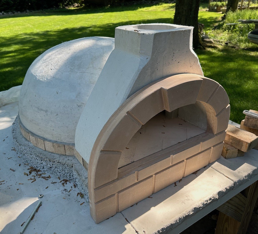

    Greetings geoff7877 I’m currently in the middle of my cast build having completed the base insulation, firebrick floor, dome and flue gallery. I’ve spent a considerable amount of time scouring this forum for best practices and ideas. Not sure how up to speed you are on the castable recipe but it’s now 3:1:1:0.5 (Sand, Portland, lime, clay) along with polypropylene fibers to help prevent spalling, alkaline resistant fibers for strength as well as SS needles to also increase structural integrity and prevent cracking. These additional fibers are considered essential but do increase costs somewhat. For my build I decided to use only the poly and AR fibers, not the SS needles.
    As far as the build in multiple pieces, I think you’re going to find that in order to accomplish what you intend that you’d have to build a mold. It’s been done, but for a one-off it would really be time consuming and expensive. If your primary concern is manageable pieces for transport that approach would make sense. If it’s to minimize cracking, I believe there are other factors to consider. Castables crack, it appears to be a common issue, but the extent of the cracking and how it affects oven performance seem insignificant for most. While I can’t speak to my experience yet, I am taking the time for my casting to dry out as much as possible. I’ve also incorporated a recent idea to try and control where the oven cracks by incorporating a break in the cast by using newspaper. The idea comes from this bamforp thread https://community.fornobravo.com/for...562#post447562 Post #19.
    I can’t speak to the use of bricks for the flue gallery but I believe there are examples of this. I recall a hybrid with brick sides and a cast flue section. I cast mine using 1” rigid insulation to create a mold. The use of this material really opened up possibilities because it’s easy to cut and shape, helps you visualize the final piece and is relatively cheap ($25 for 4x8 sheet.
    Hope this helps. Happy to share what I know even though I’m certainly no expert. Attached is a picture of where I’m currently at in the process.

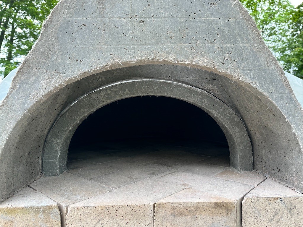

                I also cast my gallery to minimize the opening depth. Using foam molds for the oven mouth and flue gallery helped make this possible and more precise. The gallery sits over the oven mouth by an inch. I left a small gap to isolate the dome itself and to provide an escape for any pressure build up. I also plan on incorporating a small vent at the top of the dome insulation as an outlet for steam to escape.
