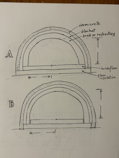

    My question is around where the dome should be placed onto. Is it best for the base to be placed onto the firebrick base (stopping me from being able to replace the covered bricks), perlicrete base or an added outer layer of something entirely different?

      As the drawing indicates there are pros and cons for either A or B. Dome on top of floor means the bricks uat the floor perimeter nder the dome will be almost impossible to remove if replacement is required. But it's the centre floor bricks that take a beating so the outer ones never need removing. I've never seen the outer bricks with any problems.
      cutting bricks to sit inside the dome is pretty difficult and time consuming. Some folks believe that a slight gap between the dome and floor allows expansion movement of the floor bricks better, but as the floor and dome are heating and expanding at pretty much the same rate I don't believe it's an advantage. If the floor bricks are laid loose the gaps between them are sufficient to allow for free expansion.

        Thanks for the explanation on that, I think I will lay the dome over the bricks in that case, as it seems much easier and if there is no great issue of differing rates of expansion then I see no real drawbacks.
