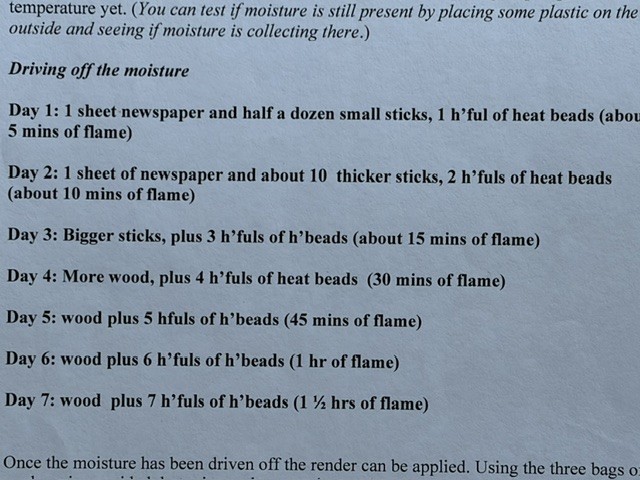

                Attached is the drying fires schedule I use that might help you, but bear in mind that this schedule is for a cast oven that has wall that are half the thickness to that of a brick oven which will take longer to purge itself of moisture. In Australia "heat beads are BBQ fuel and are mini briquettes about 50g each which produce a glowing heat rather than a lot of flame impingement. It is important to allow the oven to return to a more ambient temperature so the temperature evens out, then you can start again.
