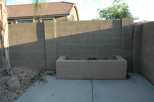

    Started my build in earnest this weekend. This corner of the yard had a patio and built-in block box used as a planter.
    Our outdoor kitchen will consist of a woodburning grill made in the center of the old planter. The oven will sit in the corner to the right, with an ?L? shape counter/workspace extending along the wall (towards the camera). We are building a fireplace to the left of the grill, which will be built to mimic the style and shape of the oven. The blocks that make up the planter will serve as portions of the stand for both the oven and the fireplace.
    Early last week, I cleaned out the bushes from the planter, and shoveled out most of the dirt. I dry stacked the blocks, including a few courses inside the planter; as the oven overlaps a chunk of the old planter.

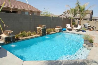

      The plan is for the fireplace and oven to be the same (or very close) height, with the fireplace looking like a slightly scaled down version of the oven. Right now, we are planning some form of igloo enclosure; and we hope to capture a little of that Arizona Adobe look to them.
      The pool has three wok pots built up on columns finished with stone veneer. I want to find something that matches to use on the base of the entire build. Hopefully that will tie it all together.

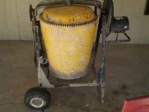

            Made some progress last weekend; I installed the forms for the two hearths. Now all I need to do is cut the concrete board to fit and cut the rebar.
            I hope to have the concrete poured this weekend. And that little step just got a little easier with today's Craigslist purchase.
            Actually, it's a pretty funny sight, the mixer is half sticking out the back of my VW Beetle out in the parking lot here at work.
            Toby
            • charger10s
              • Apr 2009
              • 78
              Re: My "Earthy" Outdoor Kitchen Build
              Made some progress, the hearth for the WFO and the fireplace have been poured!
              I used my "craigslist" cement mixer for the first time, and I learned a valuable lessons.
              - Don't stand in front of the mixer "mouth" when you first plug it in! I dumped a few bags in, with some water to minimize the dust cloud. It's my first time right, so I wanted to see how the whole thing runs, you know. Well, when it makes the first couple of revolutions, it has a tendency to splatter. Well, at least I kept the splatter off the patio floor.
