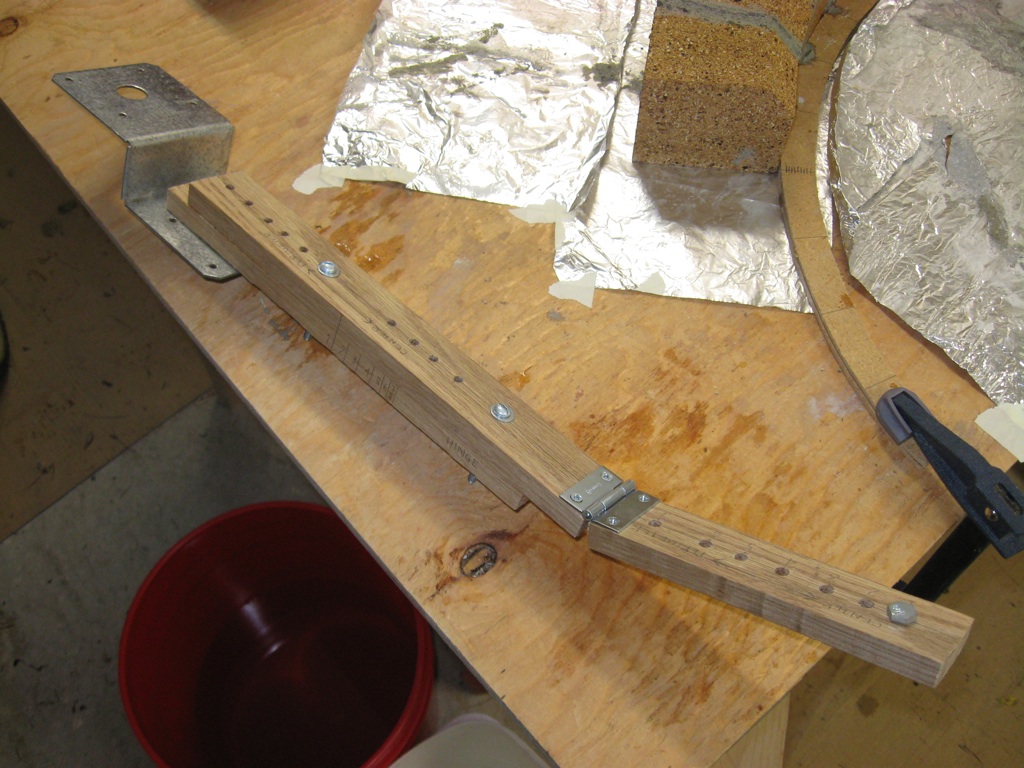

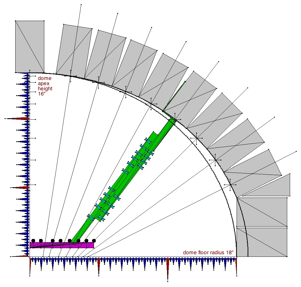

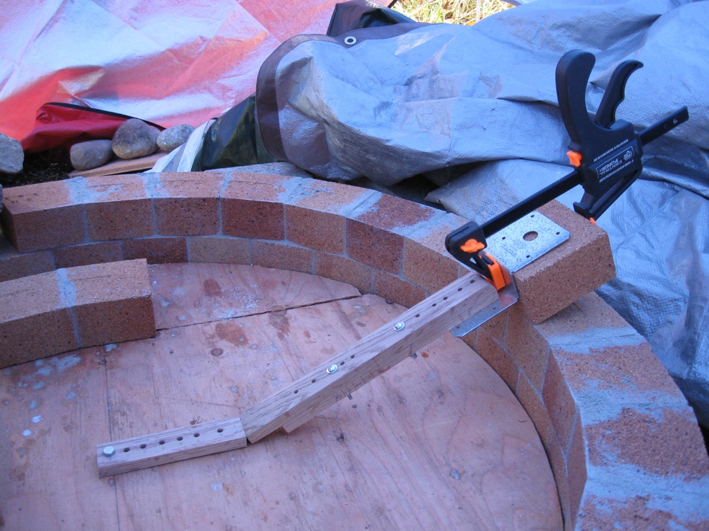

            My brick placement tool is adjustable on two axes (floor arm and radial arm) to achieve any curvature with perfect brick alignment. The floor arm slides inward "across" the center of the floor such that the hinge moves toward the center of the floor, one notch (as shown) per brick level. Meanwhile, the radial arm gets steadily longer per brick level. I specified the notch locations to 1/16" accuracy although that is a matter of taste. Less precision would be fine. Here's a schematic (for my particular oven) and a few photos:

              The results would pretty much be the same whether you use kebwi's method of readjusting the tool for every course or manually aligning (visually and/or by feel) the bricks as Paul and I did.
              BTW, that's a pretty clever design of the tool Keith. I saw that during your dome construction.

                Re: Adjustable indispensable tool ellipse dome
                Agreed. I'm just explaining my process. I'm certainly no advocating it. The payoff for such absurdity is probably nil...at best.
                BTW, for all the precision I put into my oven, it has produced numerous cracks. I even have a wobbily keystone in one of my arches. Really makes me question the benefit of designing and shaping the oven and bricks so meticulously. What's the point if the mortar all cracks out and the oven ends up standing under its own compressive strength anyway? Oh well.
