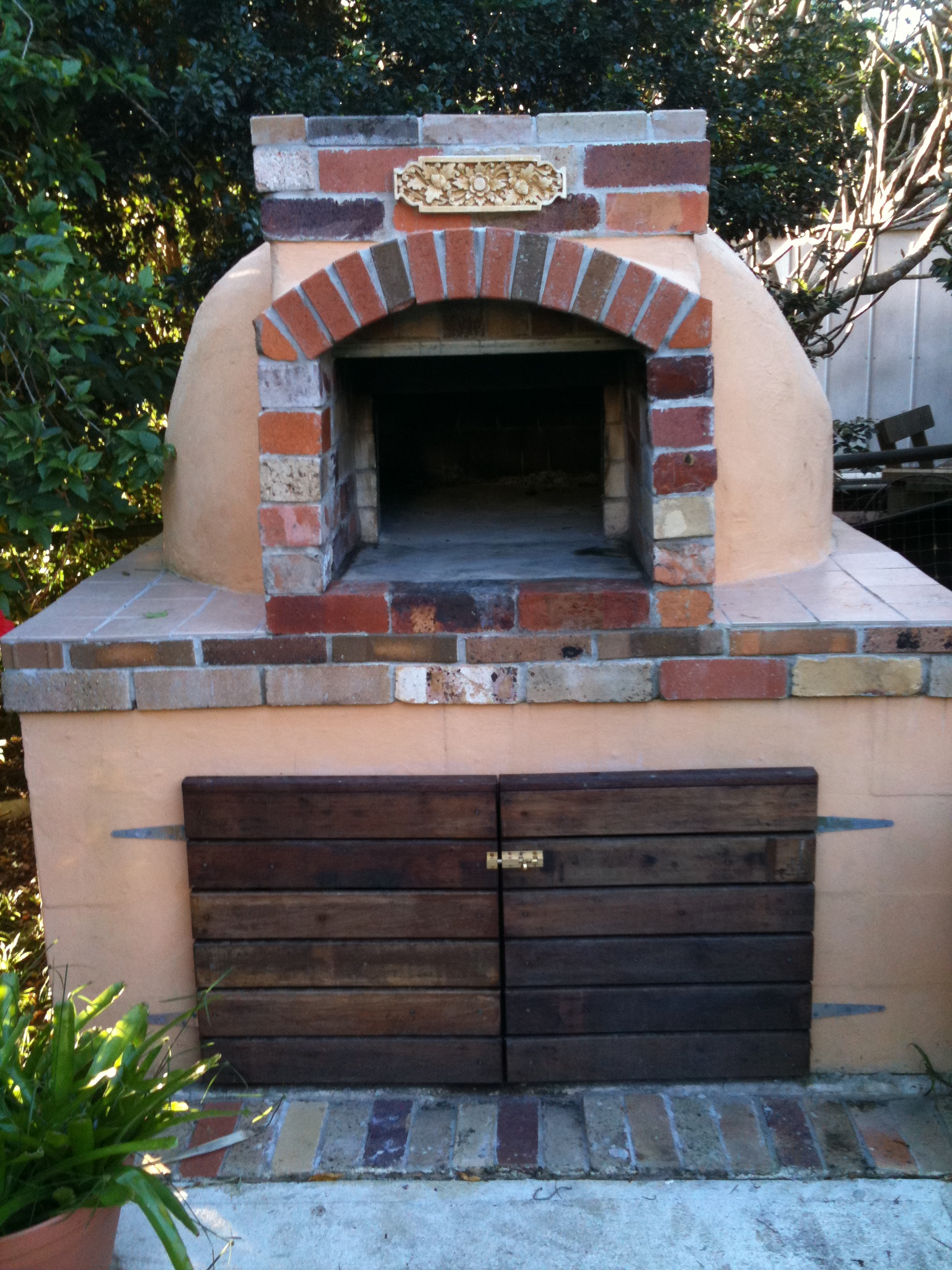

                      With myself....well the oven outwest hasn't happened yet ...just to wet
                      O by the way remember how I got you interested in building the arch for the entrance guess what....
Name:	seal brick.jpg
                      Had problems with the damp and deceided to extent the entrance.... and funny about that the two ovens look pretty similar now...
