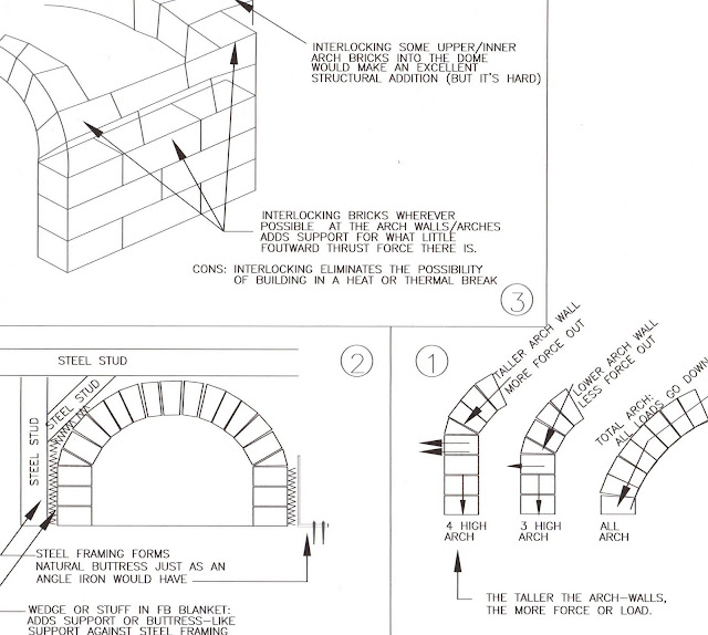

      Hi attaty,
      My answer to your questing would be: yes, definitely a little 'hillbiilly' and no, not too much 'fabrication'.
      Here is a pdf that shows some options. Keep in mind, it's my 1st and last oven and I know nothing about brick structural forces. So here's my humble opinion based on some experience:
      1.) the lower your arch, the more outward force gets directed down. My arch walls were 3 brick high, not 4 so there would be slightly less force (1/4!) out the side walls to worry about. Have you seen kebwi's and a few others wfo that have an almost perfect arch?/no vertical arch walls? No buttressing is needed there.
      2. If you are building an enclosed non-igloo style then do what I did: I used the stud framing around my oven for the cement board that eventually enclosed it. I used that as a buttress and wedged FB insulation blanket tightly between the outer arch and stud. Easier than an angle iron.
      3. IMHO: outward thrust is not an issue for these ovens we build unless the arch walls are very tall, the base is not firm or solid. Also potential weakness: if you don't build a gradual 'flu-box' or vent transition which will A: draw smoke better and B: spread the load/weight of the vent better. Also, as shown in my pdf pic #3, interlocking the side arch bricks into both arches adds a lot of structural strength although it precludes an air-gap or heat-break which most of us don't have (although I greatly admire it in others)
      Still, it's up to you: I fully understand the desire to make this wfo build of yours as strong as possible but I've never seen a 'failure' on the arch-walls yet. If you do install angle brackets make sure you insulate between so the metal doesn't transfer into your ovens concrete base.
      good luck, Dino

          Re: How much arch buttressing?
          John and Dino:
          Thanks for the information. It confirmed what I thought--a true arch will hold weight, but a poorly designed arch will fail (probably at the "fourth brick" in Dino's .pdf). Dino's arch diagram is exactly what I was wanting to see.

            Hi Dino,
            Regarding your diagram above, where does 2 brick high arch fits in? I see only 1, 3 & 4 bricks high analysis of the line of trust. Thanks.
                Volongo,
                1st: thx for the compliment. 2nd: there is no real reason that I did not show a 2 high arch-wall in the example. 2 high would be a fine way to make it. And as David said above, a perfect arch is the strongest. It also looks great, works for pizza but sliding in a wide casserole pan with the 2 big chickens may bump into the arch at the lower sides.
