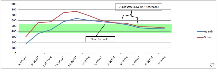

                        Ok I have been off this site and internet for awhile due to hurricanes and snow storms! No power! But we did enjoy some great food during that time with our wfo! It was the only thing that kept my wife sane durin that time! The food list was long so I won't bore you with that, but the best was home made apple pie!
                        Now as to oven performance, without power I finally finished hard wiring the thermocouples to the control box. This allowed me to use my handy dandy wireless remote transmitter to my laptop. Of course I had to hook up a battery back up to the unit during out week long power outage. Here is a chart from yesterday's firing. I started recording after it was up to pizza temp and we were done cooking pizzas. At 9:30 pm I raked the coals over the floor and closed the door for the night. Outside air temp was also recorded to show the differential. I am VERY pleased with this oven's performance! Thanks to Pizza Bob. Dino, and all the other excellant builds on this site for the information and help with my build. I'll keep the recording going until temps get down to 200F. Today will be some bread and dinner. 8:00 am temp is 650 degrees F

                            I am wondering if the coals were still smoldering and giving heat. Here is the latest data which I would have thought the slope would be decling not increasing. btw I haven't opened the door yet. Present temp is 628 degrees F at 11:16 am

                              The coals would tend to flatten the curve, and I do see a bit of an increase in the slope at about 2:30 or so, but you still have 5 degrees per hour. It looks like you'll be about 100 degrees loss in about 18 hours, just off 5 degrees/hr average. The 550 mark starts to open your window to hearth breads. I'm guessing this temp will arive about 6:30pm.

                                Hi Chris,
                                I usually open it up and get the ash out and mop the floor a bit and I am usually ready for bread around 4:00 - 5pm
                                My hearth is usually around 520 and the dome 540 or so when I bake.
                                We'll see what happens.
