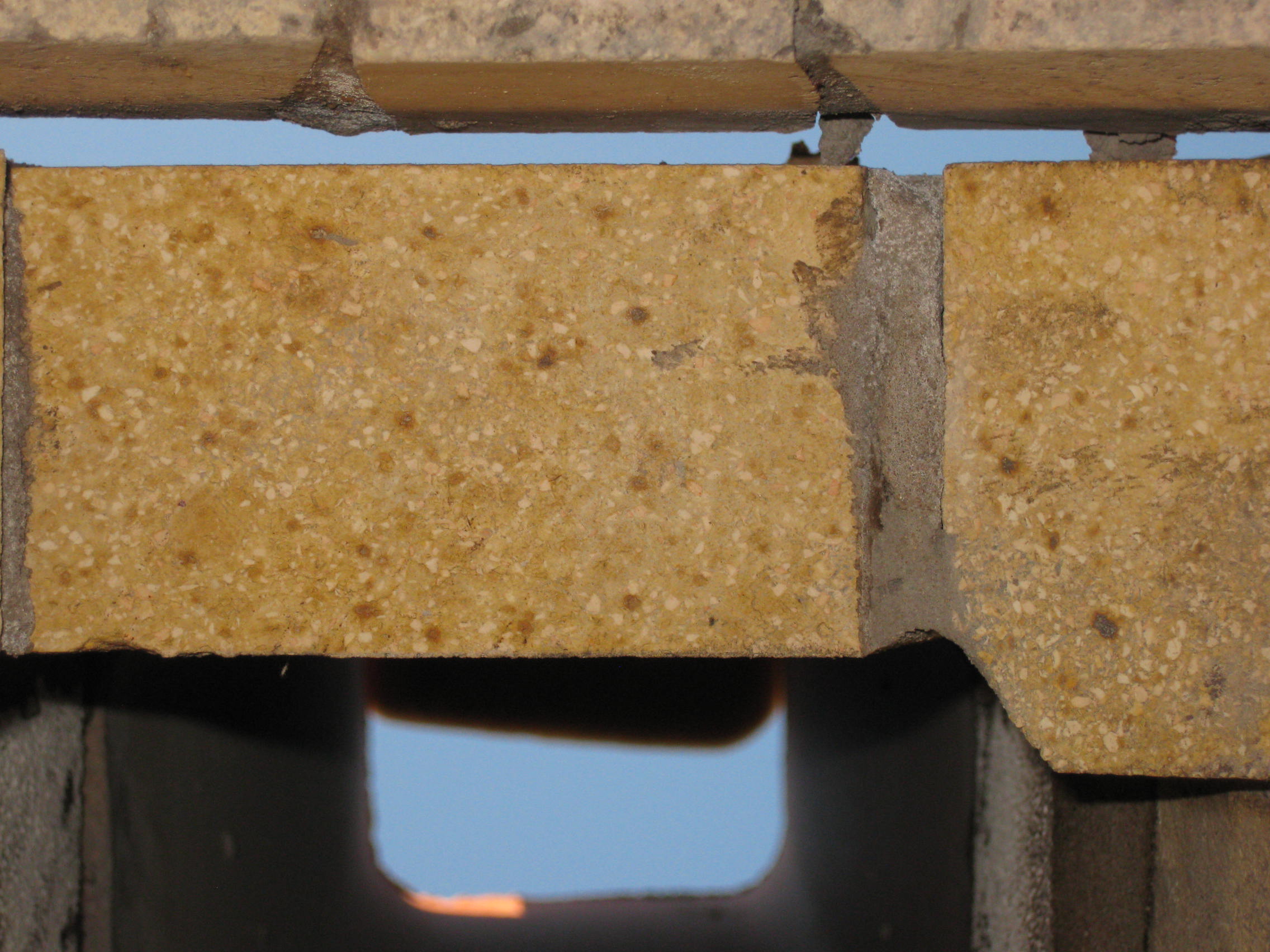

                      My rendition of an Insulated front of oven entry/landing
                      I put an eighth inch air space between the inner arch and the entry arch. You can see the daylight though the flu and the heat brake in this picture...
                      I cut rigid insulation and placed it on the outside radius of the air space, then covered it with vermicrete to seal and insulate. Haven't been over 600 F yet, but there is a large temperature difference between the inner arch and entry arch. For me, it was all to preserve heat for baking.
                      ADDED later: After the sixth day of curing fires my oven dome temp was 830 F, (433 C ), for an hour with a floor temp of 650 F, (343 C ). The top brick of the inner arch was 512 F, (266 C ), and the inner arch of the entry was 392 F, (200 C ). These numbers show the temperature difference between the inner arch and entry arch of 150 F, (66 C). Well worth the extra effort. In a do-over here, I might increase the air space to a quarter or half inch.

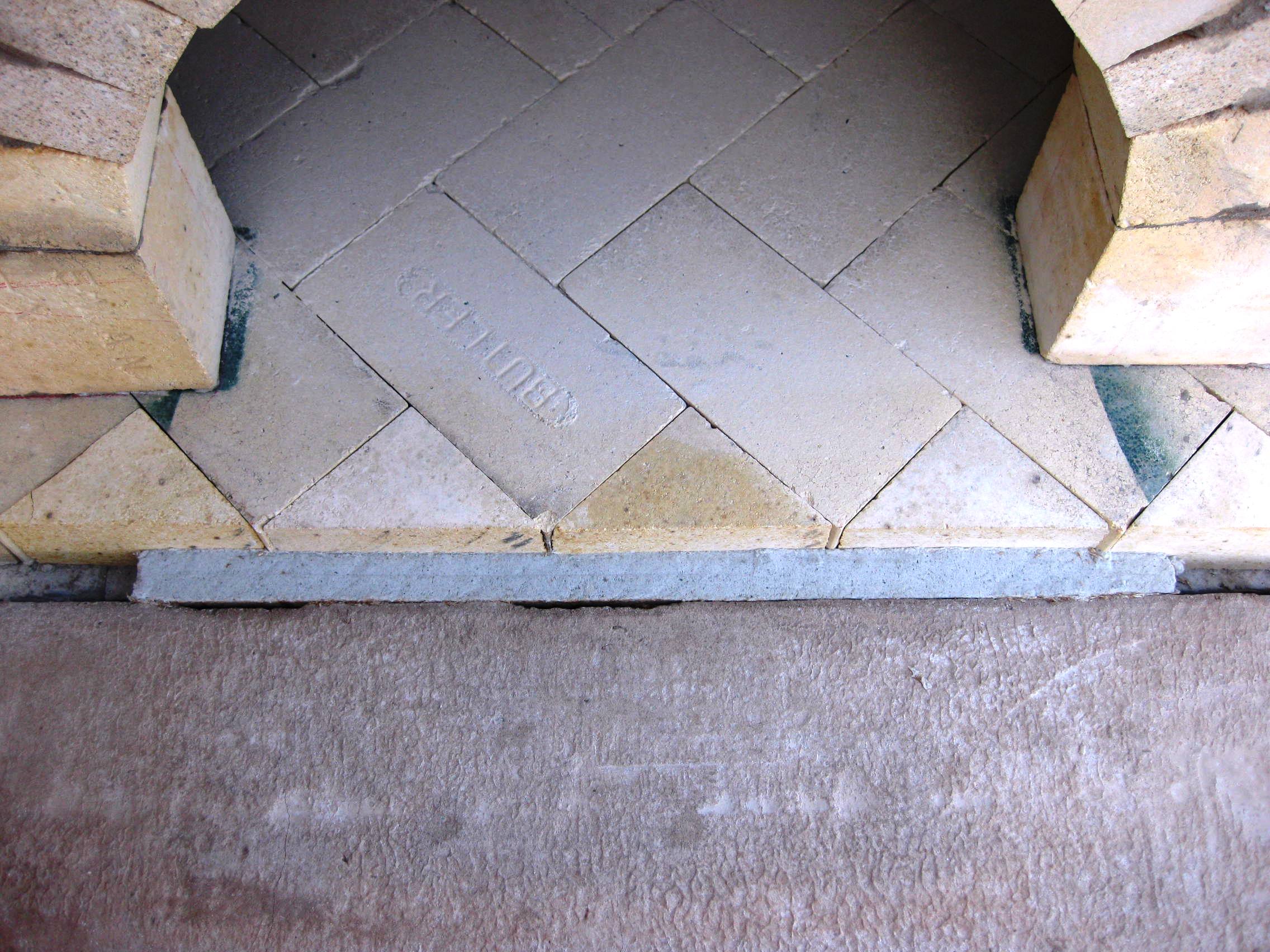

                      I made another air space in the oven floor about 4 inches outside my inner arch.
                      The air space will be between the firebricks and granite portion of the landing.
                      Also used a one inch filler between the oven floor and base for the granite.

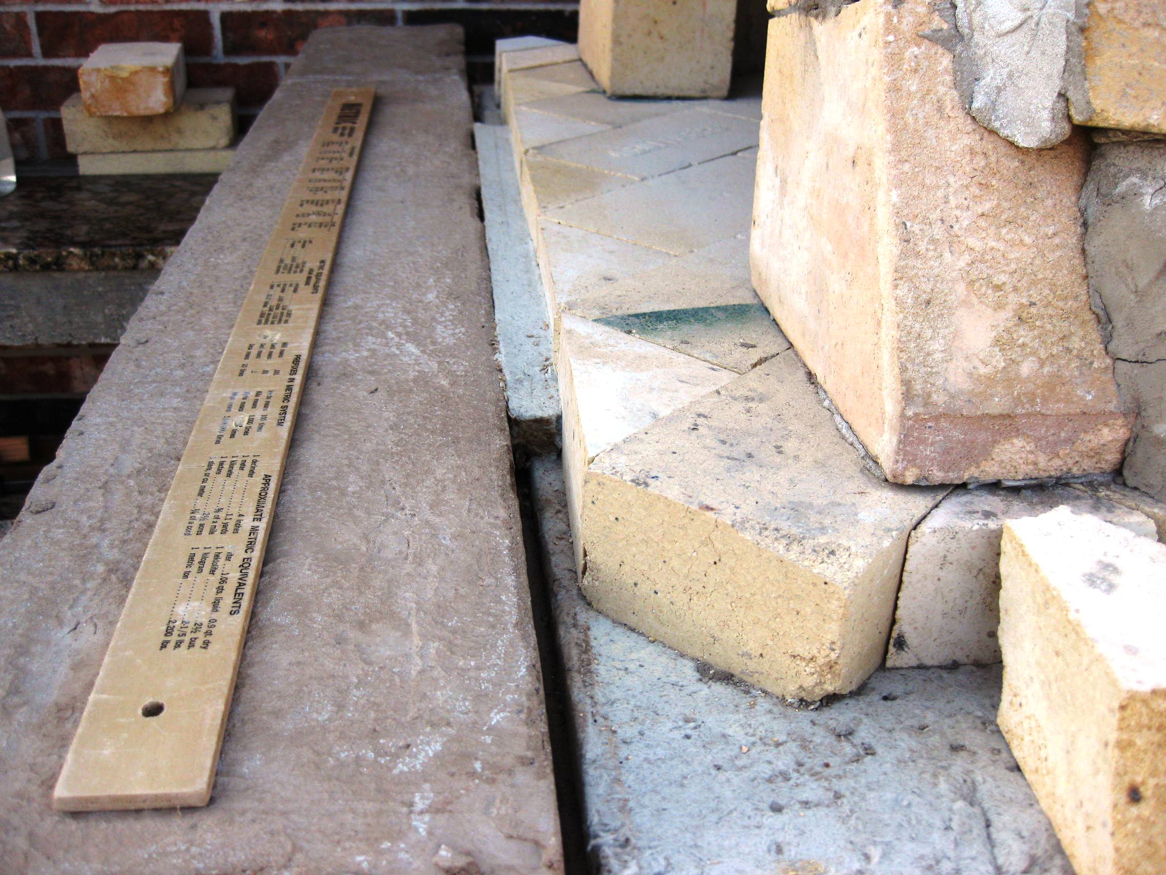

                      The yard stick is where the granite goes.

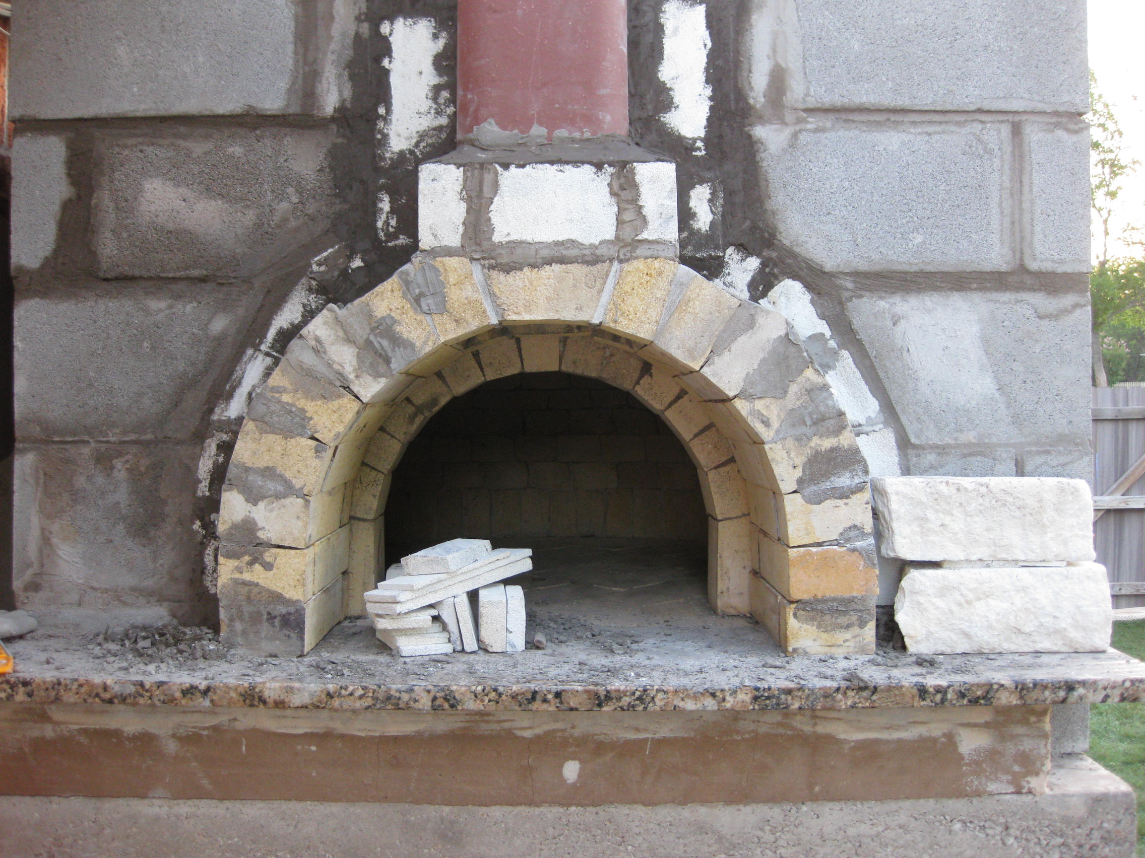

                      This one shows the granite in place, but no entry yet. Designed after Karangi Dude's entry, I made mine a bit wider and a bit shallower than most. You can see the pencil line where I made the entry...
                      Added later: The temperature difference between the oven floor and granite was about 50 F, (10 C ), but I haven't filled that space with ashes yet, it may improve slightly. In any case it will aid the granite in a long and healthy life

                      Not shown is placement of two triangular insulated fire bricks that are now under bases of the entry, providing another degree of insulation.
                      I don't say everyone should do this, but it felt good to me :smiles:
